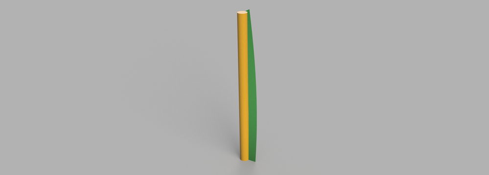

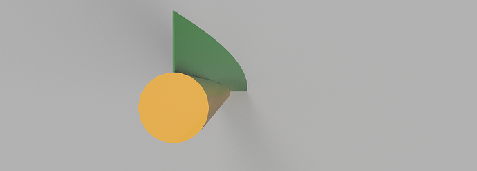

I’m looking to see if any of you Fusion users out there have a good method to come up with a sheet metal flat pattern for twisted shapes.
The method needs to be simple, all steps need to remain inside Fusion, accurate and repeatable.

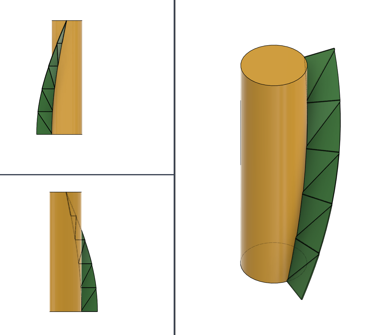

Here’s an example of the shape. Currently I do have a method using triangulation but it’s not the simplest method.

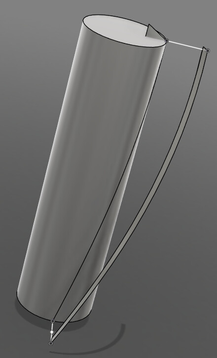

Could you create a set of these twisted vases and then make a surface between the two vases that follows the trace of the coil?
A Better Way to Design Twist Vases in Fusion 360 - Coil and Sweep
In this case .25 rotation but a functioning method be able should able to handle up to 1 rotation.
My above images uses both coil and sweep.
Now how do we affectivity construct a sheet metal flat pattern? Without it breaking.

Tin, I have spent a bit of time and this and as near as I can tell - it cannot be done in fusion alone. Sure you can draw the shape easy enough…BTW I did it with surfaces using the sweep command and then thicken. Very fast and of course the surface tools are parametric so very controlled and repeatable per one of your goals.
Flattening not so much….though in my short time it appears (from multiple sources) that meshmixer does a great job… here is a video https://www.youtube.com/watch?v=dalldQLphyo
It will lengthen the tool chain just a bit, but not too bad and gets the job done. I have read that it is surprisingly accurate too (bit surprised honestly) but I would give it a shot and it may be very accurate consider this will be plasma cut I assume.
BTW I even spent a bit of time using 3d sketching and as long as the lines are straight within 3D space the sheet metal will flatten it. The environment will not flatten the complex curve. Funny enough thought this technique does work as long as it done in the 2d sketch environment like this https://www.reddit.com/r/Fusion360/comments/1bpnqn4/how_to_take_a_curved_surface_and_make_it_flat_is/ This is the trick for that “You can use the sheet metal environment to do this. You’ll have to recreate the curve with a flat section on one end using a flange. Then you can flatten it and use the flattened shape as a profile to project into a new sketch that you can then extrude back in the solid environment.“ Of course that doesn’t solve your geometry. Just thought I would share.

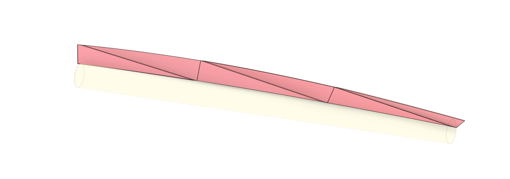

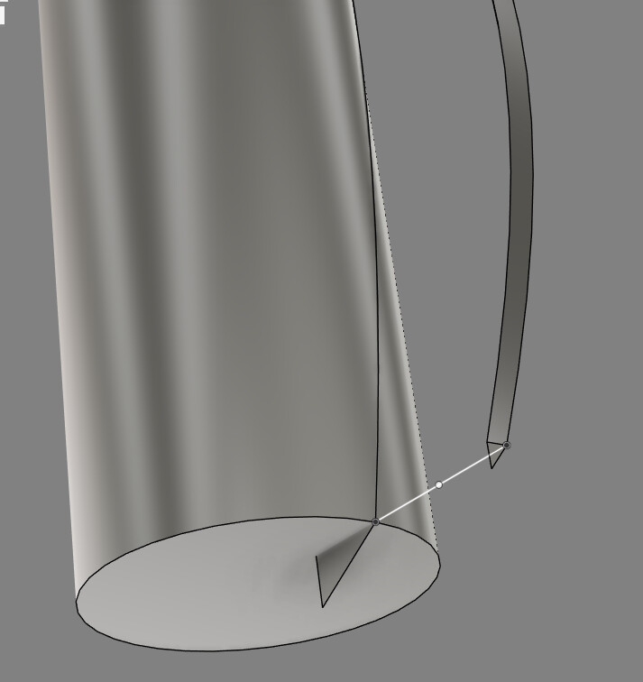

I have a method that works by using triangulation( In a 3d sketch) and then flattening in the sheet metal environment (as shown above )but it’s not a very elegant solution.

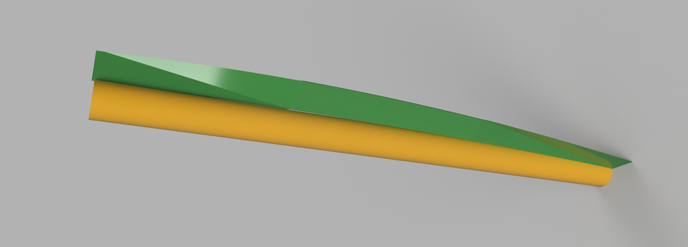

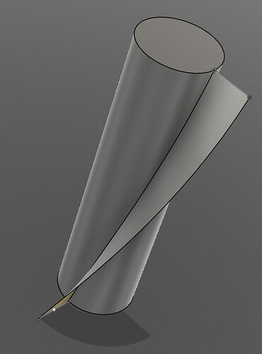

What I did was use a “3D Sketch” to make the inner and out rail of the twist to create a Surface using “Loft”. Once the Surface is created used “Thicken” with the same thickness as the intended sheet metal rule. Once that is done, I “Extrude” the bottom face down 0.01” to give a flat section for Fusion to “Convert to Sheet Metal” and to give it a spot to use to “Unfold”. The extra flat section could probably be 0.001” just to give a flat spot and not affect the part much.
I’m not 100% sure Fusion understands the unfold correctly, would need to cut the part out to test it but this proof of concept seems to work.
Twisted Sheet Metal.f3d (104.3 KB)
Sample Part
Unfolded

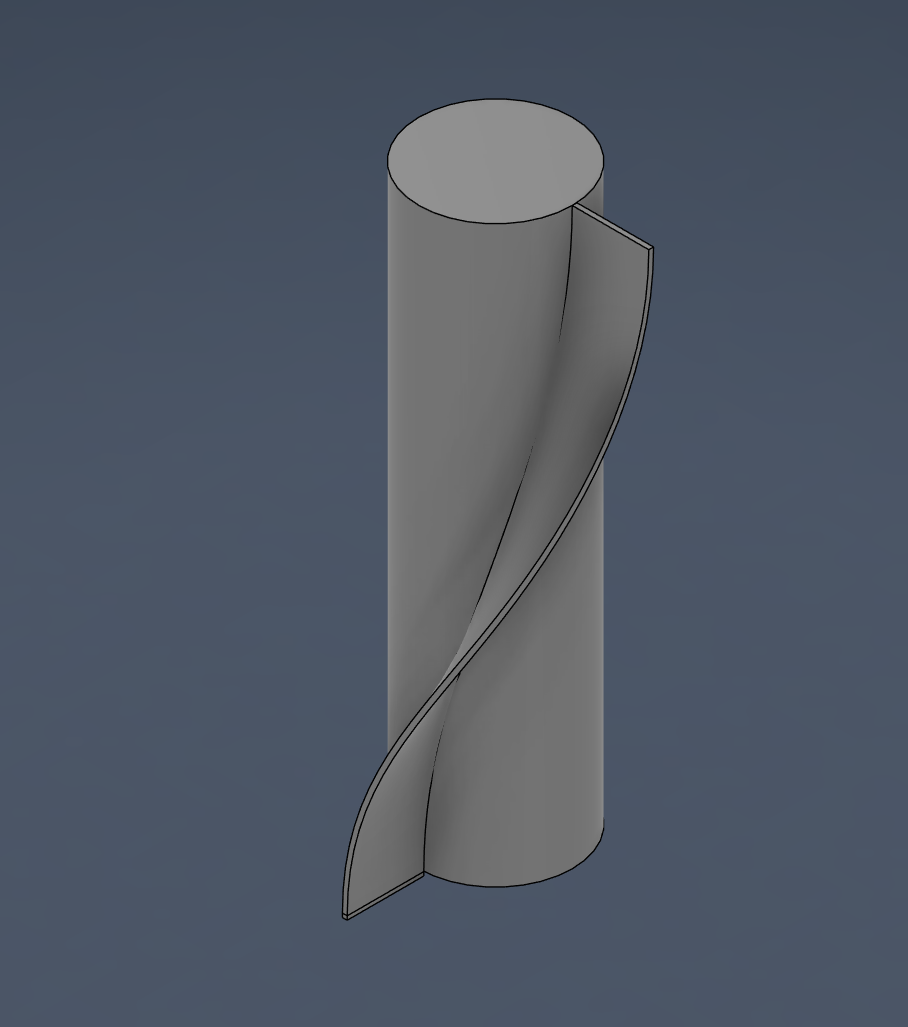

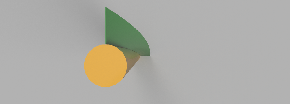

Tin’s Fin.f3d (64.0 KB) Here is the file you asked for.
BTW Welcome Muddr I hope your first post is only the beginning…great stuff.
Couple things I noticed between Muddr and my technique…mine is faster but has some problems, mainly that the ends of the sweep are not in the same plane as the cylinder ends. The sweep obviously makes it normal to that plane of the cylinder end. Better, more cuttable, and truer to the end design IMO.
Secondly, I learned that there is a “convert to sheet metal” command….who knew…I have worked a fair bit in the sheet metal space but always started from a sheet metal “component” then a sketch of the base flange, turn the sketch into flange and build from there. Cool.

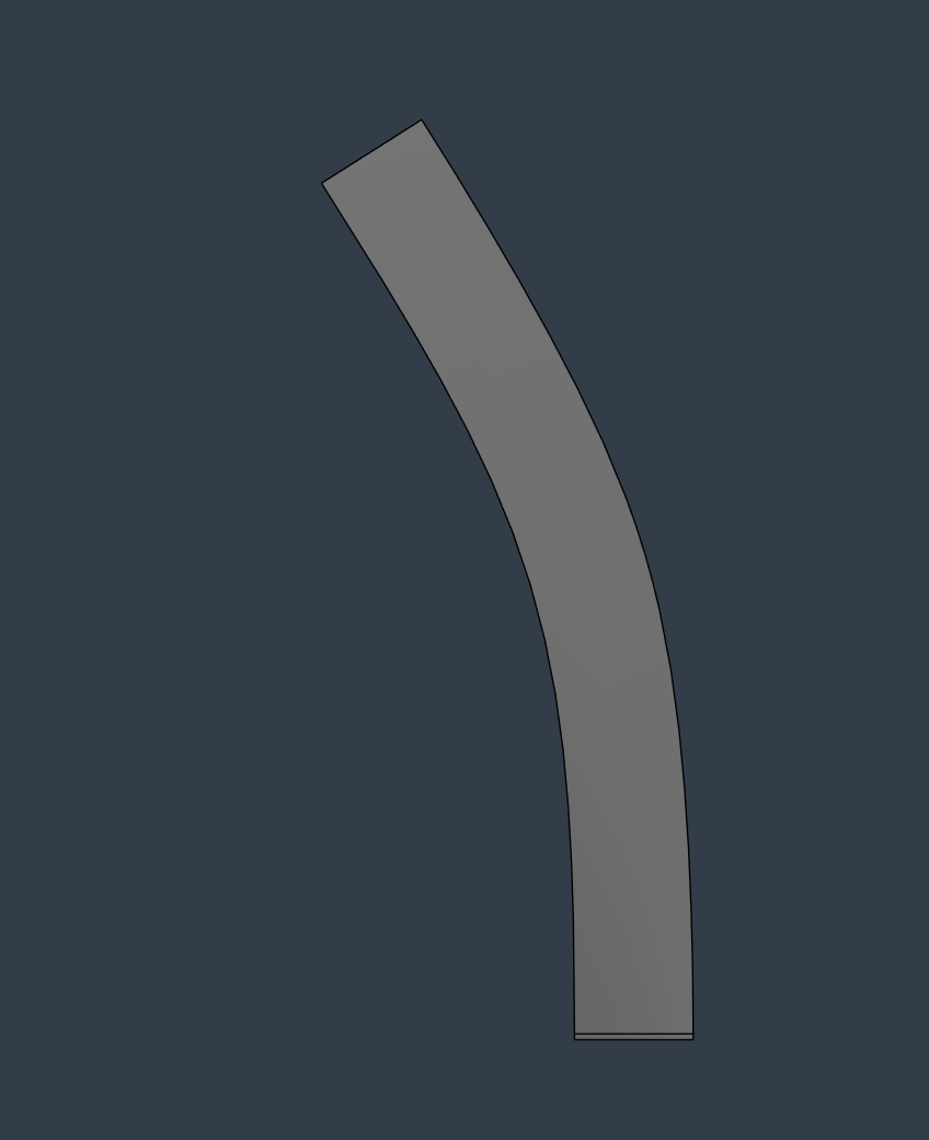

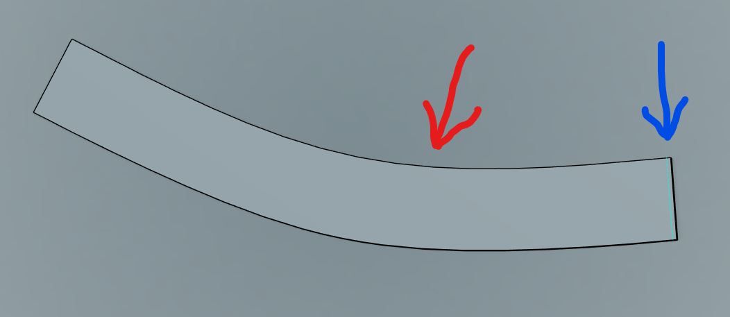

Lastly and I don’t know where this fits Tin’s goals, but there is big differences between flat patterns and unfold(s) the latter Muddr used. I did create a flat pattern out of Muddr’s file so it is available in the machining space.
I do have a question about the unfolded/flat pattern outcome, do you all think it really looks that? In my mind I see the need for added length, to go around the cylinder, but I don’t know for sure whether it needs the arch in it. Thoughts?
The pic is from Muddr’s file but the flat pattern I created in it. The Blue points to the base flange the Red is the arch I ask about.

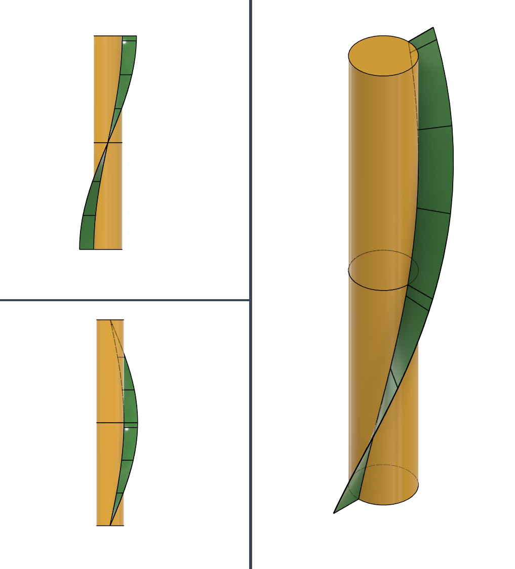

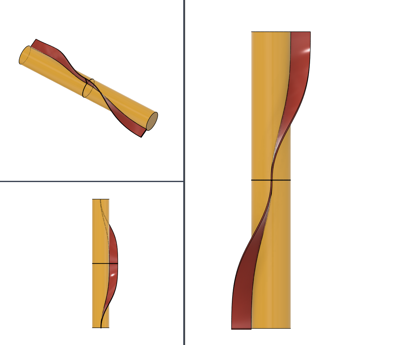

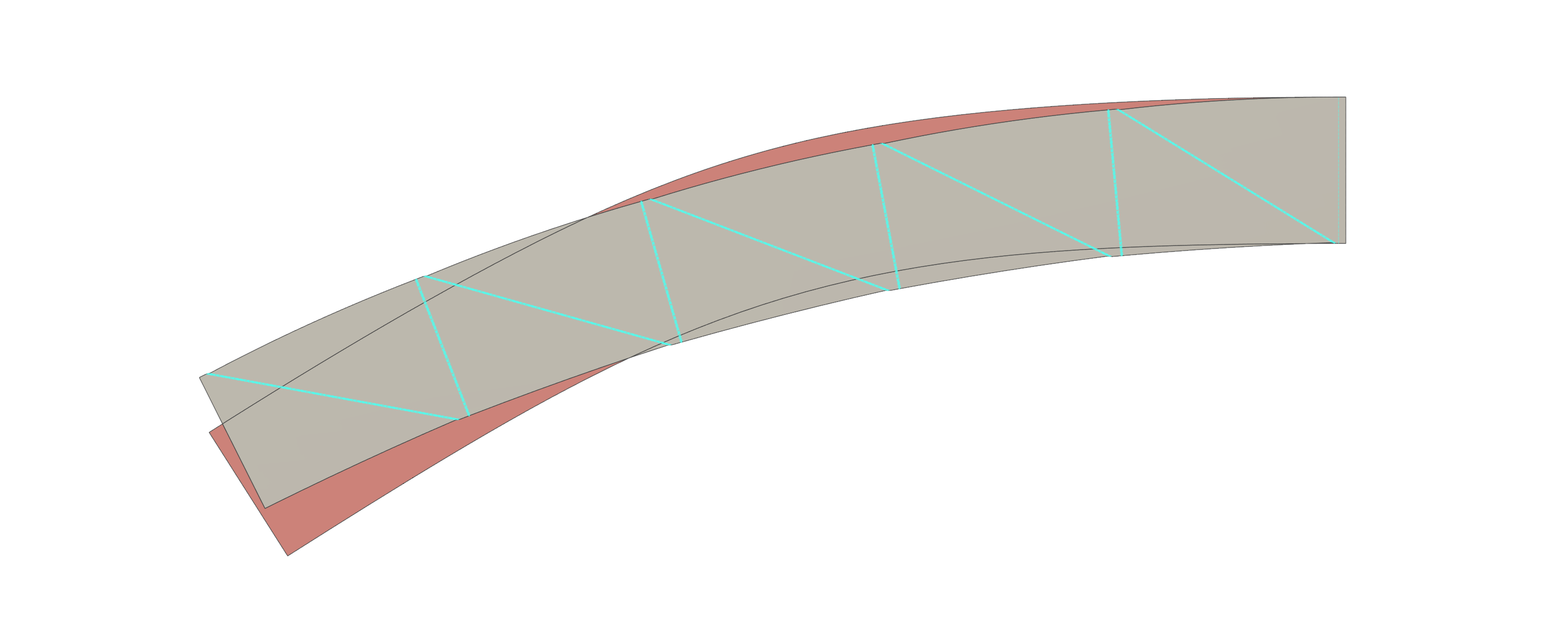

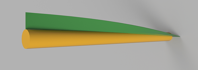

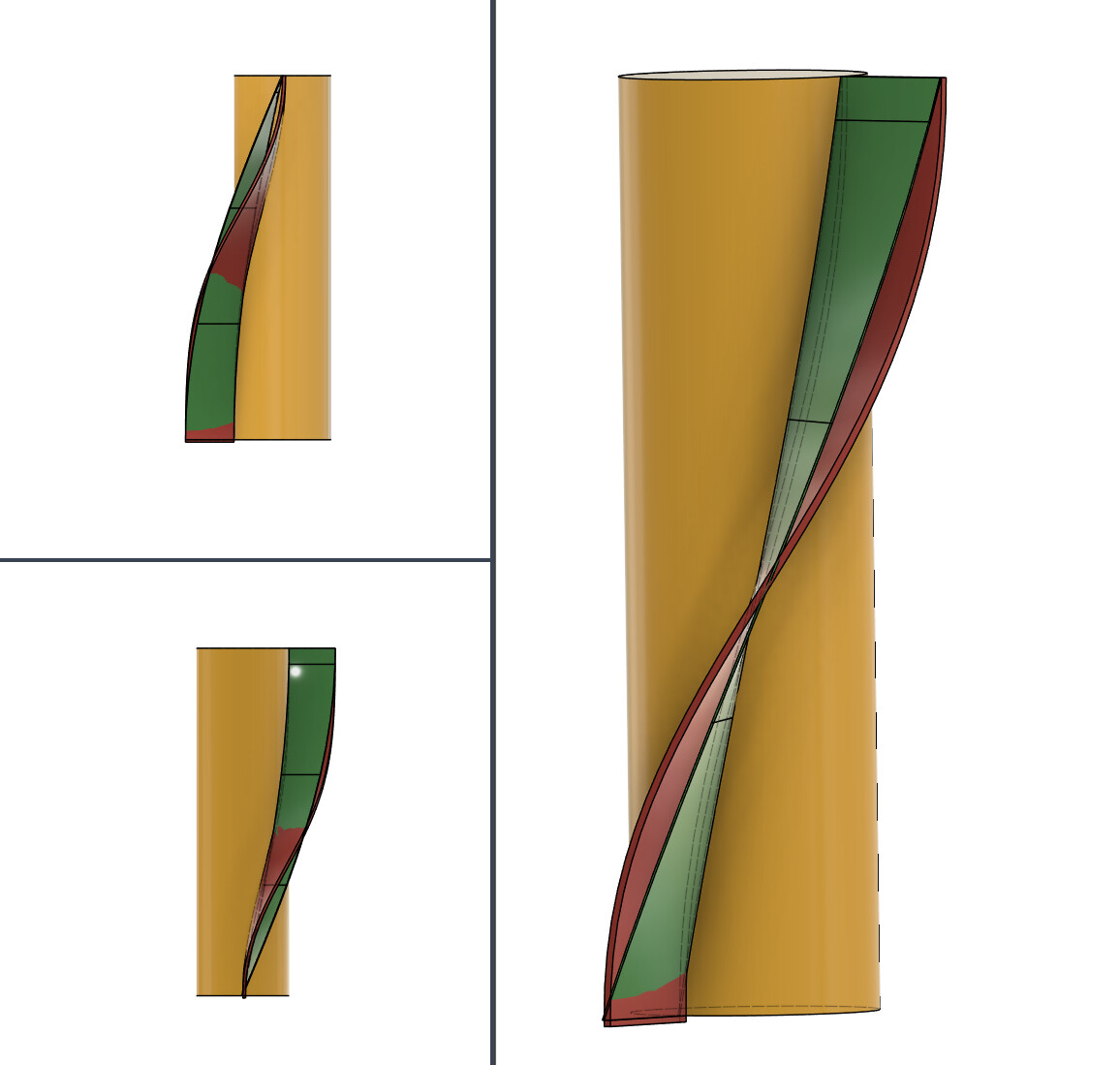

@Muddr thanks again for taking the time to post this. I had some time this morning to start dissecting this. I love the simple workflow. The only problem I have with it is that the shape is not a geometrically correct twist/coil. I’ve stacked two of your examples on top of each other and I think this really highlights the issue with this geometry. I also superimposed a geometrically correct twist/ coil it’s on top of the one you presented.

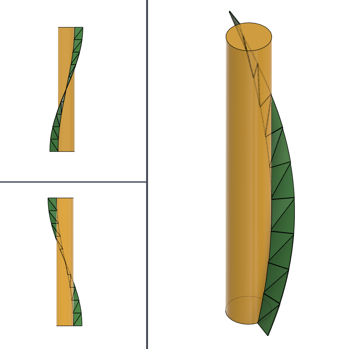

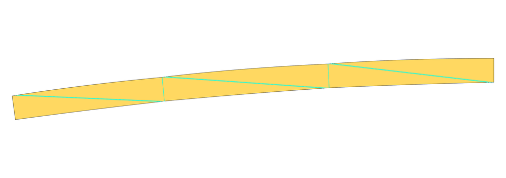

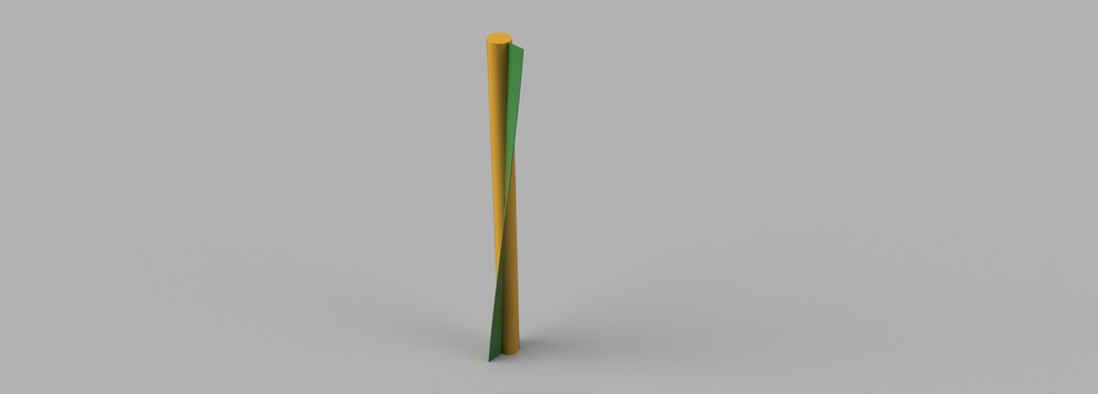

Here’s an example with the methodology I’ve been using which is a form of triangulation.
recreated it with the same height(15”), cylinder size(4’” dia), rotation(.25) and fin length(2”) as @Muddr ‘s example so we can compare results easier.
It’s also the same methodology I posted on the Autodesk forum looking for ideas which has not incredibly fruitful yet.
I did get a couple interesting methods there but they did not conform to my requirements listed above.
Here’s a comparison between @Muddr and m and my flat patterns
Here’s also a picture of 1 stacked on another. This is an important point you should be able to stack as many of these on top of each other without any odd geometry.
tin twist.f3d (547.7 KB)

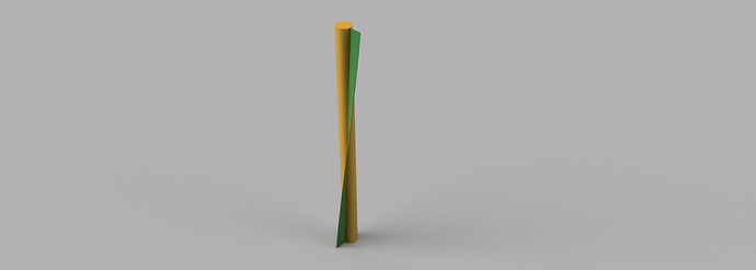

I think we have all figured out how to make a perfect surface.
I used the cylinder as the starting point and backed in off 0.01 inches so my coil set to 4 inches would barely show.
I then added the coil at 8 inches to get 2 inch distance between the edge of the triangular coil. Add a line to connect both coils and the surface creation is easily done.
Here is the surface without the coils:
Twisted Sheet Metal Surface.f3d (99.5 KB)

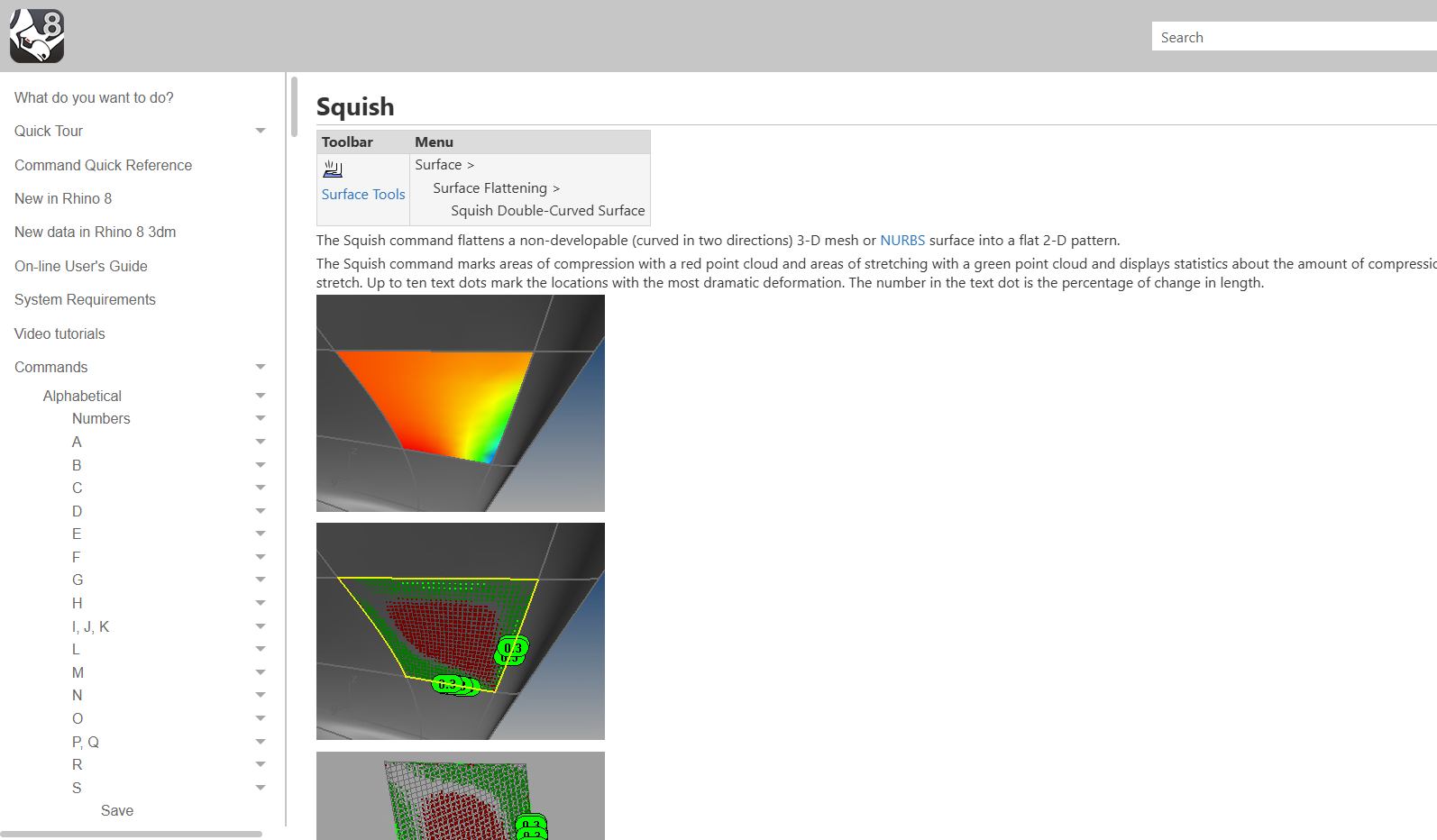

But I can’t flatten it. So my efforts are useless but I did bring one piece of news, perhaps. There is a software that says it can flatten a surface with a squish tool:
The software is free to use for 90 days but I am a slow learning and can’t seem to get a result. Maybe one of you have another idea. Tin, I know your heart is set on staying in the Fusion environment. Perhaps it is possible. Craig (@holla2040 ) probably knows a way but he is keeping it to himself until we are all in tears.:cry:
I have a theory of why Fusion is staying away from the Squish or Smash tools as there is a form of guessing/generalization with the transition. Even the Rhino programs calls it an “approximation.”

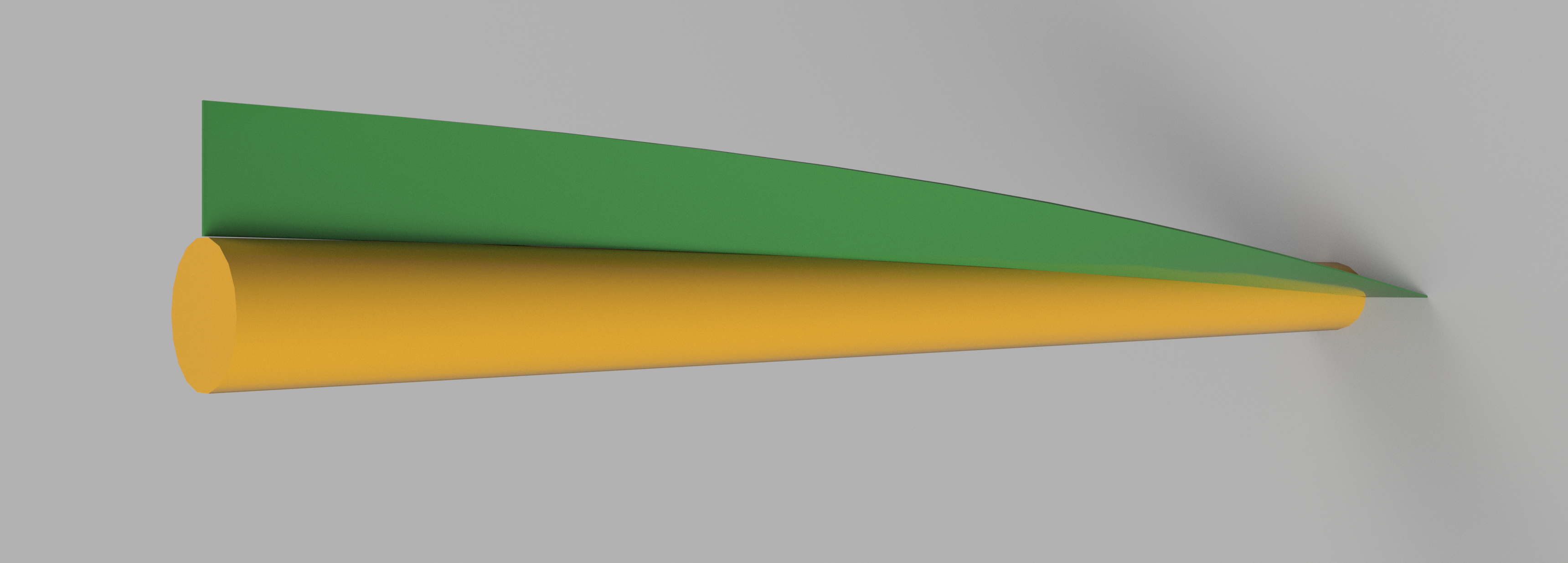

I tried using this method, with both surface and body sweep but to avail. Attached my spinal fin.
spiral fin.f3d (120.0 KB)
