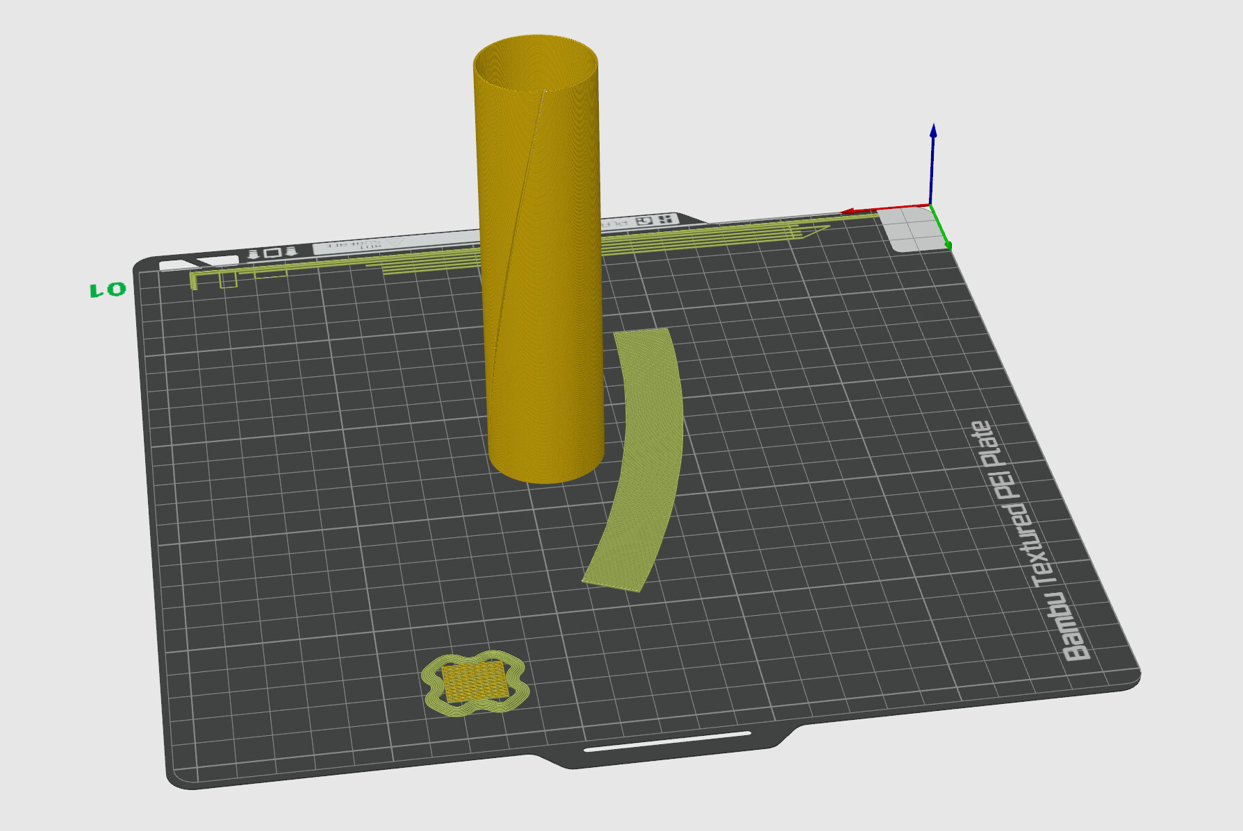

I am going to 3D print a scale model of the tube and the flat pattern to test it in the physical world.

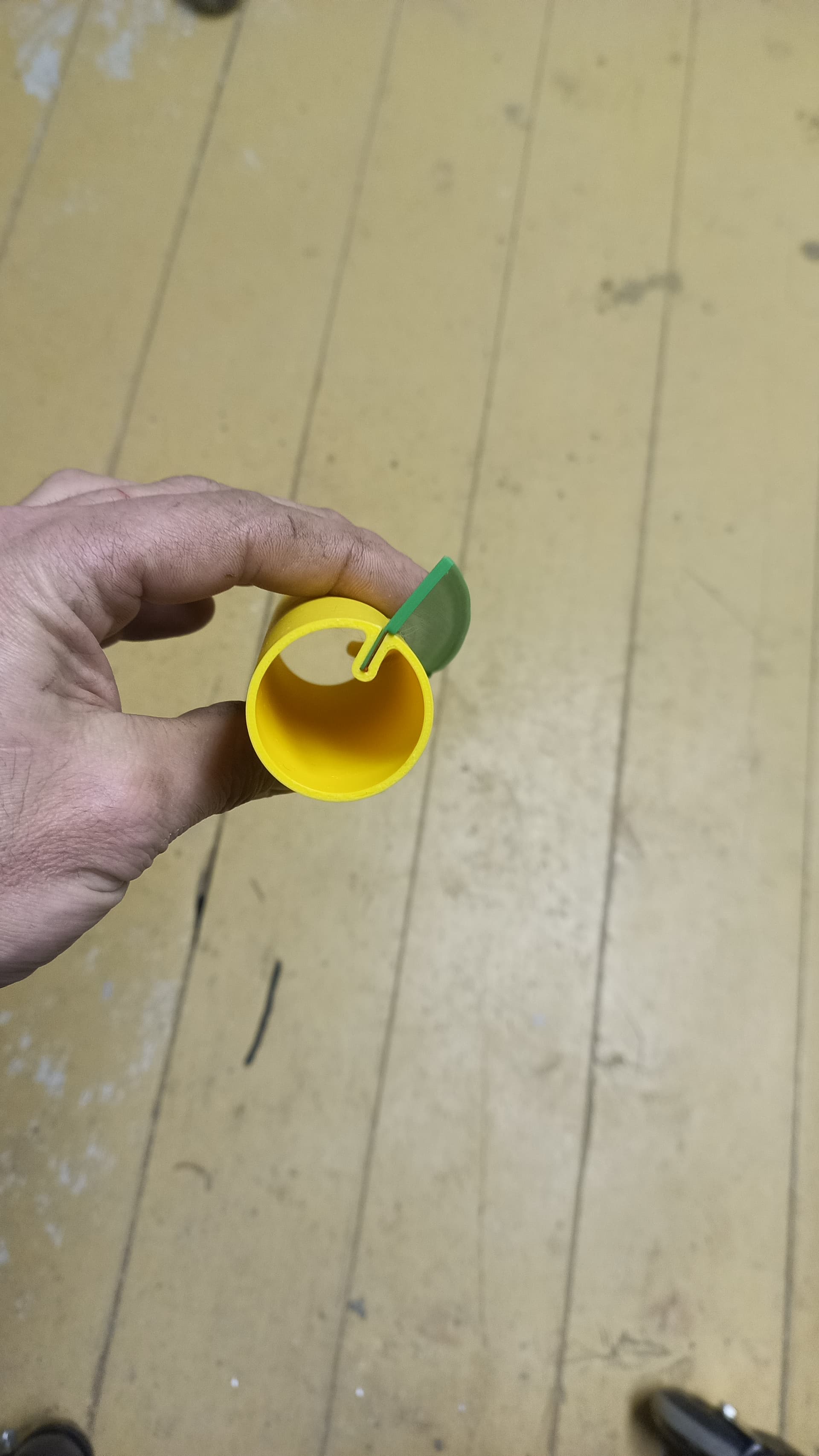

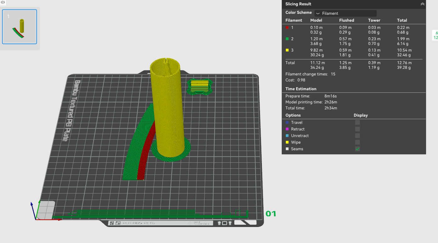

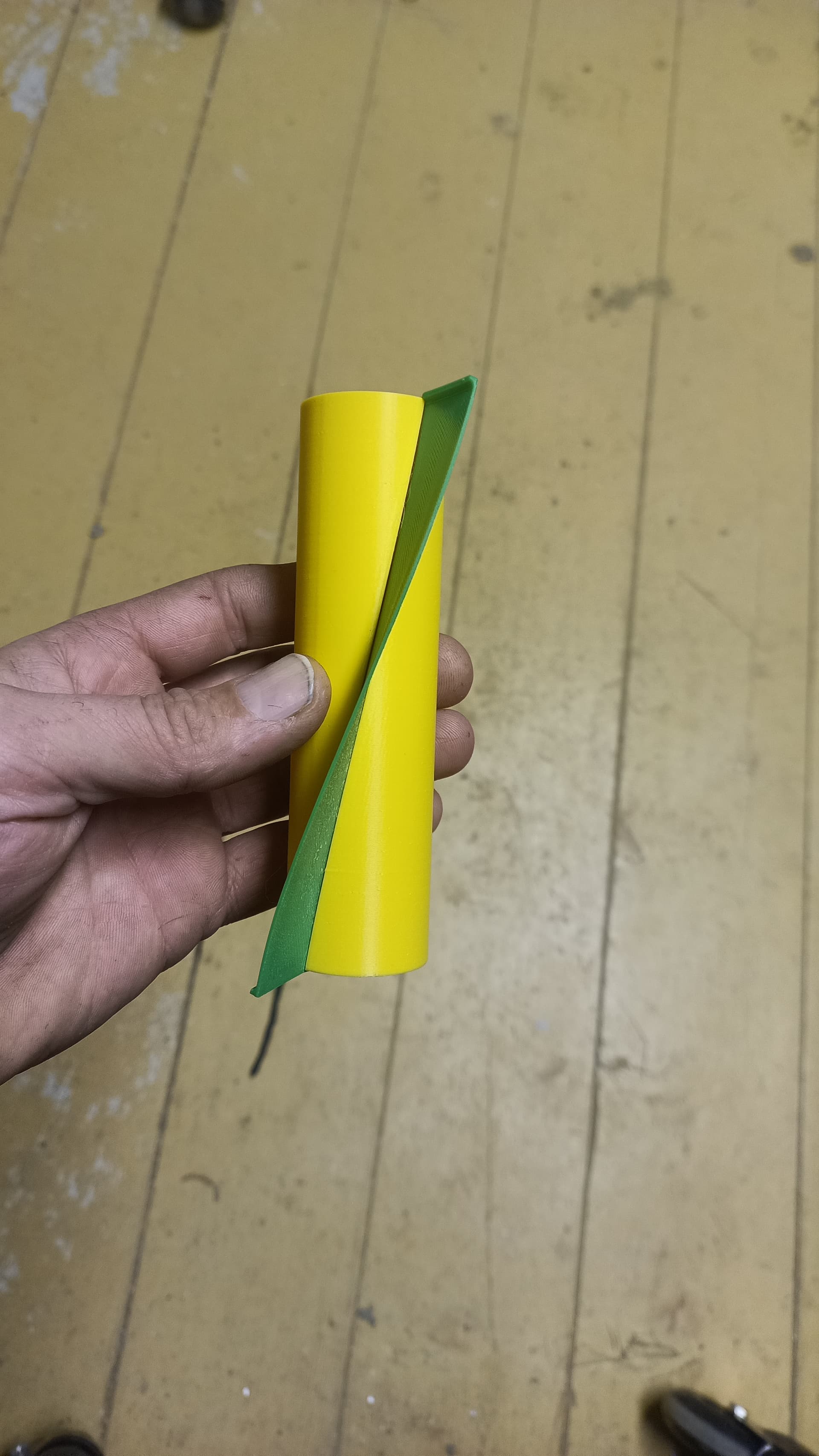

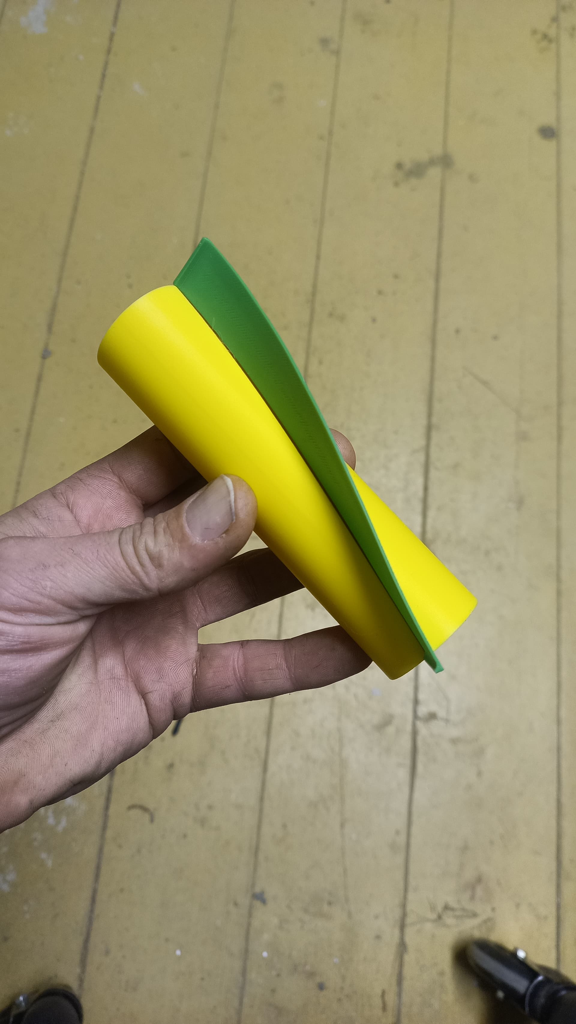

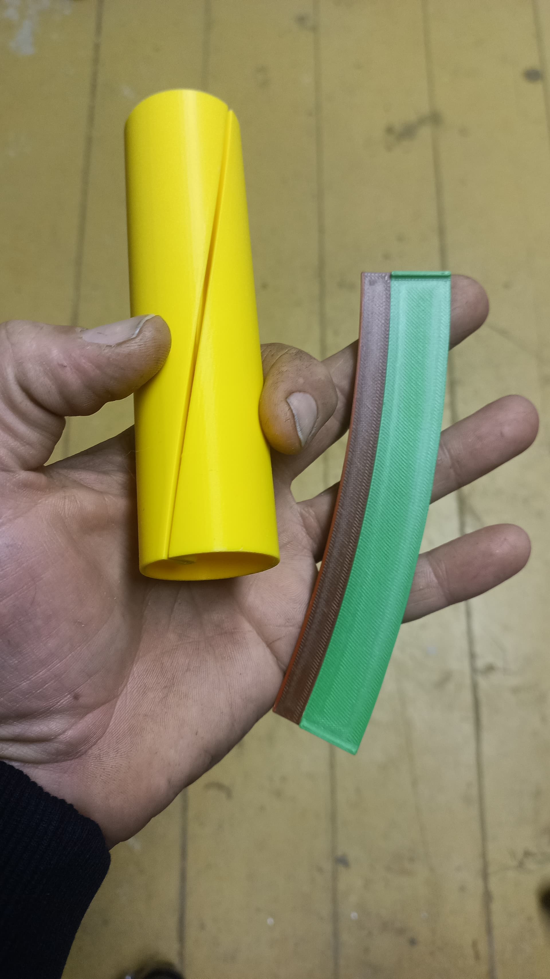

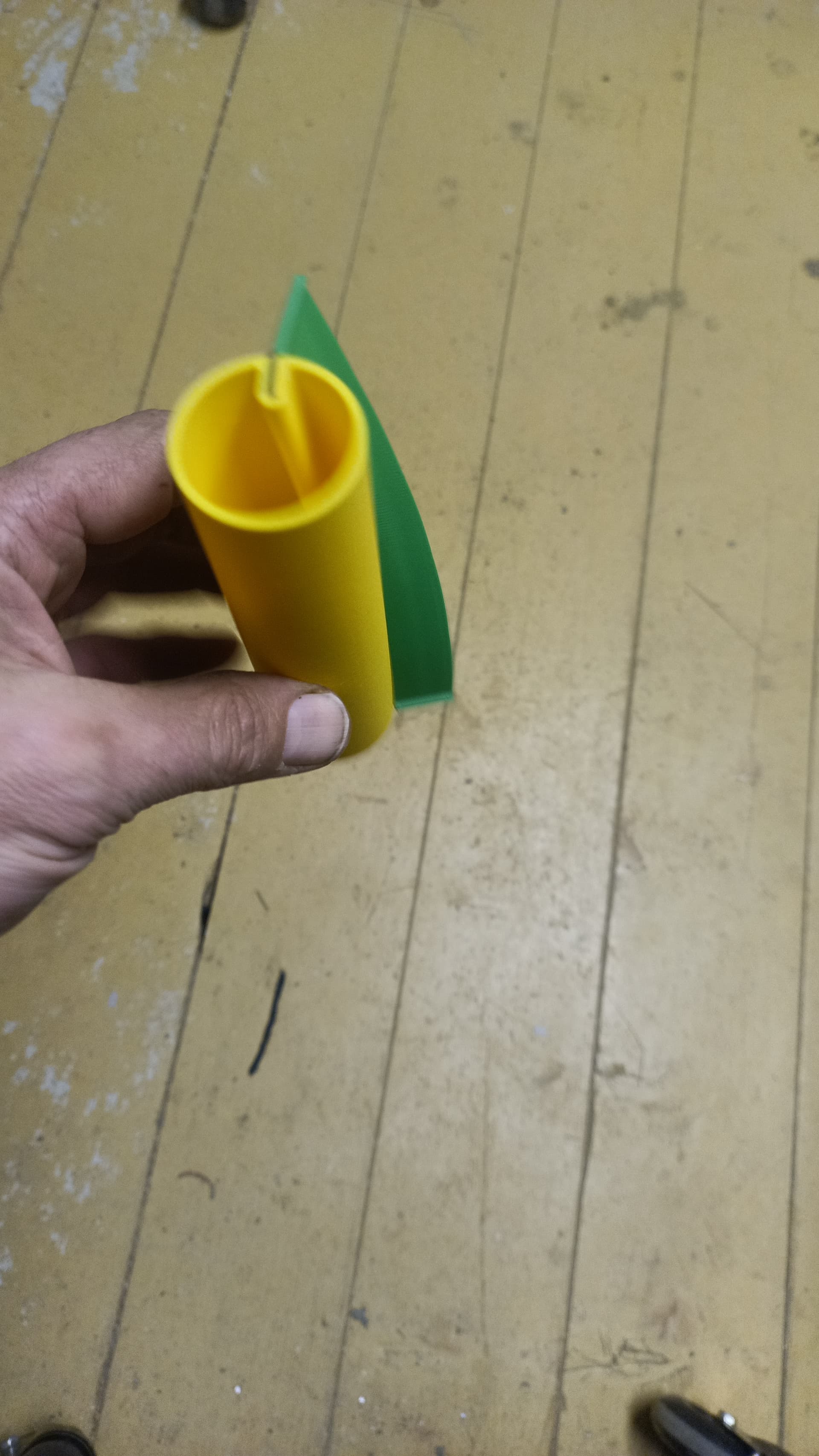

Here are the results of the 3D printed third scale model of our Twist.
It seems to work well I made a slot in the cylinder so the Finn could be installed I also colored the piece of the fin inside the cylinder red so if there’s any discrepancies you could see it on the surface of the cylinder.

We are still on the hunt for a simplified method to create the sheet metal pattern of the fin.
Good luck and I look forward to seeing some new methodologies which results in a unbroken sheet metal pattern.

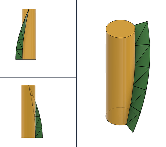

Now back to the object at hand, I see it only being solved by having very small triangular flanges that are averaging the position of the fin. I started to make something like that but I couldn’t get it to work quite right. This is where an AI assist with repeatable triangles would be helpful. Of course that would result with a saw tooth inner and outer edge of the flat panel but that could be compensated/averaged.
As was already brought up…but smaller triangles
Edit: I am wrong…not triangles, they will be slivers of rhomboid shapes because the inner curve will always be smaller.

BTW Tin, the print looks great and makes me smile. Is the fin TPU?
Thank you
It is all PETG HF
