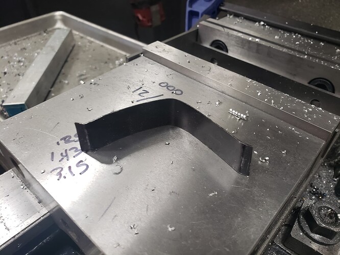

How I hold my Parallel set in the Modular Vises
Use Neodymium magnets. Its amazing how strong they are. You can find a bunch of them on Amazon.
They make magnetic hooks to hold them
Thats awesome! Although these might not work for mine due to my Parallel set sticks out past the vise since the vise is narrow. Sure I could cut them down but I use them for my vertical mill as well.
These are still pretty cool though and would work for the manual mill.
The magnets I used I already had just laying around and you cant beat free haha
I’ve never seen the magnet hooks before, those are cool. I play a lot with magnets but to hold parallels my go to solution is a flat spring made from shipping banding.
Free as everyone on this forum received some with their machine! Cut with tin snips and bend by hand and ta da!
I do similar at work. I bend them in a Z shape though.
I have lots of them in various shapes and sizes. It’s a very handy material to keep around.
That’s a fact I work in a recon shop we we repair parts. Lot of parts are casted if it won’t level yeah got to shim it.:rofl::rofl::rofl:
Freaking love it! Never would have thought! My hats tipped :+1:
