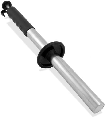

I have this to help with tip-ups and picking off hot parts…and it works like a charm cleaning the table of the bottom crap

As far as the water!! I drain the tank into 5gal pails; let it settle. When I am ready to use the table again I pour the water from the pail watching for the solids in the bottom to come forward. I take this out and pour into a small leaching area. When the table is nearly empty I put the plugs back in and I remove the slats for cleaning. I use my Shop Vac. to remove the remaining sediment from the table. I put a baggie on my pickup magnet to remove large solids before I use the Shop Vac. When I am finished I remove the baggie and the magnet is still clean.
