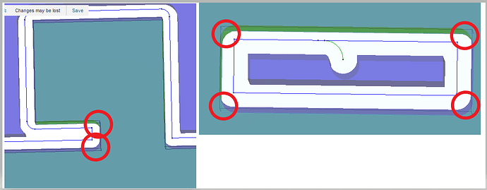

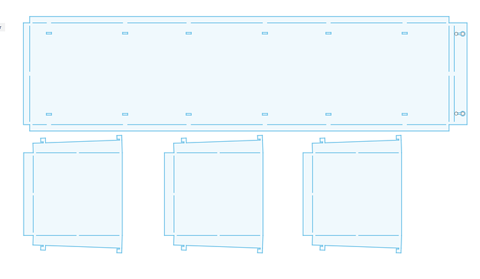

i got this mail holder off the file share and these three parts dont have a body so i can extrude. they are just lines. how do i fix that so i can extrude and go from there?
If you share the file it is easier for us to explain and demonstrate.
The primary reason that it won’t make a body is that a body requires an outside contour that is connect. And yes you are right: a single line will not make a body however a single line can ‘extrude’ cut a body.
What is pictured is not a single line but is a line the eventually ends back where it started: that is a contour.
If you zoom into these areas, you will likely find where the connection of the contour is broken.
There are many reasons for a contour to be broken. A few common issues:
- two lines don’t join at the same coincidental point
- a line overlaps a line but is hidden
Look for a white dot with an open center. That might be a clue, but not always.

In each case this line was the problem. I deleted it and replaced it and the profile came alive. Sometimes you just pick the right one.

You are likely to run into a few problems with this design:
I did not take care importing with metric vs inches so double check the measurements with what you are expecting.
During Manufacturing, I could not get the tool path to grab the slots (it kept discarding them) unless I picked a Preferred Lead-in Position for each and every slot:

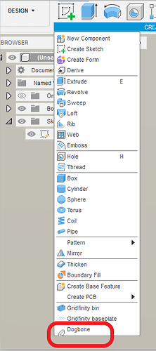

4a. To deal with removal of this extra metal, “dog boning” is the most often used technique. Fusion has a Dogbone features but I must admit, I don’t know how to use it.

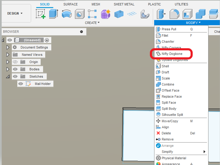

4b. I use a purchased dogbone tool called “Nifty Dogbone” and it is very slick. (I believe either one needs a body to apply to your design. It cannot be used on a sketch.) Once installed, it lives in the “Modify” section.
Here is a link to the Nifty Dogbone add-on for Fusion 360: Nifty Dogbone for Autodesk® Fusion 360™ | Fusion | Autodesk App Store
- Here is what it does to the CAM operation:
Mail Slots Dogboned Chelan.f3d (429.5 KB)
Edit: I actually explored the included Dogbone tool in Fusion and it works fine but is very manual. You pick the edges that you want dogboned and I picked a dimension for the “tool diameter” of 0.06 which is more than enough room and then click OK. It is much more labor intensive than Nifty Dogbone but works fine.
