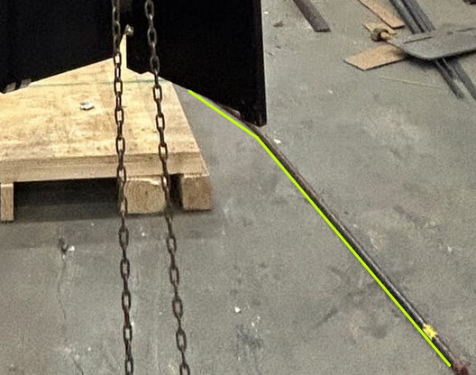

I made a low profile spreader. And used the beam in the center of my garage along with a 1 ton chain hoist.
I did the whole thing by myself. I edged the brake off of the pallet onto the thick wood blocks as described but as others have mentioned the engine hoist just wasn’t going to work so I went to plan B. Plan B consisted of using the hoist to put the brake on two of my car dollies so I could slide the brake under my 4 post lift. Once under the lift I slid the jack tray above the brake then used a chain to go from one lift plate to the above the jack tray then to the other lift plate and secured the chain to the plates. Lifted the brake with 4 post and set it on the base, bolted it down and it was done!

The hardest part was that my pallet jack is approx. 27" wide and the skids on the pallet were approx. 26.9" apart… So I could get the jack underneath. So just lifted one side on the tips of the jack and used a pipe to leverage it a few inches at a time but it worked.

Was this used in the first attempt to lift?
I am not judging. That seems like something I would have tried.
The pipe? I used that to move the pallet.
