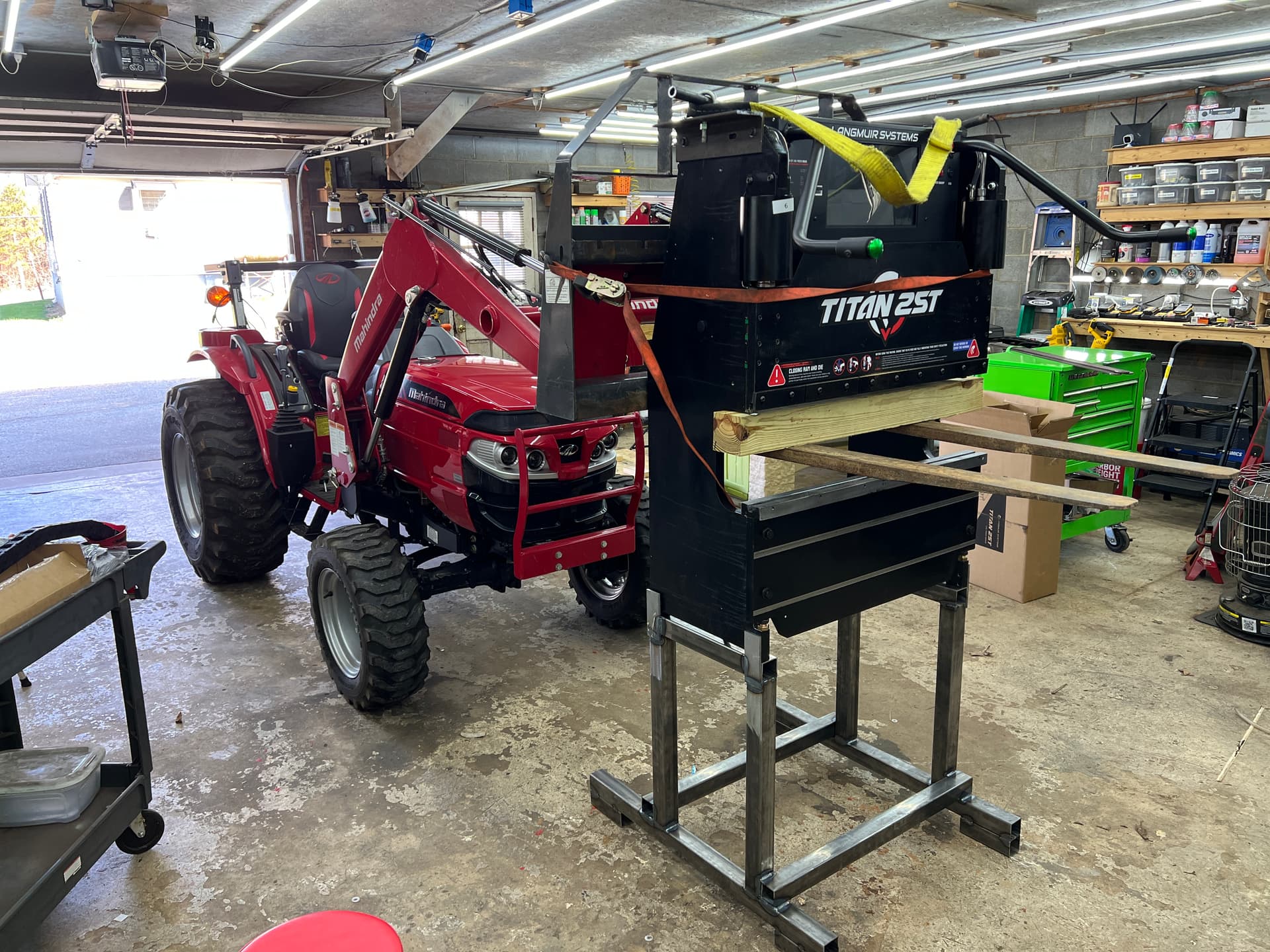

just placed a 4x4 in the “mouth” of the side supports. Ratchet strap to help with any tilting and forks on a tractor. Worked great…

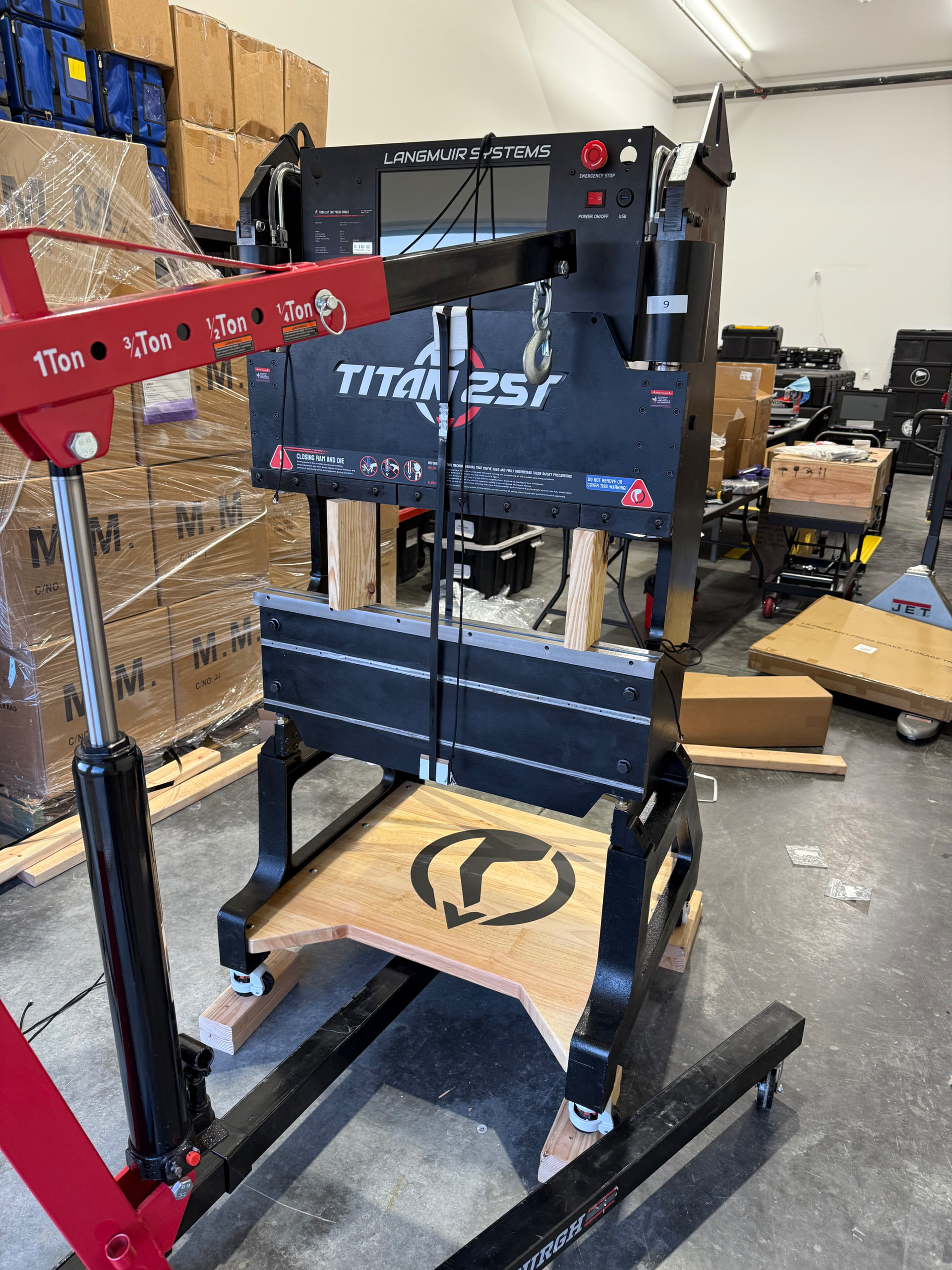

An engine hoist will work. The top half weighs about 750 lbs. I had a forklift, but an engine hoist can work with a little planning.
Bumping this thread - would like to see pictures of anyone doing this solo with the Harbor Freight engine hoist.
Looking to purchase one soon and need to pre-plan a bit.
