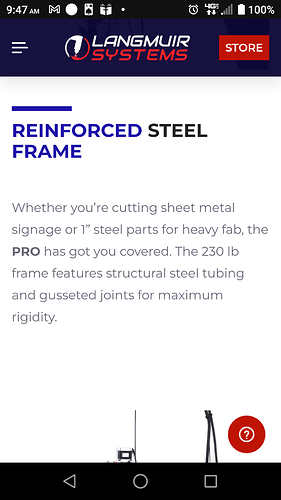

Come on people we are talking about a Langmuir hobby table. That should be used with plasma cutters from 30 to 60 amps. Cutting maybe up to 3/8".
If you want to be cutting 1/2" and thicker metal fork out the 50/100 grand and get a real plasma table or water jet or a laser setup.
Well me personally I don’t have between 50 and 100k. When I need a part made and need to push my equipments limits. I am going to do it. I think a lot of us will.
Here is a screenshot of what I think langmuir considered as capabilities for the pro table. :person_shrugging:
I believe 1/2 which is what the op is talking about is well within the capabilities of the table itself. Now ones plasma cutter is a different story. The rw45 is rated to cut 1/2.
