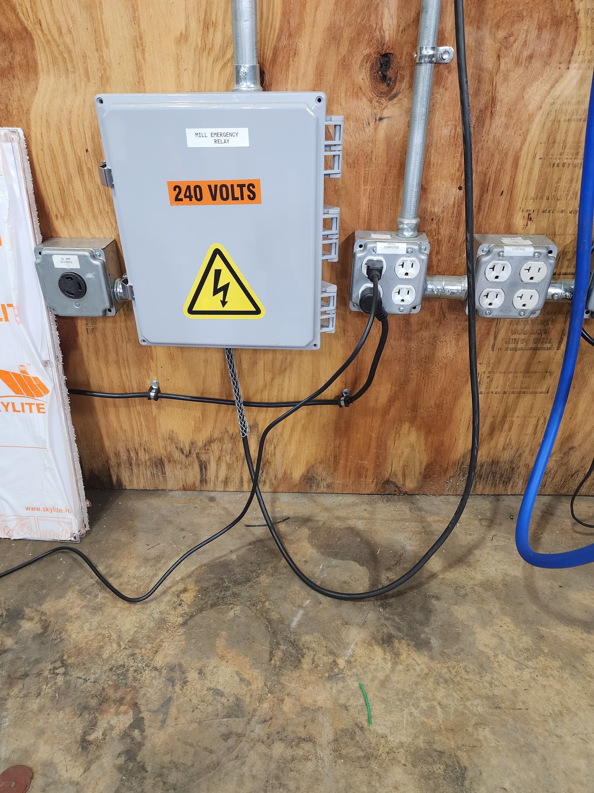

I figured out what the issue was. I didn’t realize the E-stop doesn’t cut cabinet power. So the drivers were powered on for a few days. At least it was something stupid!
I have a relay box that controls all the power 240 / 120 with E stop switch.
Push the button and its all off with the exception of the computer. Amazon Photos
Nice! We are planning on building something similar with PLC and power on and off switches. Partly to switch power between our laser cutter and the MR1, but we haven’t quite got to that project yet.

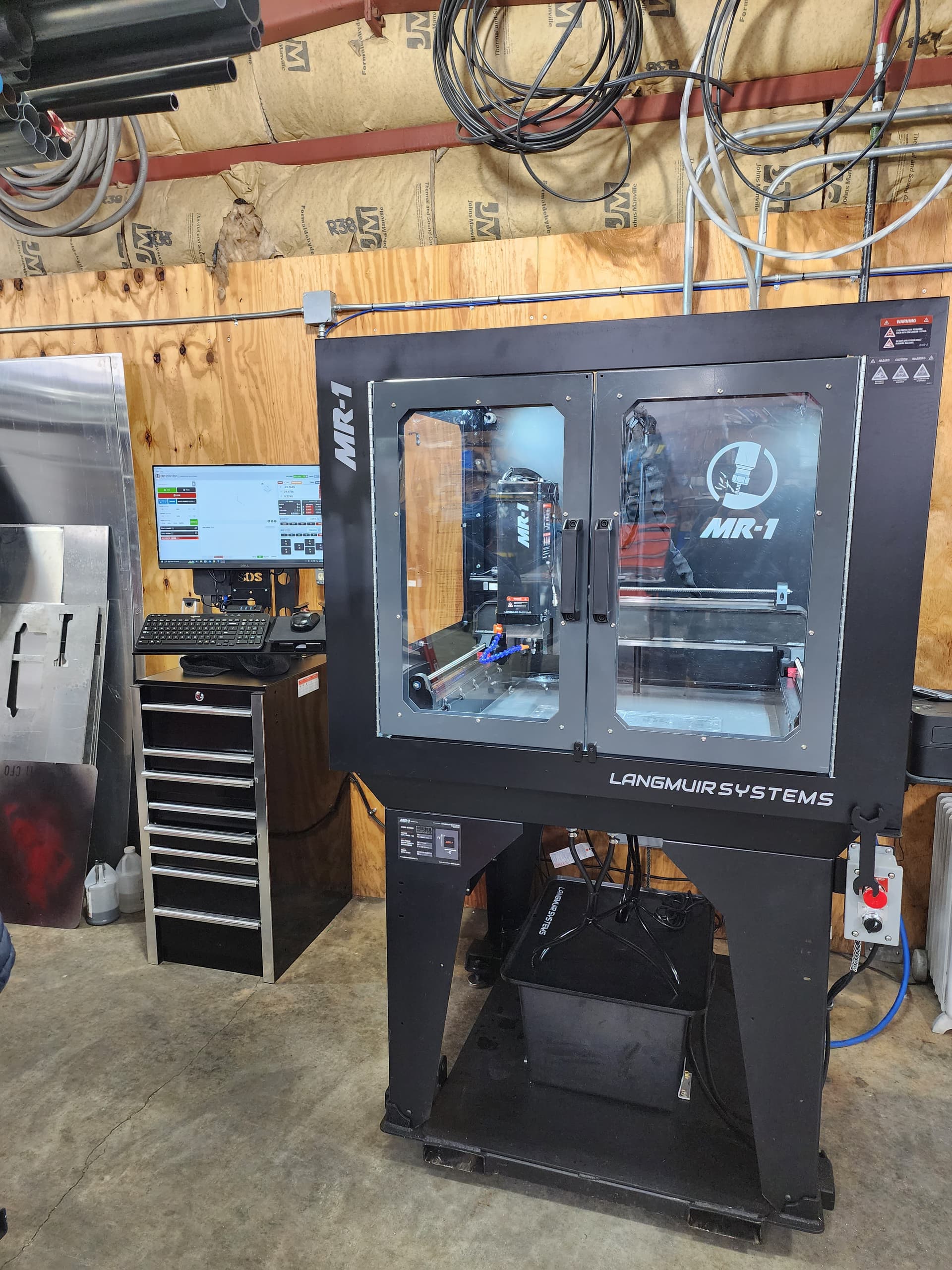

That machine looks awfully clean:) Those lights are a nice touch.
