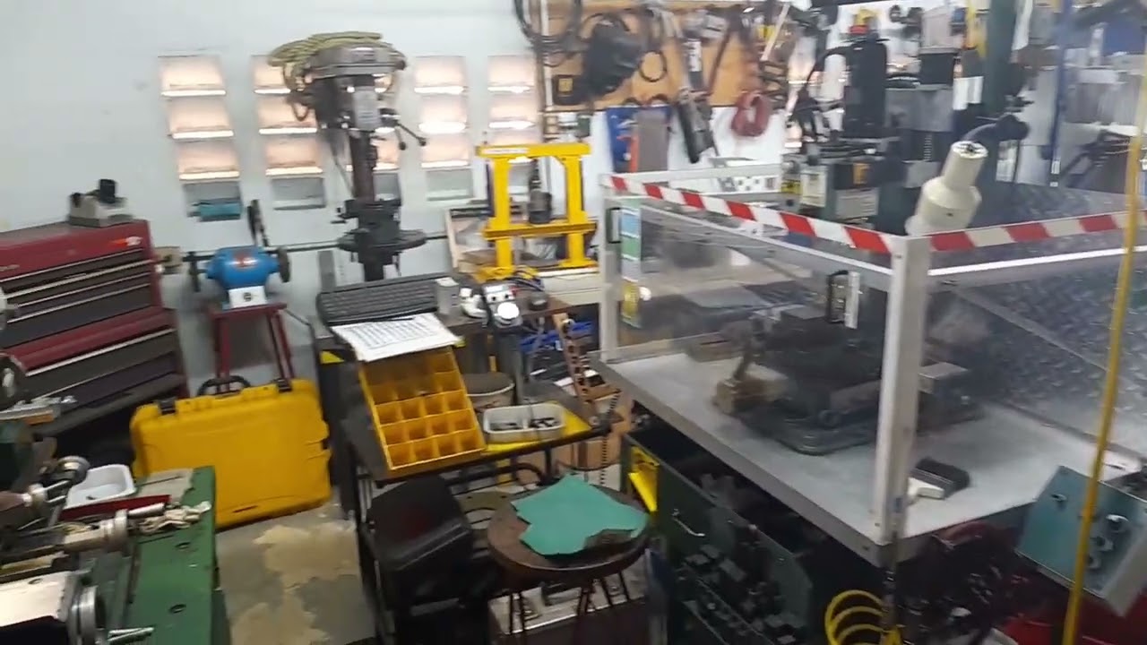

Here’s a quick walk through the shop this morning, since its now relatively clean (a project unto itself) :beers: :rofl:
You’re exactly the kind of guy that needs a couple of apprentices to pass on some of that knowledge.
Awesome shop tour!
Yup, I hear yuh, but can’t seem to find young people interested or with the attention span to get with the program. Most seem to chase the money and only want to do so behind a desk looking at a computer monitor. My two boys are all grown successful professionals living in the US (one,an MBA in Aerospace Systems and the other a PhD research scientist in Molecular Biology). So it’s pretty much this old fart in the Caribbean with his toys and a whole bunch of life experience doing his best. I’m semi retired but have a lot of support work going on in the Biomedical field and associated with Avante Health Soltions of Louisville, KY, so that keeps bread on the table and toys in the shop.
I might be available for adoption if you need someone to teach… :rofl: :rofl:
