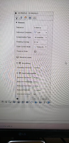

Here is another with no torch off between cuts, no retract at end, and no speed
Simple is beyond F360 evidently.
Still trying to do hole tests, and it just won’t post right.
2 .685 holes .985 between centers, left and right closed chain, smoothing and feed optimization.
I should add that I get an IHS fail at the second hole, even after I add a m30 at the end of the first cut.

It’s not posting right because there is more optimized feed rate than the original feed rate.
I brought it up a few times in the past but it’s one of the issues that comes up using feed rate optimization and the way the post-processor works.

Just create a hole you’re going to cut in Fusion at a normal feed rate and then apply feed rate optimization to it and then post it and it’ll come up with a zero program speed.
I’m assuming this is a post processor bug?
Try to set the feed rate of the program to 35 ipm instead of using feed rate optimization reduction
It only happens on hole cut only files. Files with other geometry seems to work OK.
I have gone and looked at the fusion cut setup, and my tool_feedcutting is higher than my reduced feed rate.

This first program has a 5/8" hole with no feed rate optimizer added

:white_check_mark: Program speed
This second has a 5/8" hole with feed rate optimizer added so there is more optimized length then standard length of cut

:x: no program speed
now here is a hole in a square with feed rate optimized applied so there is more length of non optimized cutting then optimized

:white_check_mark: program speed
works again.
From the original G-code, there’s a lack of torch off commands (M5). I recall seeing this before.
Look at the post. The onSectionEnd should have a writeBlock command adding the M5 as shown below.
