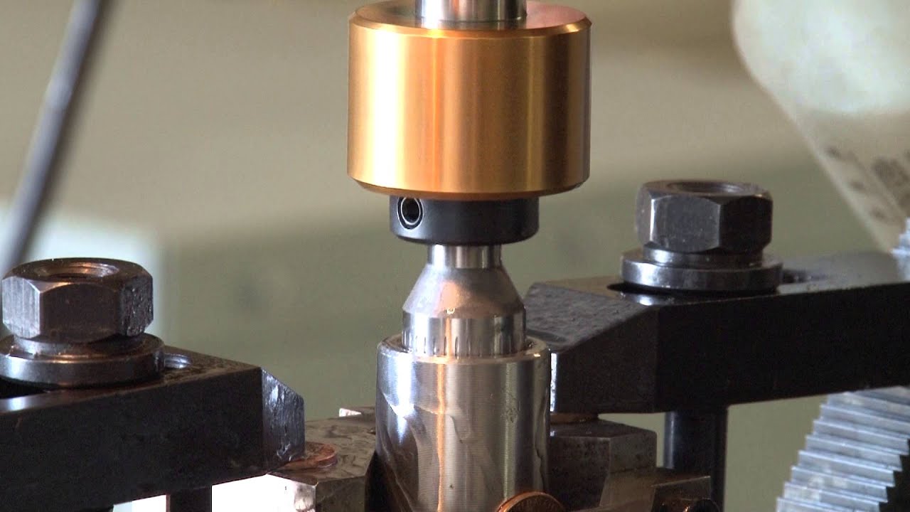

I figure this thread can be a good compilation of different S&Fs as well as tooling combos people are using that work well on the MR1 as more of us start getting our machines running parts. One tool setup I am particularly interested in exploring is a rotary broaching setup on the MR1 for making pitman arm splines.

I only heard about rotary broaching a couple years ago. From what I understand, you don’t need CNC controls to use one. Problem is they are pricey unless you can learn how make one yourself. So is making a rotary broach using the MR-1 the plan or am I misinterpreting?
Or do you want to plunge cut individual teeth similar to this YT machinist but use a CNC program to automate all the movements instead of requiring a rotary table with the spindle rotation locked?
The idea would be more to just run a rotary broaching head in the mr1, but you do make a good point about the need for custom broaches. Ideally I would do the index style broach with a single tooth cutter, this is how I have done it in the past, if the mr1 spindle could support indexing I think this would be a really viable option, perhaps this is something @langmuirsystems will add down the line, the motor already has the encoder so id imagine its possible with some software changes.
I really don’t know enough about it. I’d be surprised if LS could index the spindle to the accuracy required to cut splines in a 360 degree arc. Much easier to do by adding a 4th axis whether the axis be vertical or horizontal. The MR-1 spindle motor has a 1:2 pulley ratio where as a rotary table motor would typically have something like 40:1.
