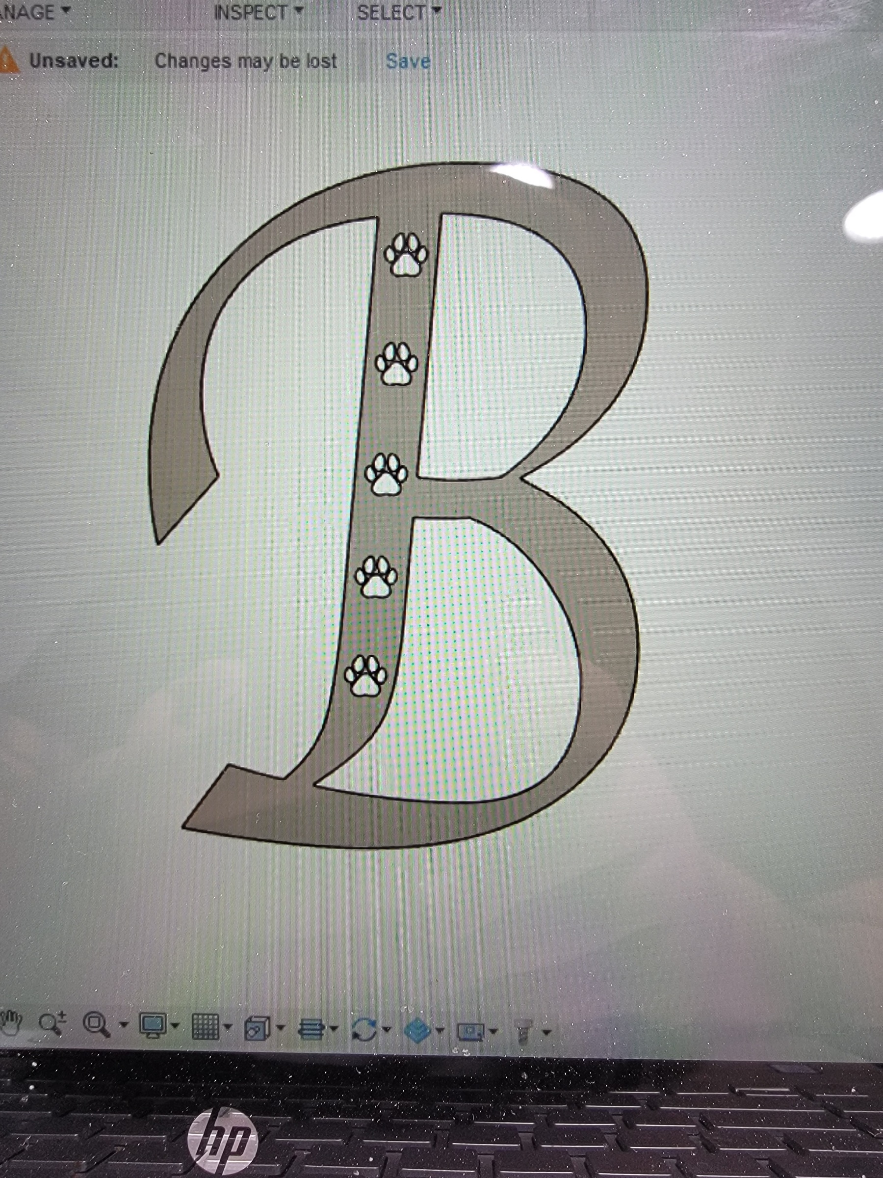

Hello. I’m fairly new to fusion 360 and have been learning as I go. I’ve been working on a drawing for a couple of days and can’t seem to get any where when it comes to the tool paths. I’m trying to tool path a letter B with paw prints cut out in the letter itself. When I go through the process of setting up the 2d profile and run a simulation all it will tool path is the actual letter I can’t get it to path the paw prints. Any tips will be appreciated. Thanks alot.

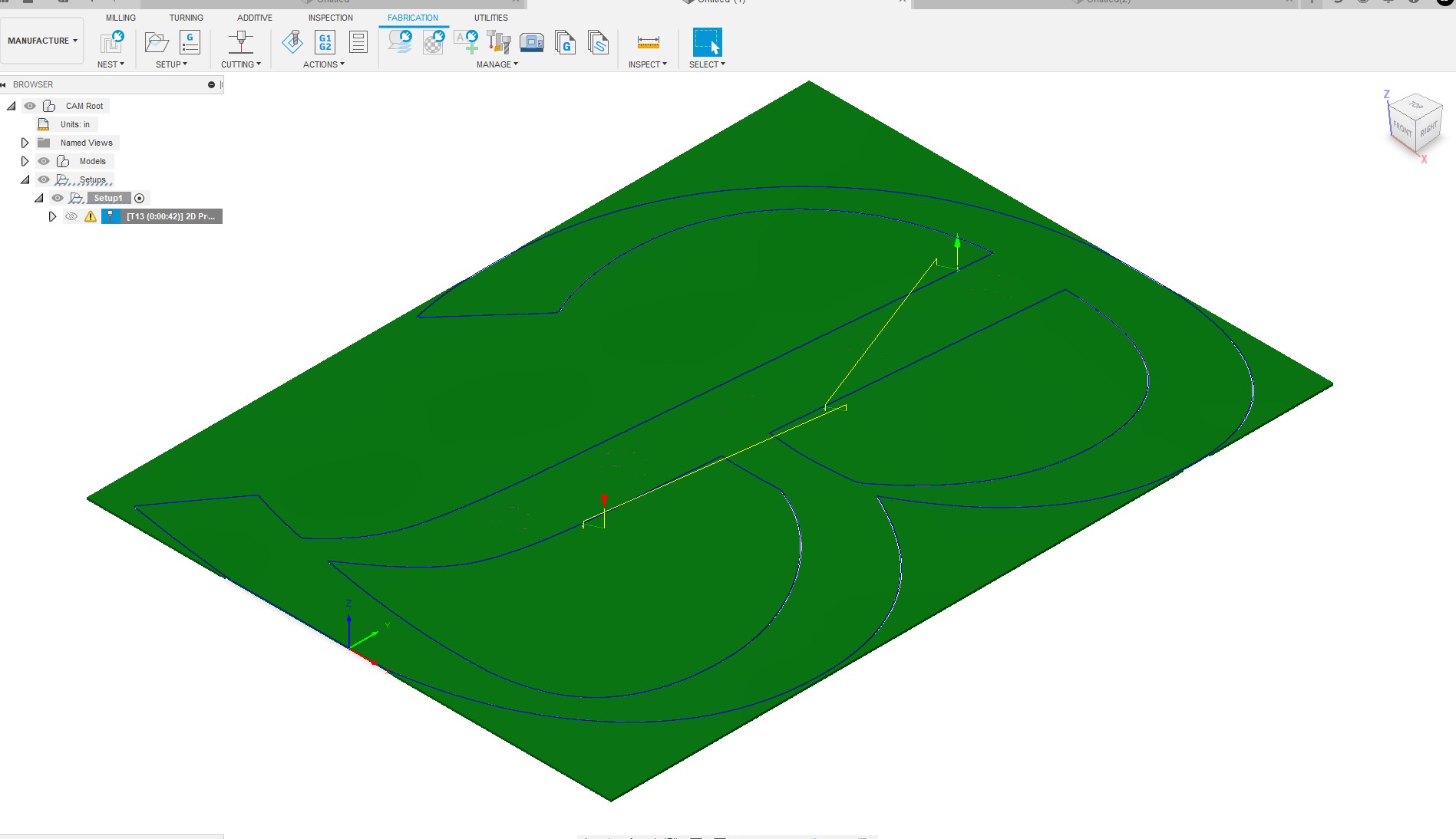

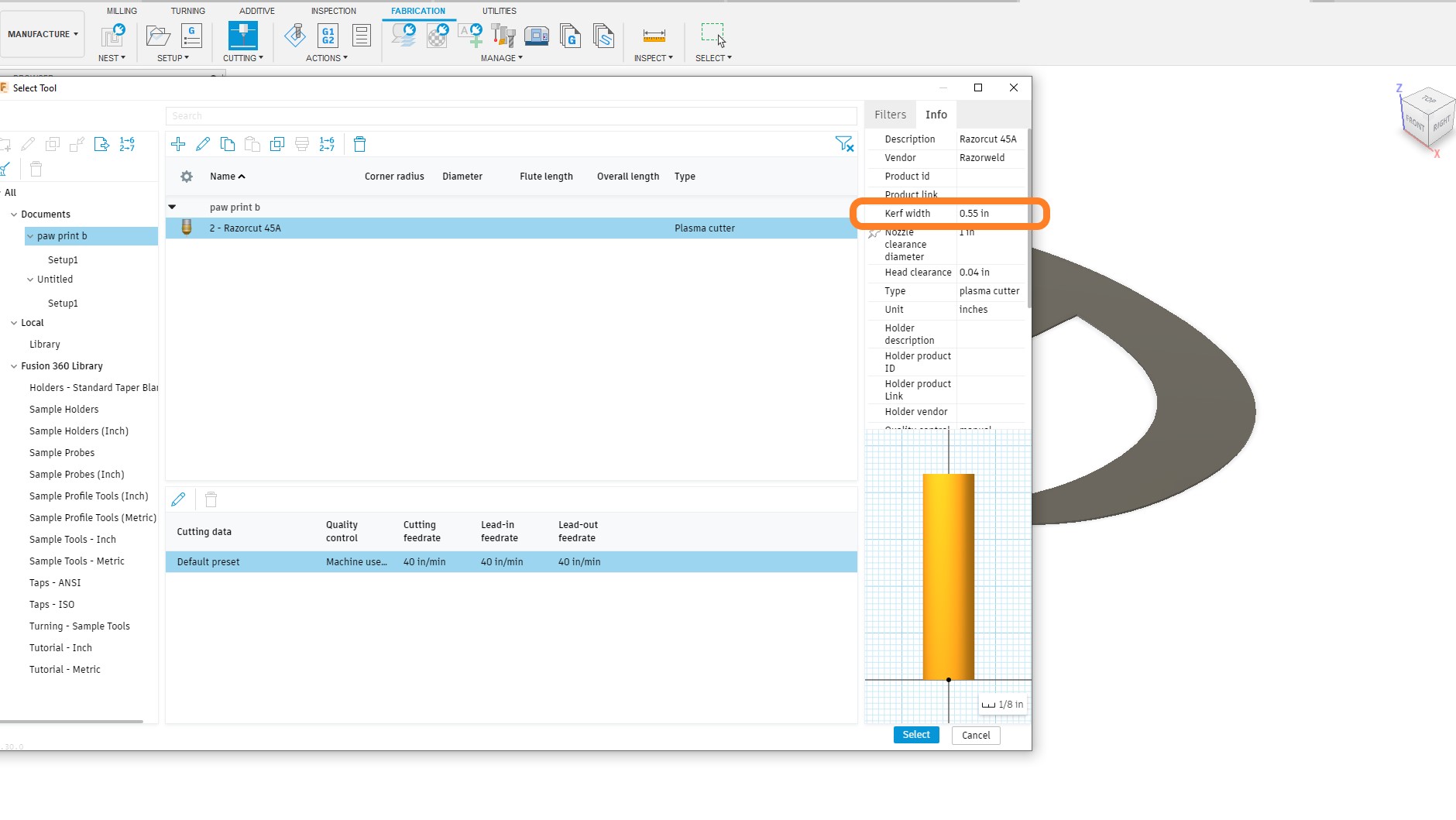

It’s likely that those openings are too small for it to develop tool patterns based on the information you gave it.(kerf, Pierce clearance, lead in lead out, etc)
Post a dxf or f3d file and I can take a closer look.

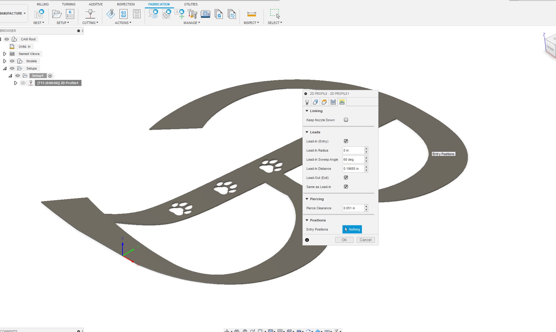

Looks like the paw prints are going to end up very small… What is most likely happening is that Fusion is not able to fit Lead-Ins on those small cutouts. If you remove Lead-Ins all together, does it complete a tool path then?

i just tried removing the lead-ins and its still leaving them out

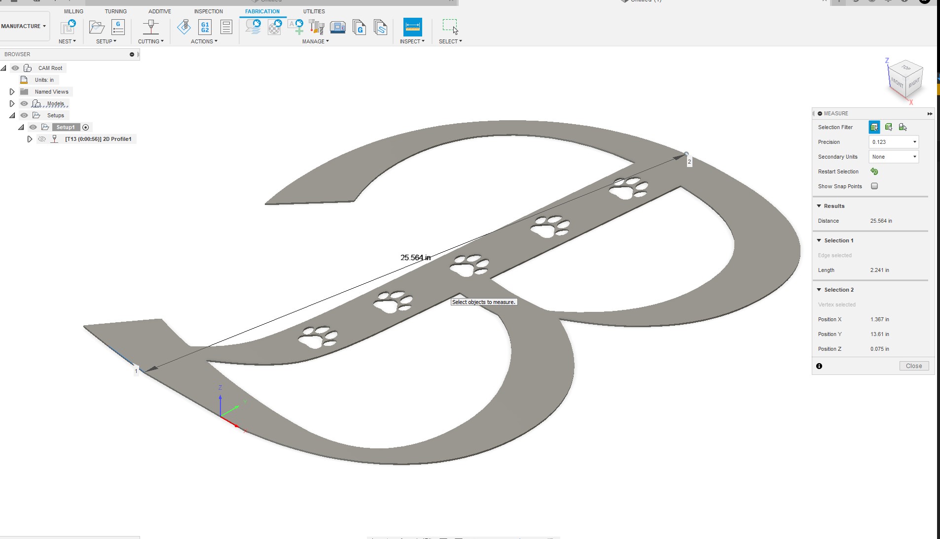

The height should be 25"
screen shot your parameters
Yeah, I got approximately 19"x25" and SheetCam doesn’t have a problem with it either… Is this one of those instances where extruding the part would make a difference? I don’t really do the Fusion thing…

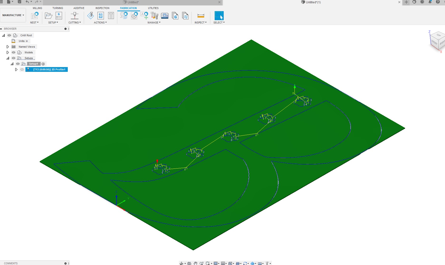

Setting the Kerf to ,051 did the trick. Thanks so much for the all the help
