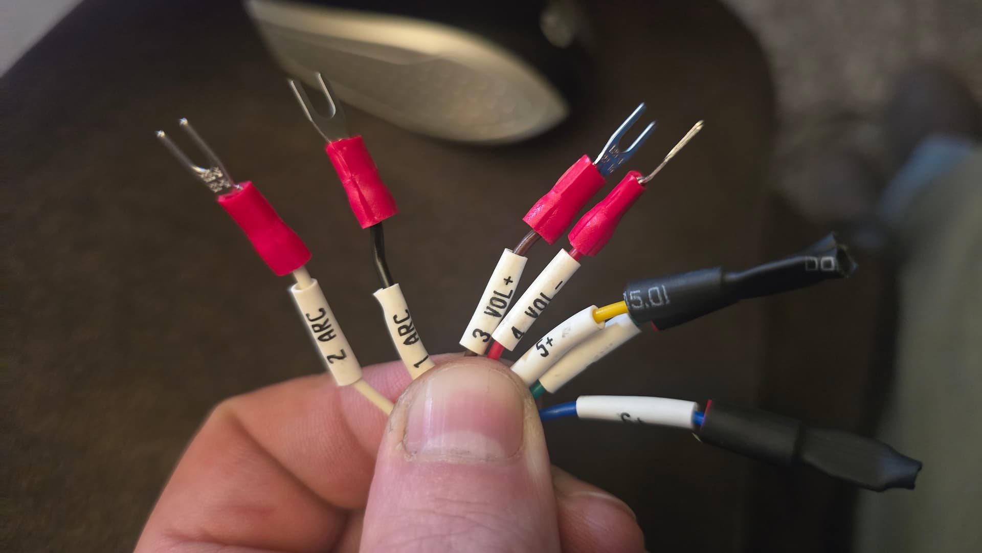

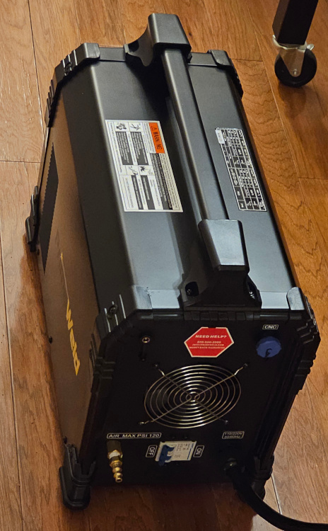

i need some help with the wiring from the primeweld cut 60 to the thc box. i allready have wires 1 and 2 wired for the torch fire to the barrel connecter to the control box. i had the 3 and 4 wirered to the thc input but was getting errors and then switched the polarity and was getting 300v. hopefully i didnt fry it ant help would be greatly appreciated thanks!

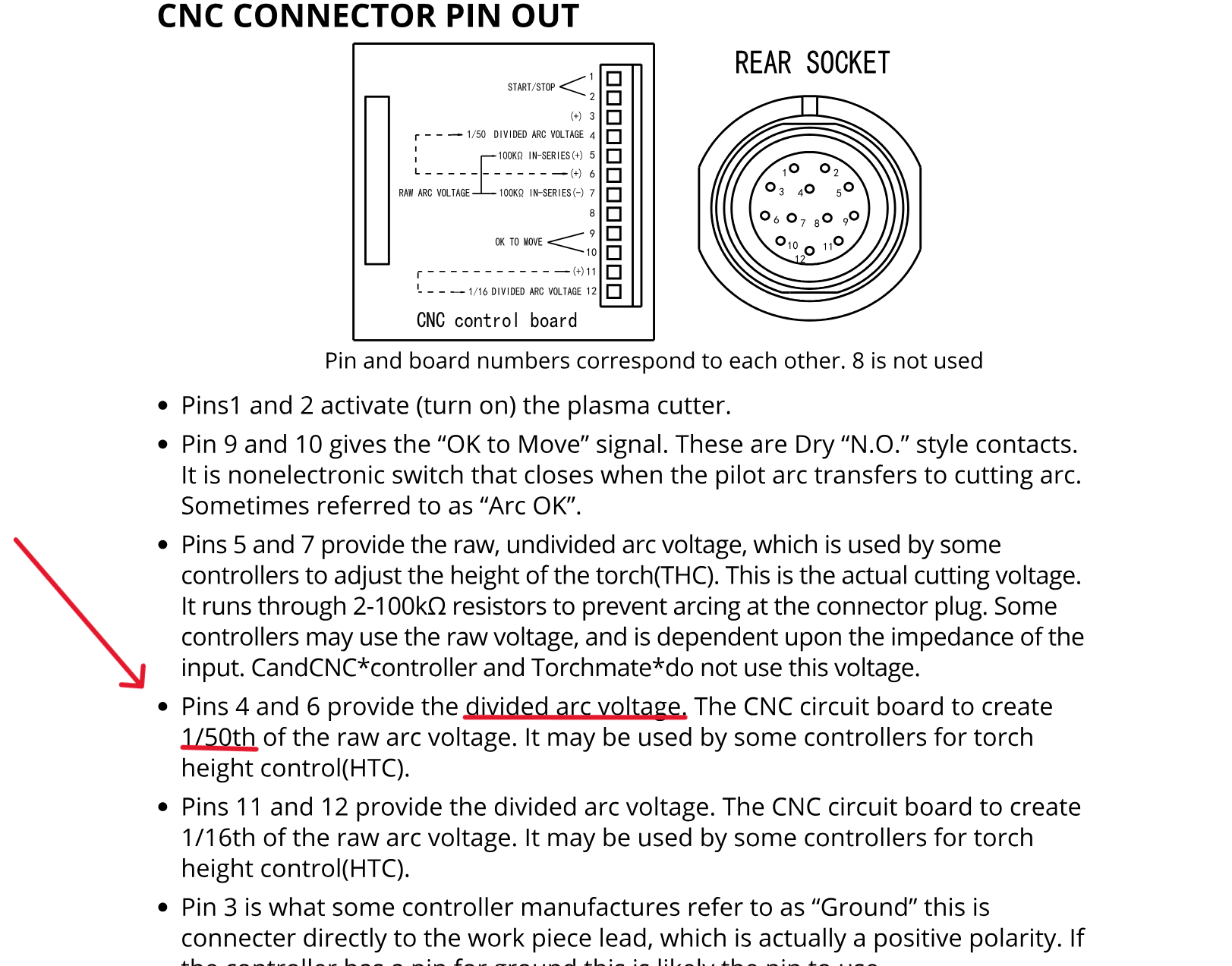

Your manual.
Here’s the excerpt.
And the other manual.
perfect thank you i really appreciate it!
While a lot of people have had success running divided voltage from the primeweld’s CPC port, others have not.

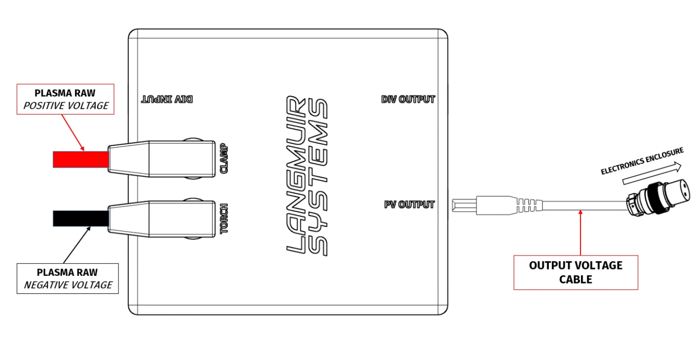

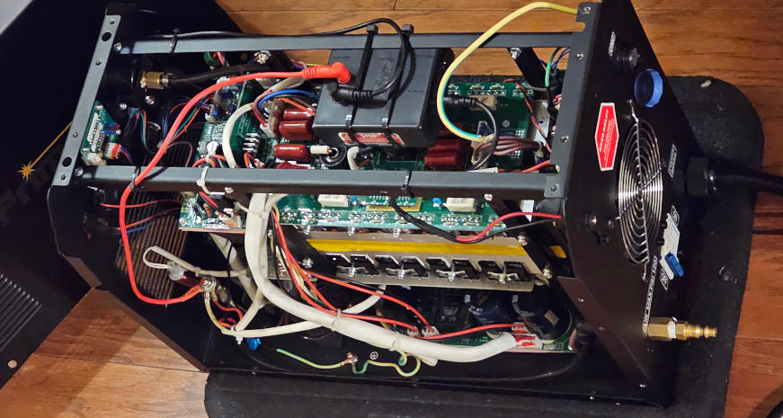

The most reliable source for the THC voltage measurement (RAW) comes straight from the lugs with inside the prime weld.
Here’s a PDF outlining the procedure from @nicaDd
https://forum.langmuirsystems.com/uploads/short-url/rzFqfMZGINy0QhCQW2GQgET1vq2.pdf
Going this direction you would use the other pathway through the voltage input module (VIM)
You could also use a port like this
instead of running the wires through the louvers of vent cover would make install the little cleaner.

I’m normally on the side of running only raw on a CUT60 and agree I’ll never run or suggest going divided.
The cable he has in his hands only comes with the newest variation and that’s what he owns. No one has opened it up yet to run raw, but the power supply along with the voltage divider are all completely reworked in the newest version.

I am going through this right now with a brand new cut60 and crossfire pro, Ive been digging around the fourms to find the most up to date info and am going to try the cnc port hookup first, ill report back findings

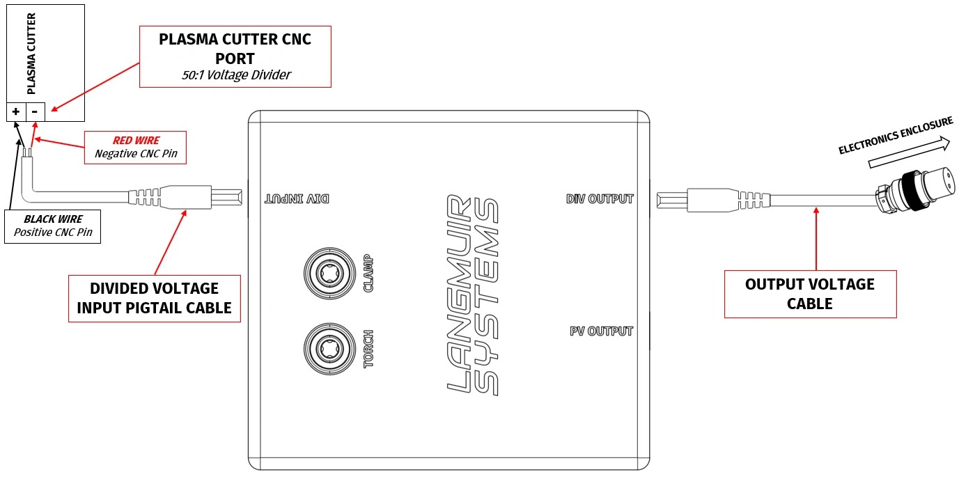

if your cut60 came with a ready made cnc connector with 7 wires coming out, then use wires 1/2 for torch on/off, wire 4/6 for thc.
Langmuir should have provided 2 cables with barrel connectors on one end and 2 bare wires each on the other. the cable with white jackets is for torch on/off. the cable with red/black wires are for thc. that one should be red to red and black to blue.

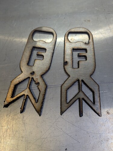

The wiring worked for my gen3 cut60, these f bomb remixes I grabbed off the file share were the first cuts and ran them with minimal setting tweaks, left hand is without THC and right is with THC on ( don’t mind the extra piercing, I was working though an issue)
