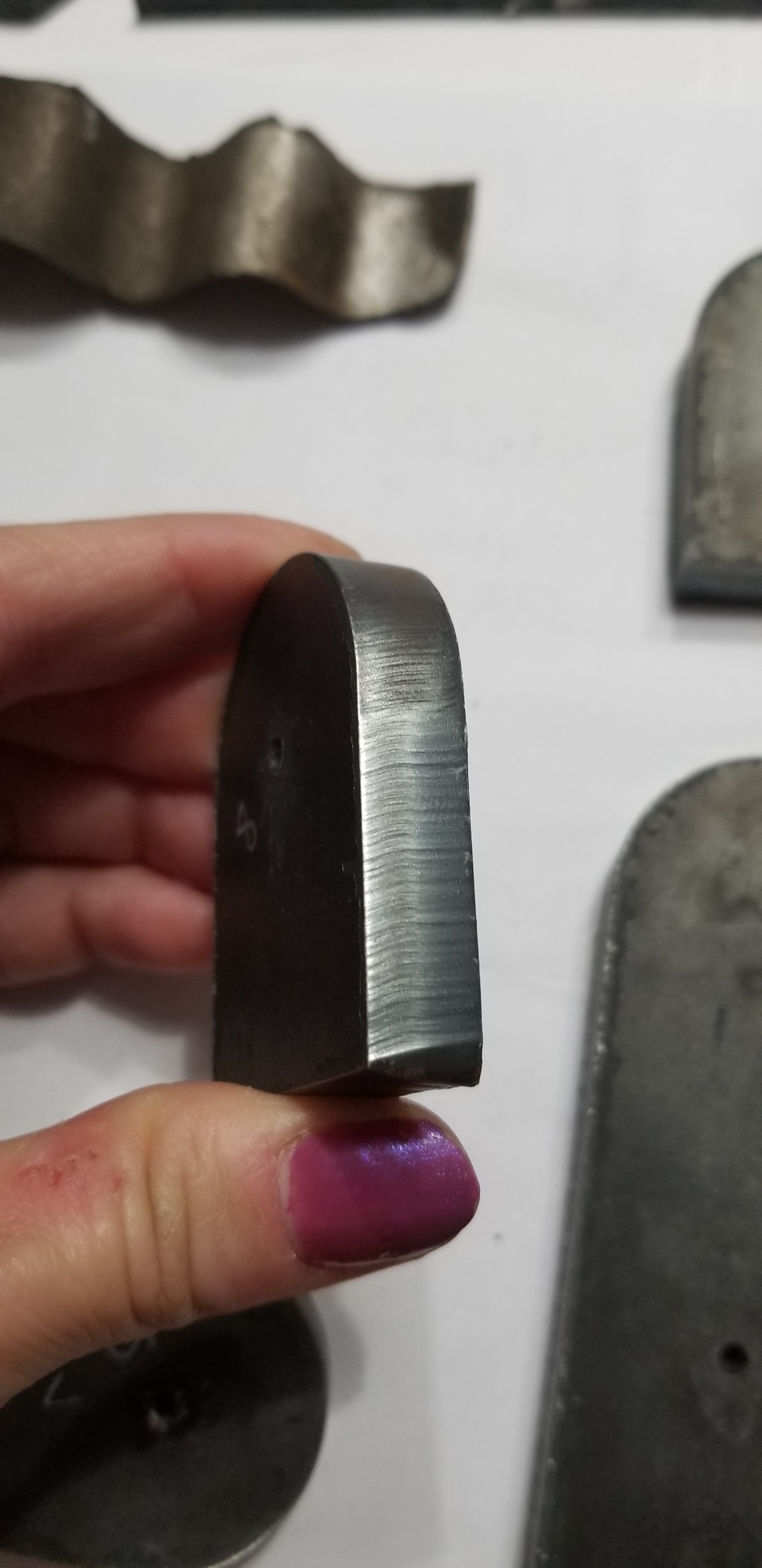

I went back and looked at your initial pictures. #1 and 2 look ok to me. #7 is what my cuts looked like with all the mistakes I was making.
Keep in mind 2 degrees of taper is normal.

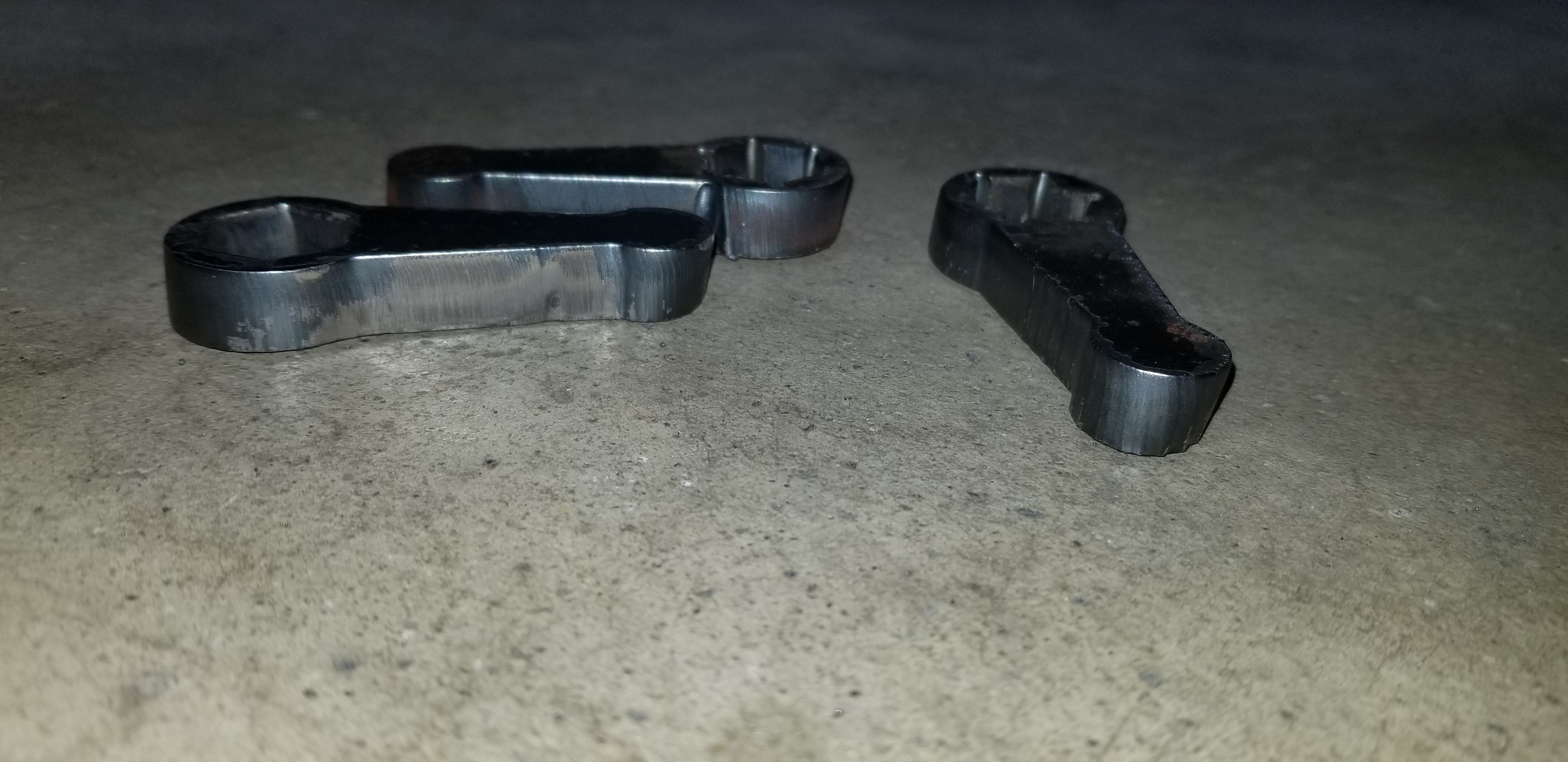

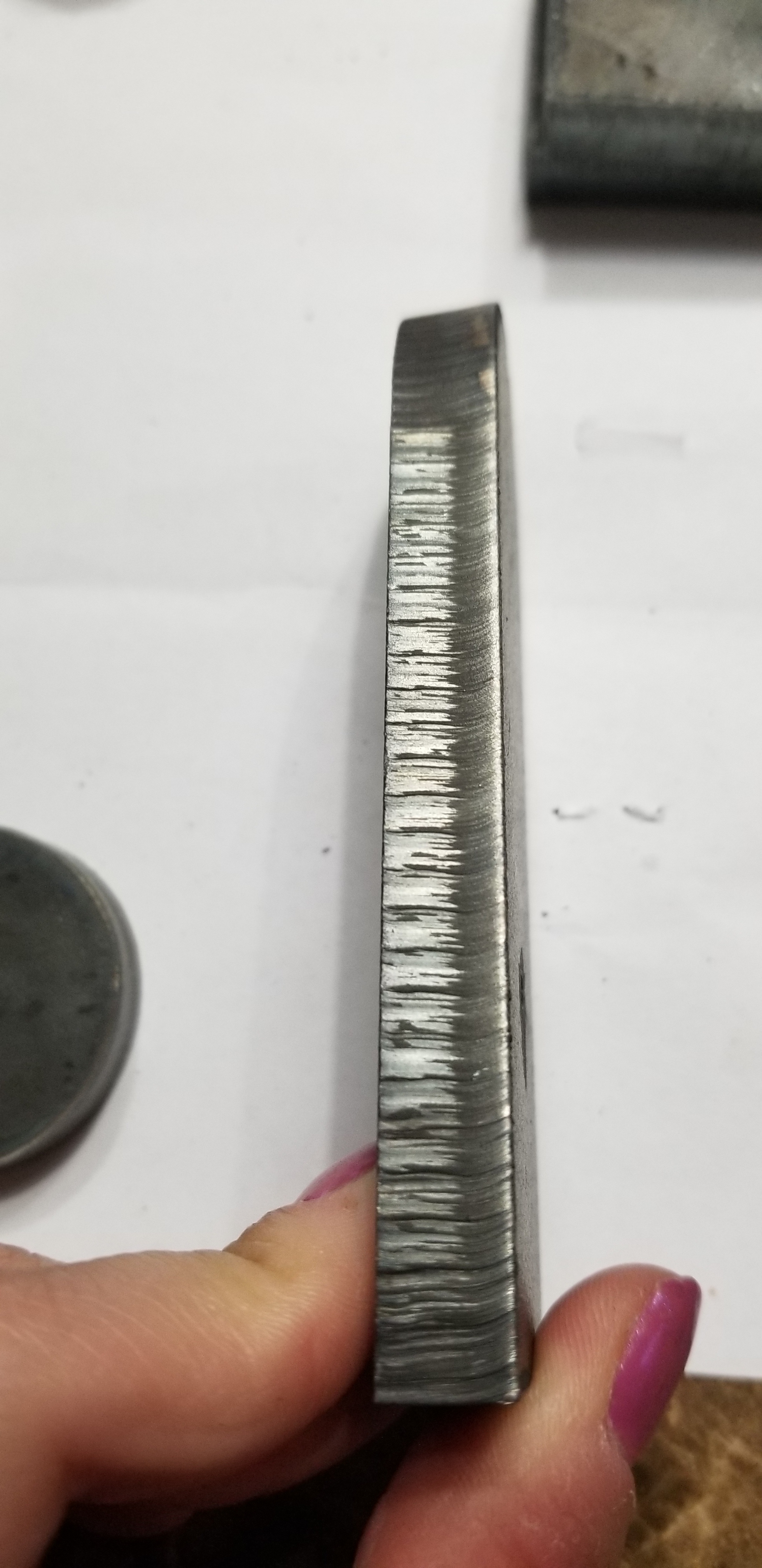

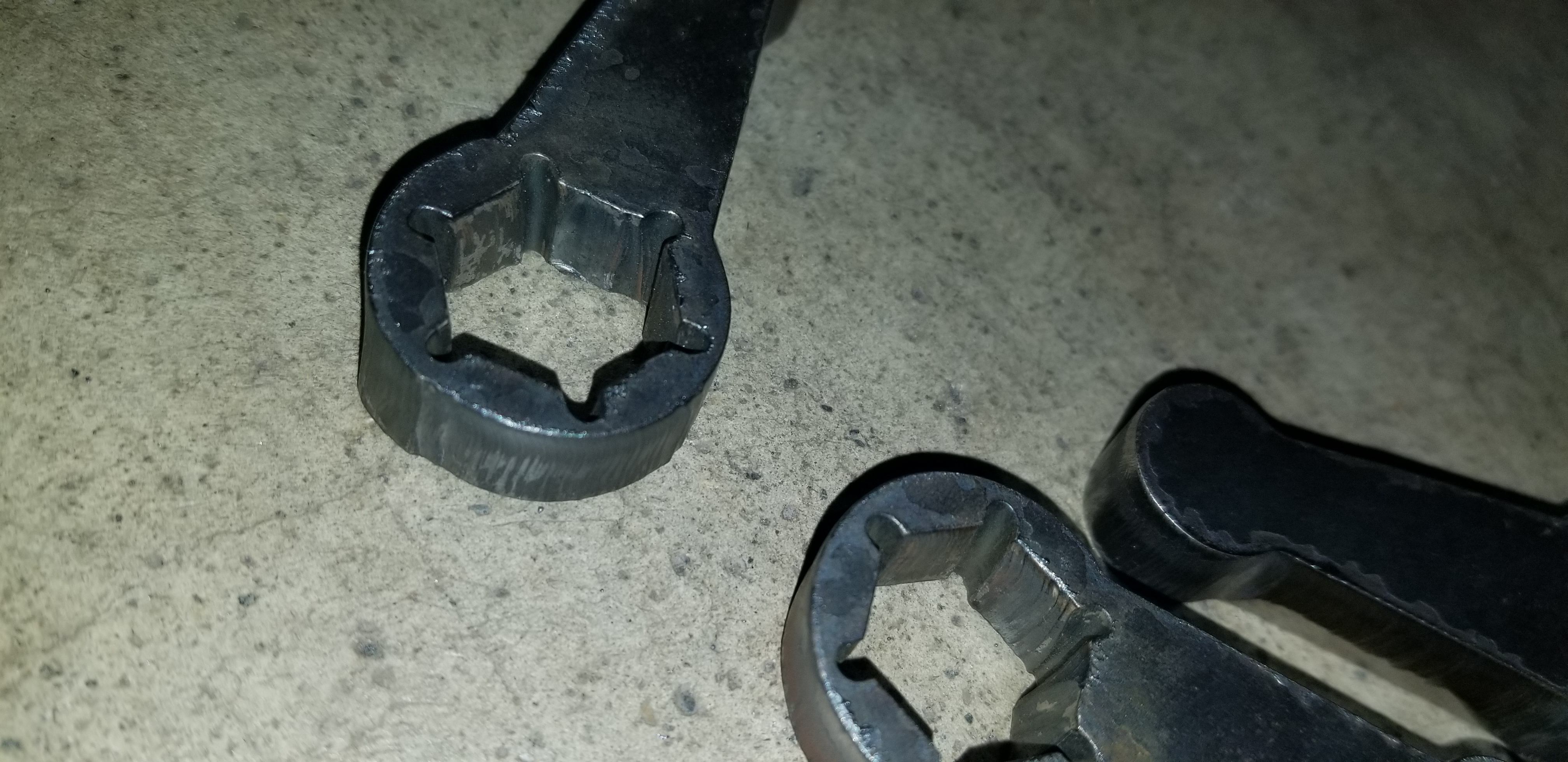

Hello all,
I continue to have taper issues. I have checked my torch alignment numerous times and have had others do so as well. I have even intentionally put it out of alignment and still had taper in the same location. I have tried new consumables in varying degrees of replacement, only part I haven’t tried replacing is the swirl ring. The parts in the pictures attached were cut out of 3/8" with a 65A nozzle, speeds on the curve were altered a little from cut to cut but that didn’t change the amount of taper. What was consistent, despite some changes in cutting speeds on the perimeter, was the location of the bevel and reversed bevel with respect to the table. The edges to the top right have excessive bevel and the bottom curves have excessive reversed bevel. I know based on this it should be Torch alignment, but when purposely put the torch out of alignment it is the same. Any ideas?
