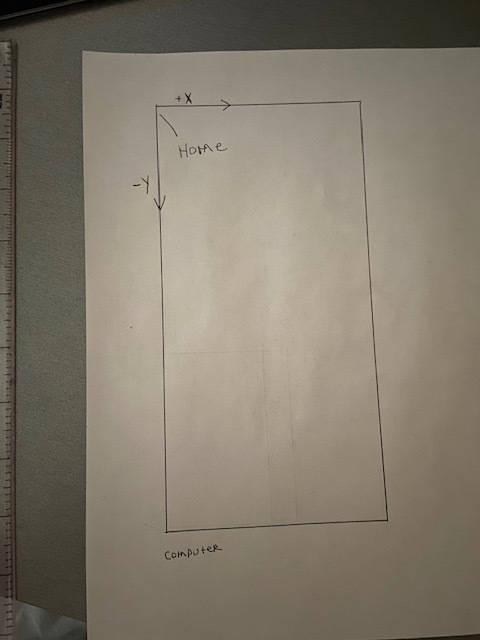

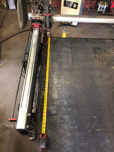

This is how I would program it. On an index cut I program from the sketch and not a solid body so I can break the lines where i will have my index. on my Pro I do it at 32.5". For you I did it a the 77" that you wanted. I went back into the design environment and added a solid sketch line at 77 inches. I also rotated it the so it is in line with the table for easy of keep track of like @TinWhisperer posted. After that, with nothing selected I right clicked on the sketch in the browser, not the actual sketch itself, and pick the slice option, then click the line that we added at the 77" mark. this breaks the lines at 77’ so we can use that as the origin for the second cut. Also if you were cutting the outside profile it would set it up to program the lines in the open contour section on the 2d profile.

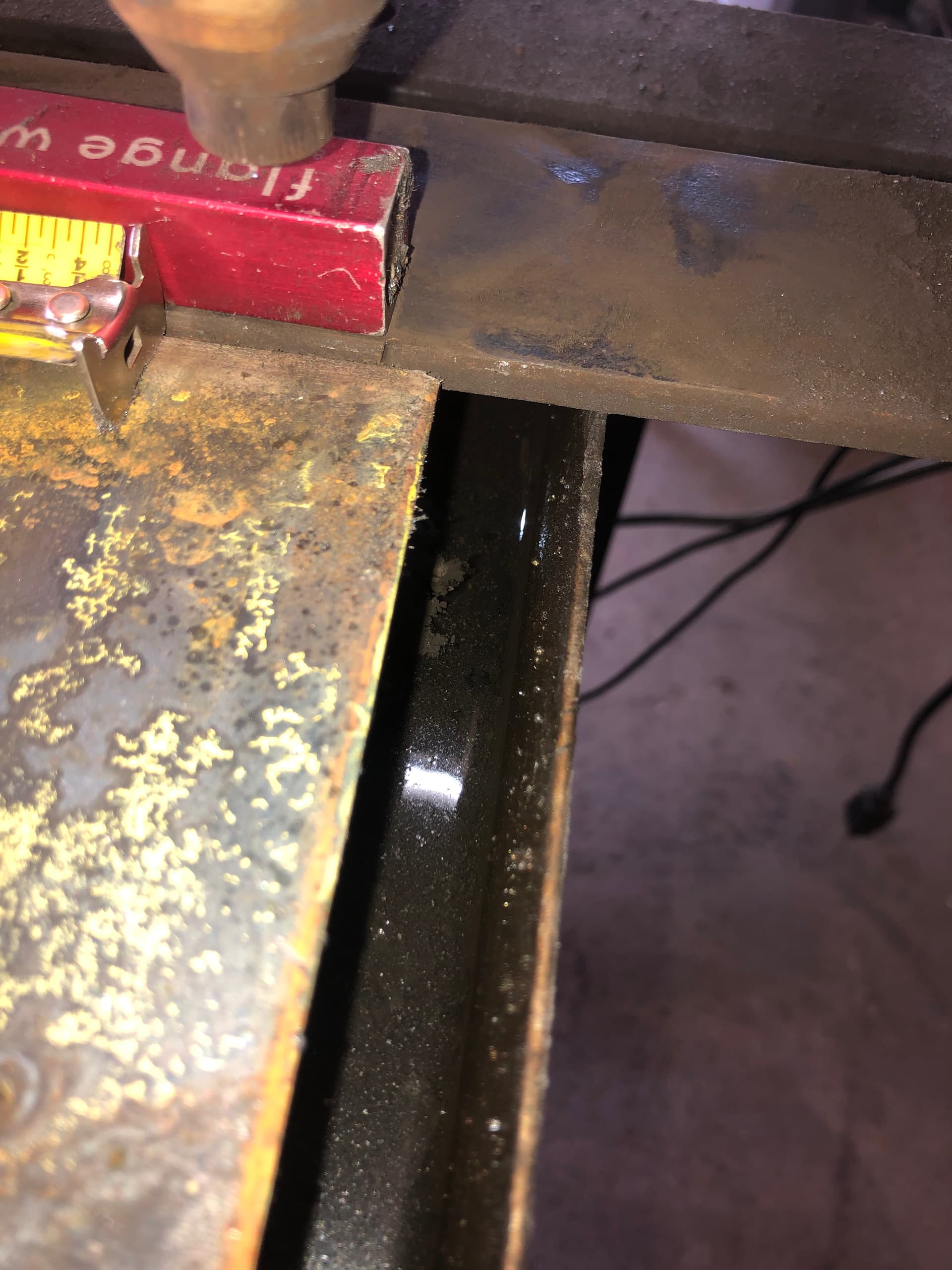

I set the stock to the actual size. I use a fence I made that runs up the Y axis on my table so I have a constant zero for Y. This way when stock is set to fixed size it will be in the same spot on the Y each time and you can focus on just the x axis.

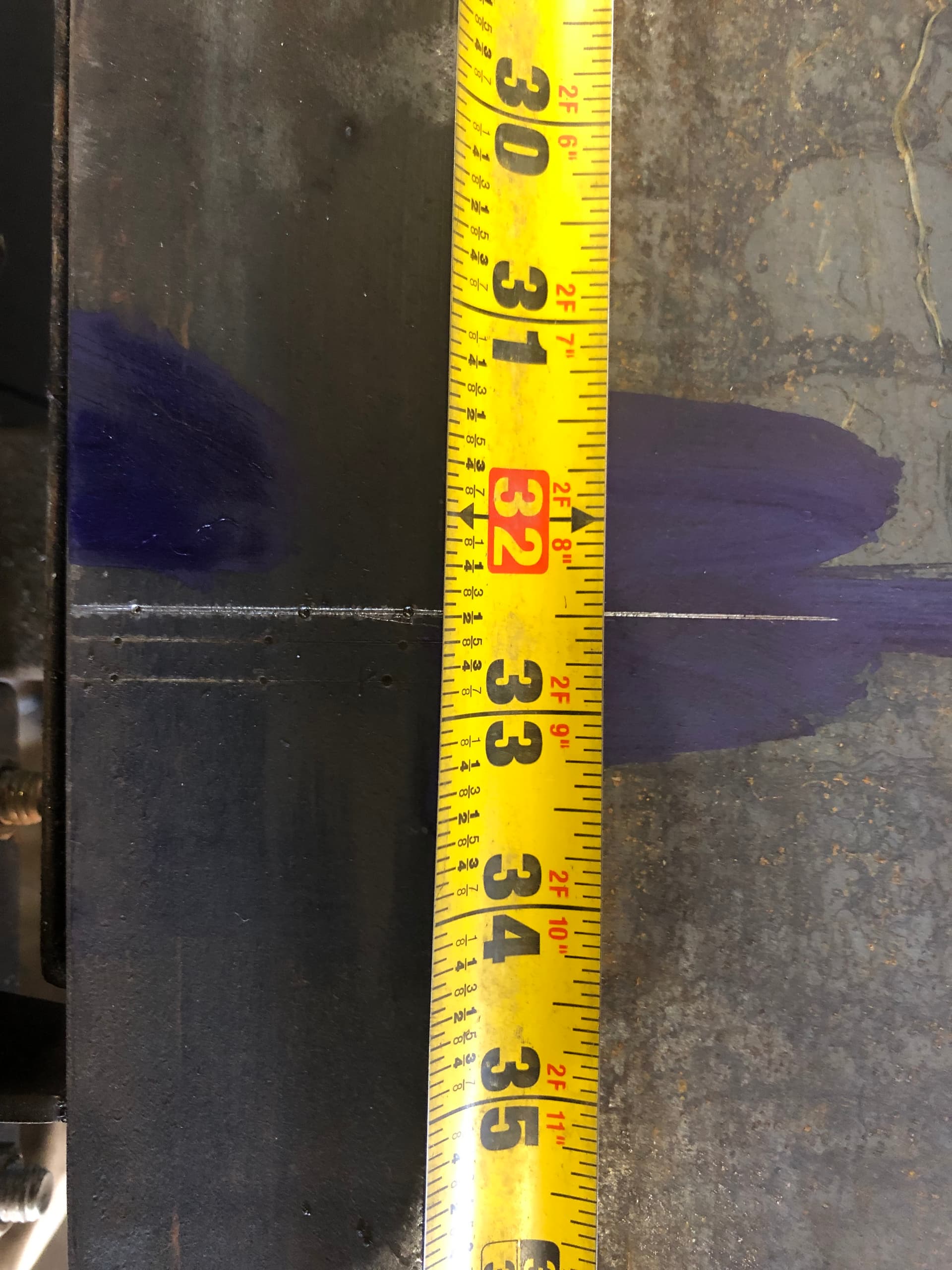

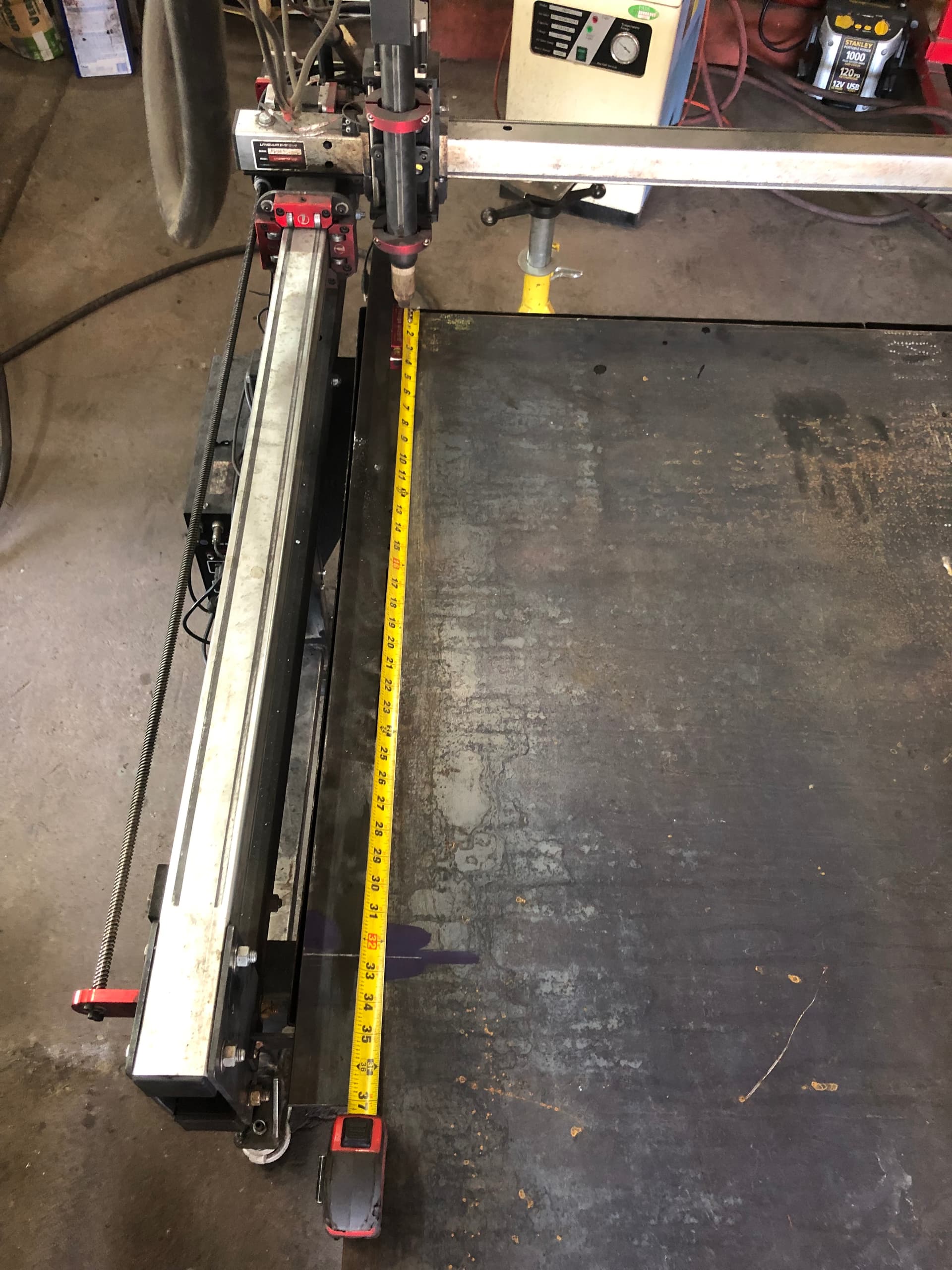

Here is my last index cut. It’s 3 programs which is 2 moves after the first cut program 81" in the Y plane. I have my origin set at the home position then measure down the 32.5" and scribe a line on my plate. I have the zero/home portion scribed on my fence. I run first program then slide the plate down to line up scribe lines and repeat.
Ok here are the two files I have came up with, I did do a dry run and both seem ok. @Bigdaddy2166 I still have 34 more dry runs to be safe but thought I would see what you guys think of the two files.
The 1st setup (1st NC file) will will run and cut the first half of the sheet and stop. I will then move the sheet ahead and line my index mark (at 77" 1/2 way mark on sheet) up with my X home position.
At that point I will run 2nd setup (2nd NC file) and that should cut the 2nd half of the sheet.

in your file you are cutting the wrong direction . ( Profile 1,3,4 )
Counterclockwise for inside shapes
Clockwise for outside shapes
Sideways Compensation LEFT must be selected
Plasma-Cut-illustration-REV
You will want some feed optimization added to these tool paths. (Profile 2 & 3 )
in Profile 4 you are missing your retract height from the heights tab in the 2d profile menu
I see what you did. you lowered the overall feed rate for these smaller opening . Smart move :bulb:
You wouldn’t need to tell anybody!!! :rofl:
Looks like you need to change your sideways compensation in set up T2 and both T3 and T2 in setup 2. I believe it should be set to left compensation. Is that what you see @TinWhisperer?
