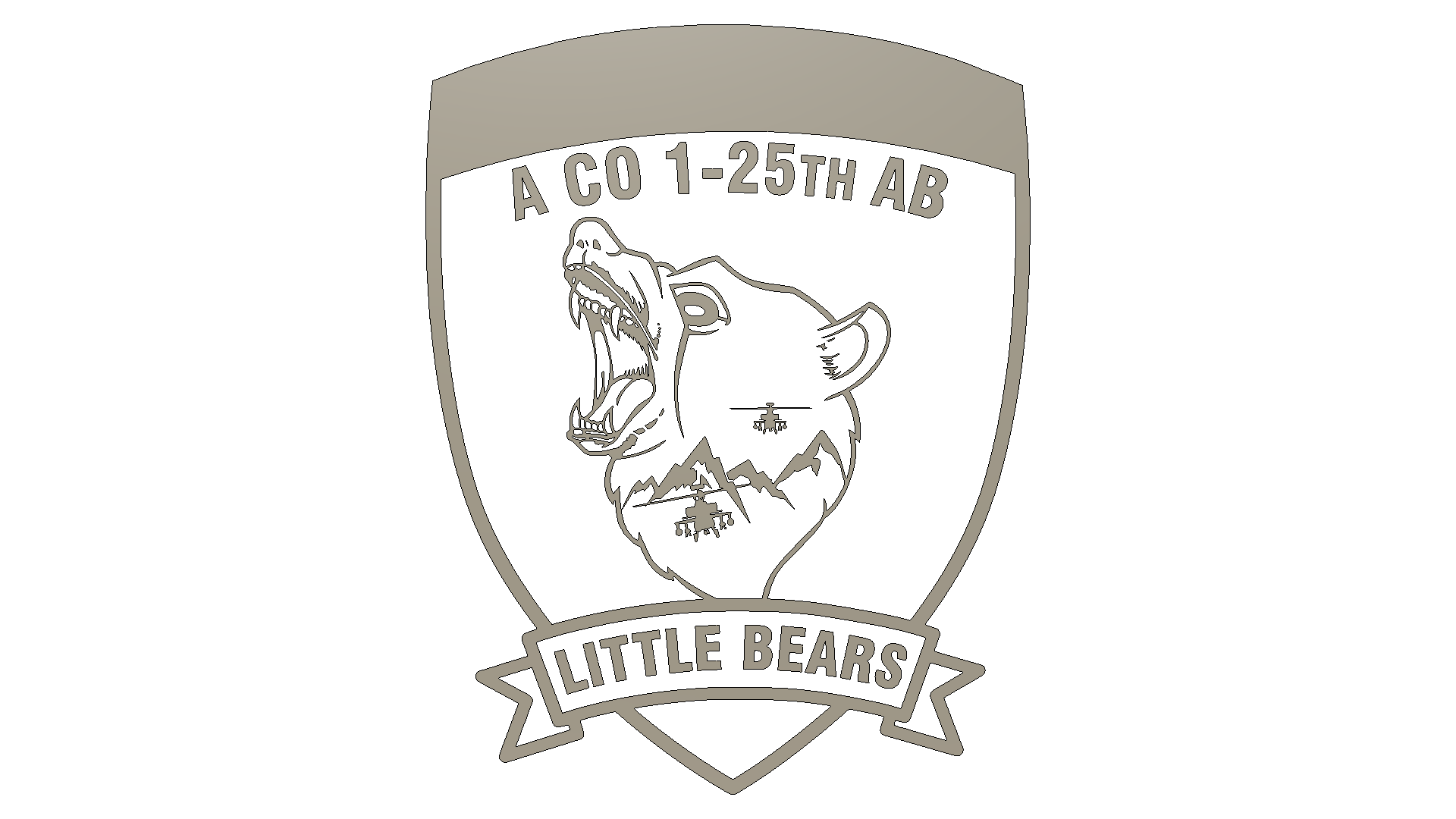

I am attempting to make a sign for my BIL of his current company patch. Fusion was very slow after I loaded the SVG. So I went to Inkscape and found out there were thousands of nodes. So I simplified the image to reduce the amount of nodes. Now in fusion I need to make a cuttable file out of it. I posted the FD3 so you can see what I mean. Any help is greatly appreciated. I am still learning all of this

Thanks for the reply Tin. Here is the original picture I started from.
Oh wow prefect I will definitely be able to make that work.
Both my kids are home sick we are hanging out watching TV I could stream how to do this but I would have my sound off and running music instead of narrating.
Give me a few minutes and I’ll figure it out.
No mic today but we will walk through turning this image above into a cuttable file.

Some progess
Now How to Stencil it??
ends at 38 minutes

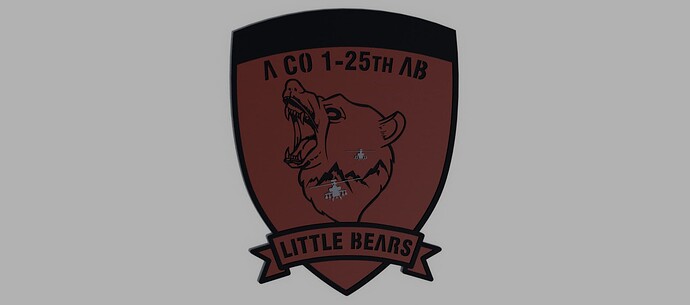

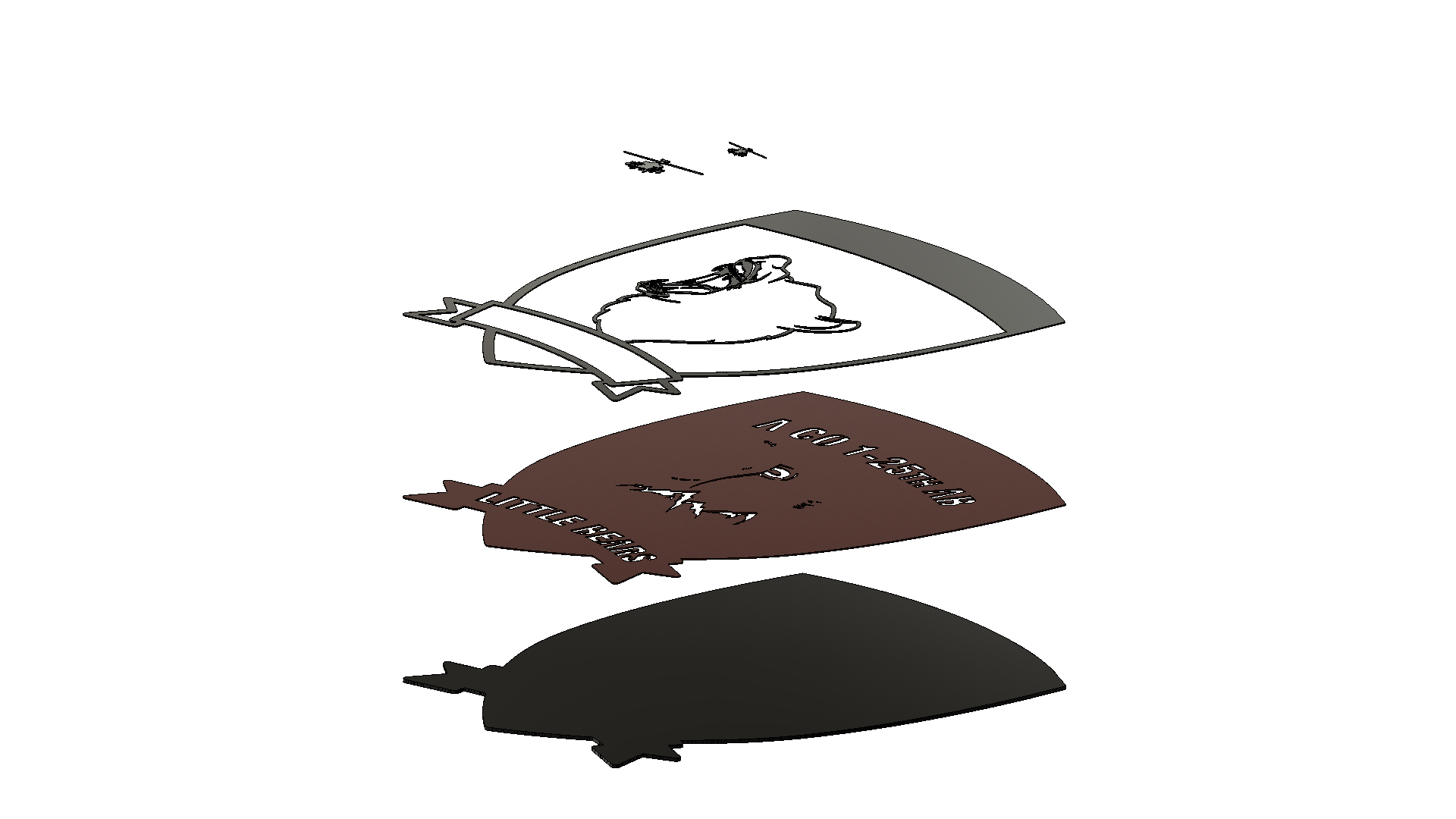

follow up. making a multi layer pcs out of this.
here is a multi layer design I put together. See if this maybe the direction you are going with.
3D model and Fusion 360 files
Wow. You are awesome tinwhisper. I will watch the videos later tonight. That is awesome. I will open it up in fusion and let you know how it turns out within the next couple days. I did just plan to make it a one cut design. That 3 piece is slick. Thank you so much for the help
