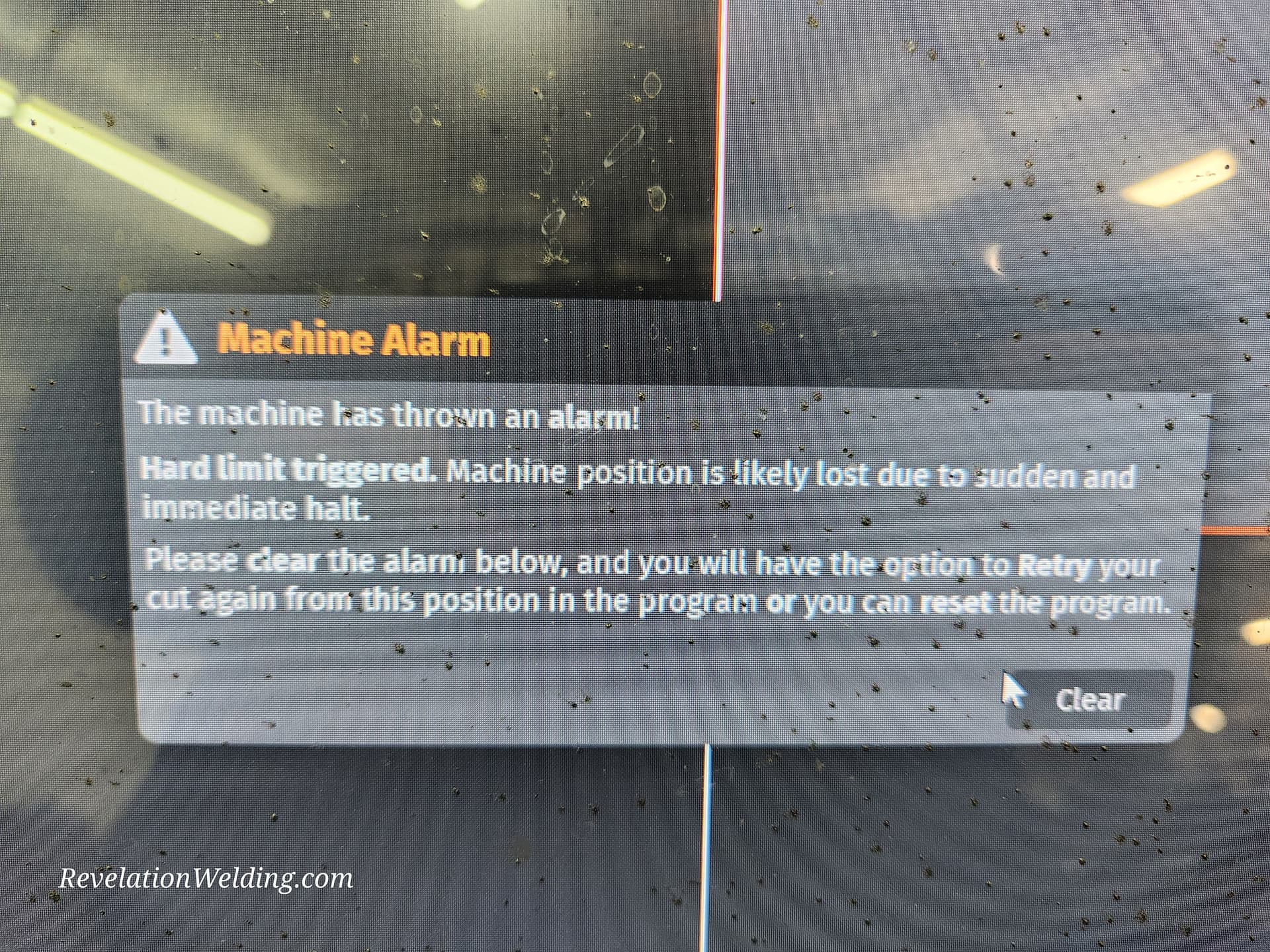

Hard stop alarm
I have had nothing but success for the better part of a year with my table. Came in to the shop this morning to cut a file and the minute i went to drive the Y axis to set a new zero i get the hard alarm warning. The table will now only move an inch, then throw the warning. Seems like its specifically coming from the left side (computer station). When all powet is un plugged the gantry moves freely. No catching. Is this a bad limit switch, motor, or what??? Im at a loss after doing some troubleshooting.

A hard stop can be a problem with the lead screw or the lead screw nut. It also can be a power issue. Try the switch thing first. Report back
Checked the lead screws and all corresponding hardware. Also turned off the limit switches. Still catching almost immediately after drying to drive it

X moves fine. I was trying to problem solve this before disassembly of the gangry to check the motors out. It seems to be just the left side. Swapping the cables doesnt change anything. Its just staying with the red light of death now. Cant get it to move at all.
Check the pins on the control box power supply output inside to see if you have 36vdc. The power supply my not be putting out the correct voltage to run two motors.

That may be the culprit. Not getting good voltage at all. I think the power supply is toast. Any links to where to get a new one?

One set of pins had fluctuating voltage which i would assume is the issue. The others were stable but still low. I didnt want to mess with it when one set of pins wasnt even working properly
I keep a spare on the shelf. I have gone through two in five years. This is an issue for many guys. The trim pot gets Jared, and the voltage goes from 36 to 24VDC. Then, the motors get really weak and stall. The trim pot is very, very sensitive. The slightest jar can change the supply’s output. The origial unit is 360 watts @ 36 VDC. You can find larger wattage units but they won’t fit inside the enclosure without moving other shit inside. Make sure you set the switch on the side of the supply to the correct incoming voltage. My case its 120v.
I had this same problem. After changing the screw rod and motors it turned out to be the limit switches. You almost have to think of limit switches as a consumable.
