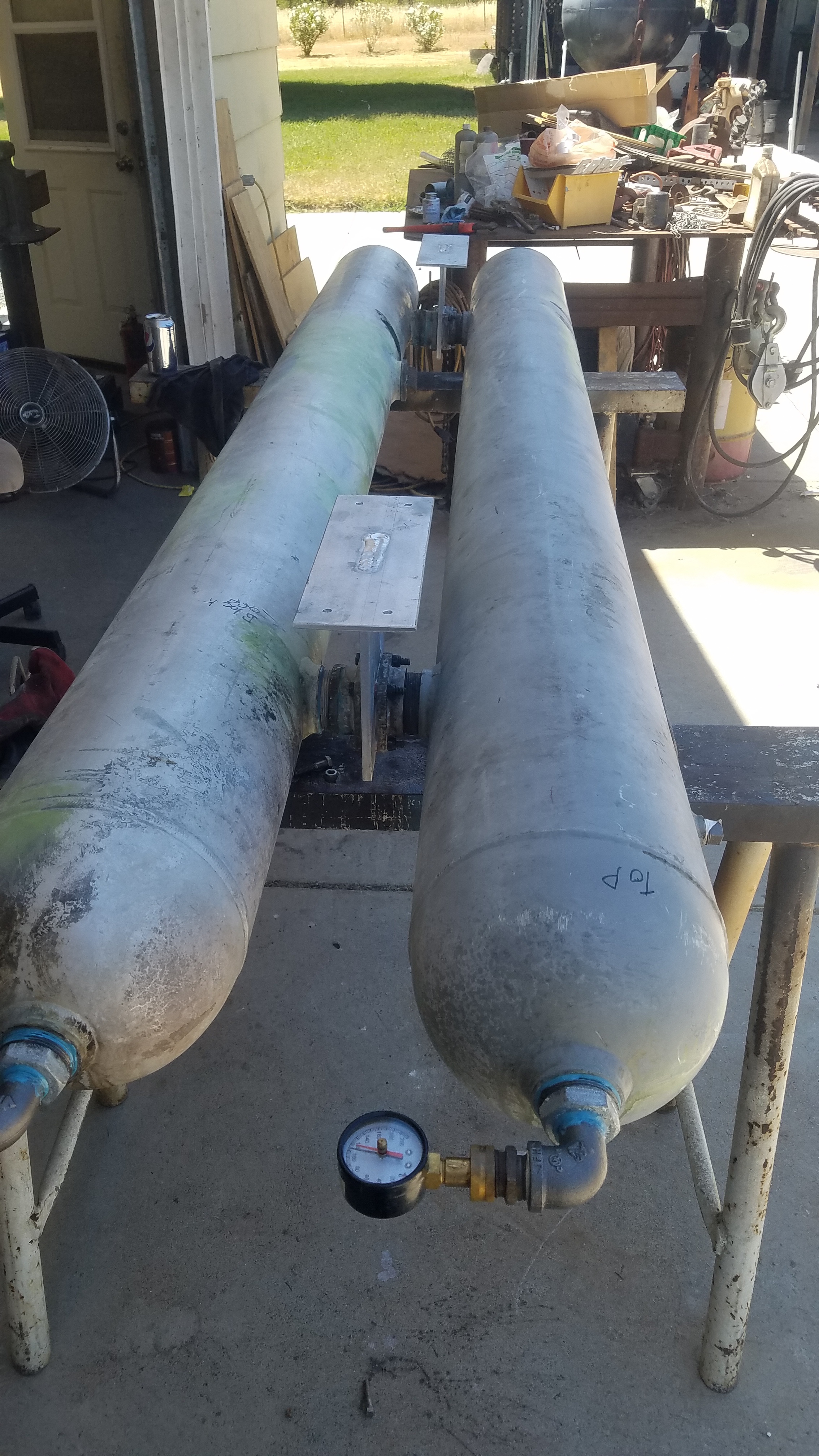

mounting these verticaly next to the 60 gallon compressor, they are out of a BART train 21 gallons each
air goes in the top of one and down to the next tank, then out the top. should help with water
Does this mean there’s a BART train somewhere running without braking capability? :laughing:

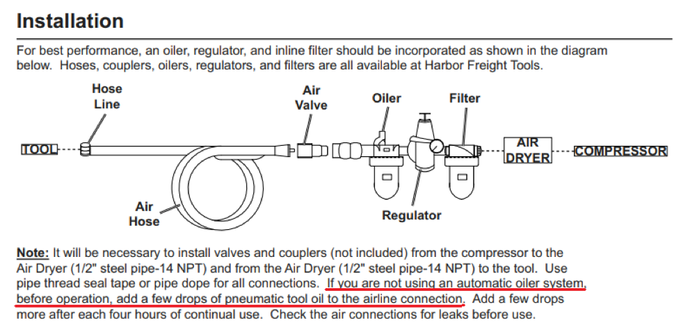

For those of you running the Harbor Freight Air Dryer are you installimg an oiler to the inlet like the instructions say.
I am not. You would need to remove the oil before it got to the plasma cutter.
Notice, that only pertains to compressed air tools. In the diagram it is after the air dryer so it has nothing to do with the actual dryer:
The instructions say to add the oiler AFTER the dryer, not before. And, as @ChelanJim points out, that’s only for tools that require oilers. Plasma Cutters (or Paint Sprayers for that matter) do NOT fall into that category.
I totaly missed that was just reading the undelerline . Thank you. Should have paid close attention the picture
