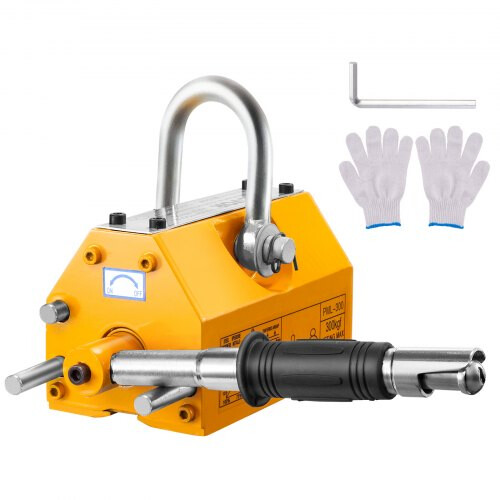

VEVOR Magnetic Lifter, 1320 lbs/600kg Pulling Capacity, 2.5 Safety Factor, Neodymium & Steel, Lifting Magnet with Release, Permanent Lift Magnets, Heavy Duty Magnet for Hoist, Shop Crane, Block, Board Amazon.com
I use one of these. The one I have is rated for 2200 lbs. It picks up a 5x9 1/2 A36 plate without a problem.
Of course, you don’t need one that powerful.

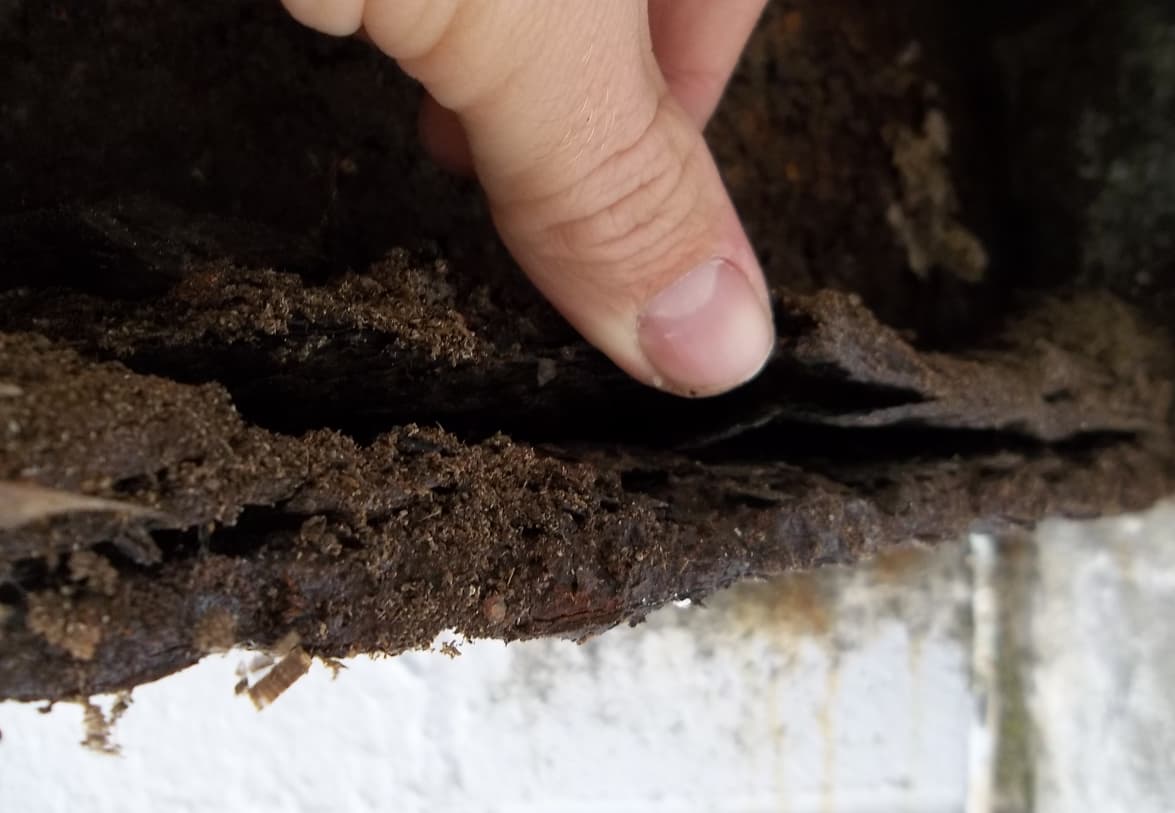

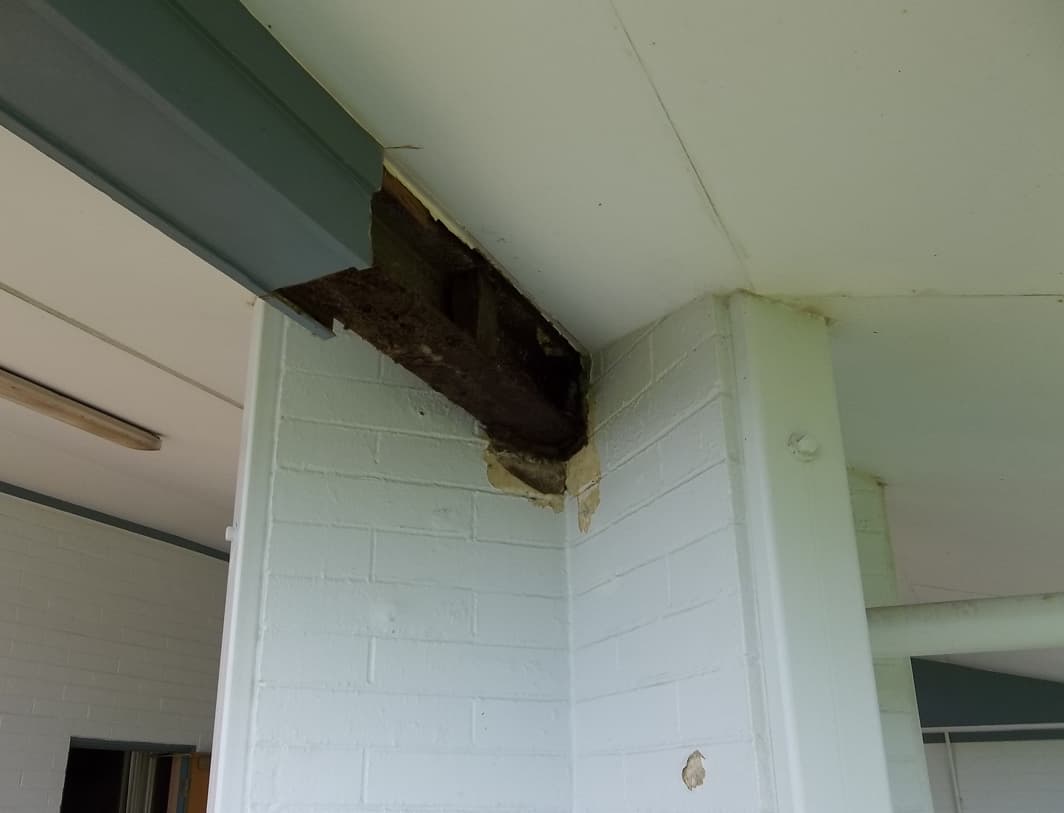

The IBC requires steel exposed to the elements(ie not in a conditioned space) to be coated. As @Knick pointed out even when coated it’s just a matter of time. Especially in the coastal areas.
I posted these a while back. Taken from a building I was doing a structural evaluation on in Hawaii. Pretty common there. I’m sure there is allot of this type of thing in FL as well. :grimacing: you don’t want your name on something that looks like this. :stuck_out_tongue_winking_eye:
Edit: if this is a new building or a permitted renovation I’m pretty sure the coating will be in the SPEC.

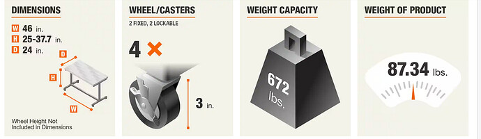

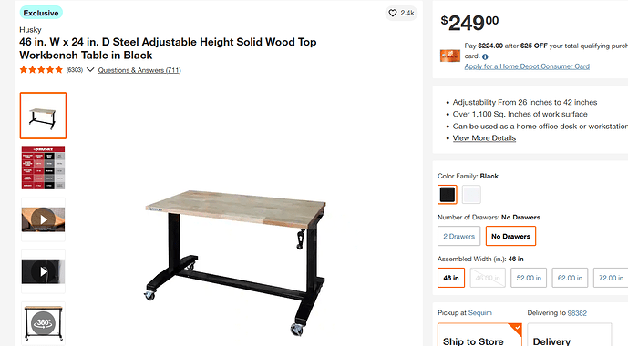

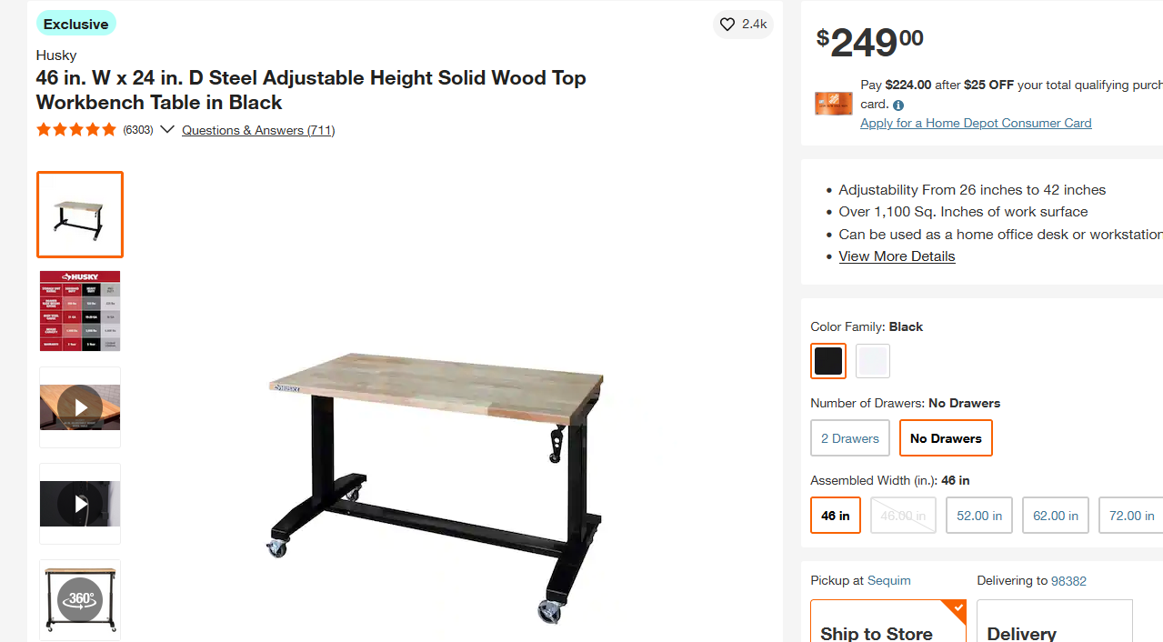

For 10 gauge mild steel 4x8 sheet I use this table with adjustable height, by myself (no problem). It has the weight capacity for the 1/4" 4x8 sheet (~350 pounds). I added 4" wheels vs the 3" wheels that came with it. Specs included below.
I use these as well. I believe the load rating is based on 1/4” material. The thinner the material the less holding power the magnet will have.
Yeah you do if you are only using one. I use two…always. Not enough meat on the plate for the magnet to stick to, and once the plate starts to bow, it lets go in short order.
I use my service truck crane to move the plate around. Dropped more than one due to the bowing and sudden stops when moving with only one magnet, and anything thinner, yeah buddy it pops off easy.
Let me clarify, yes it can and will pick up a sheet (just one) but for safety reasons, especially if you are lifting this up more than 2’, it is better to either have two magnets and balance the load lengthwise, or use “F” clamps and a lifting chain.
