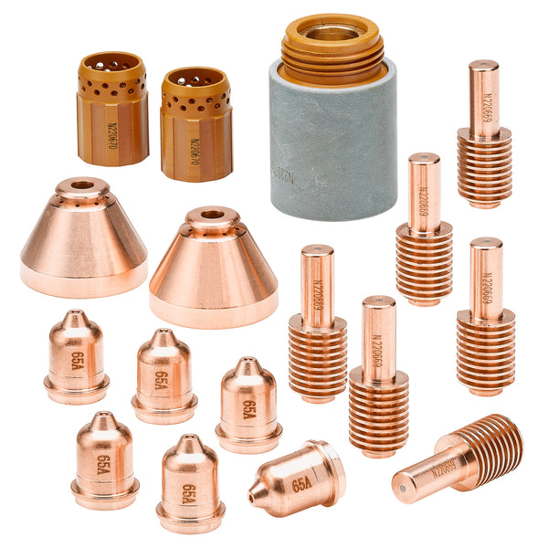

Torch is UPM 105
Consumable stack is:
Swirl Ring
Electrode
1.1mm nozzle
Retaining cap
From this assortment:

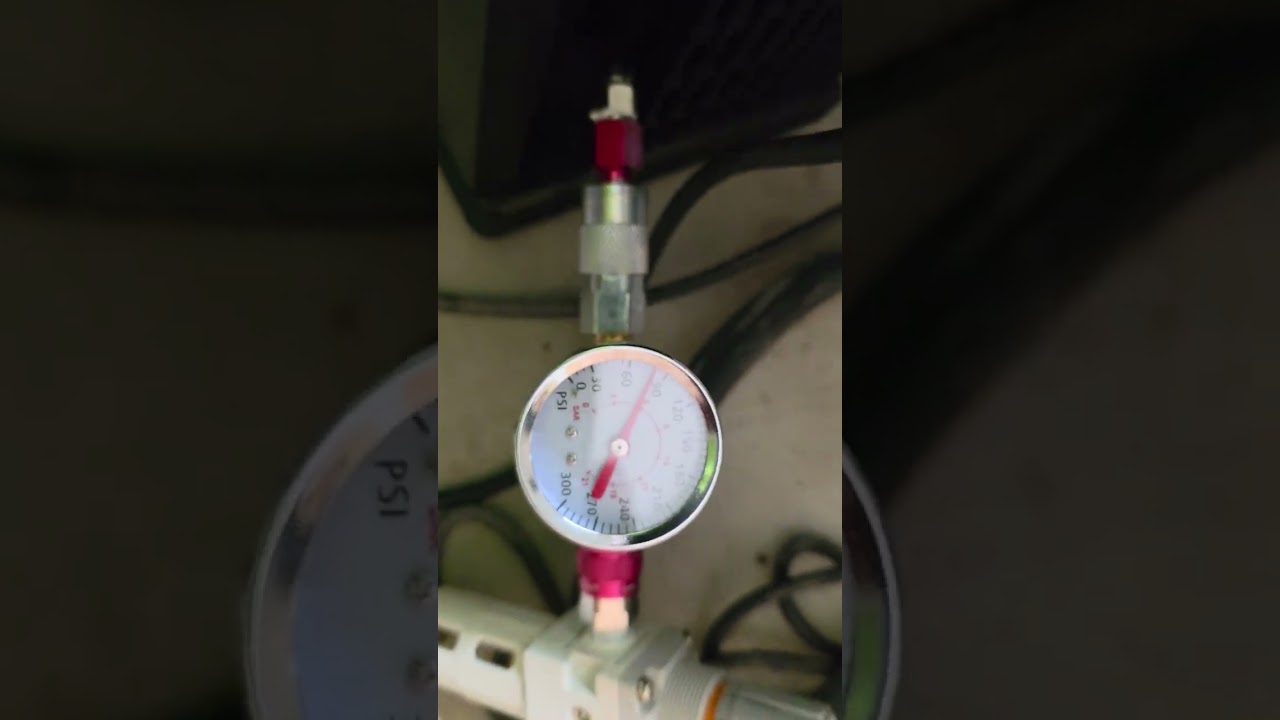

The Primeweld E04 error code usually means there’s an issue with torch/air pressure or internal component fault, often related to low air pressure, moisture in the air line, or a problem with the torch consumables (like the electrode or swirl ring), requiring you to check air supply, drain your compressor, ensure correct consumables are seated, or sometimes perform a hard reset by power cycling the unit or shorting specific pins. AI question answer, so take it for what its worth. Not quite sold on it just yet.
Not Primeweld guy, but there are plenty on here.
The solenoid chattering on and off?
No. Solenoid opens to let air out and then doesn’t do anything until it closes the air at the end of the burn/should be burning cycle.
I just went back and listened to the video, you are 100% right Tin the solenoid is absolutely machine gunning. That tells me this is without question an electronics issue, although I was already in that boat based solely on the air pressure transducer not reading correct pressures.
Solenoid chatter or relay chatter is almost always caused by insufficient voltage being delivered to it.

Also the UPM105 will need about 10psi more then the hand torch to work properly. You should have 100 to 120psi to the back of the plasma cutter and 75psi flow pressure to the torch.
PSI is 70+ to the torch head, as for the mounting location I will take it apart and move it. I don’t know how that would affect the E04 readings but if it’s not supposed to be mounted on that part of the torch I need to move it. Gene did reach out and said he’s shipping a new upgraded unit and a UPS return label so hopefully the upgraded unit is ready to go. I think I just happened to get a machine that was missing one piece (the board for the UPM torch) and had another part that was malfunctioning (the air pressure sensor). Just dumb luck that this all happened while I was so sick, not having a functioning table the past week has had zero impact on me.

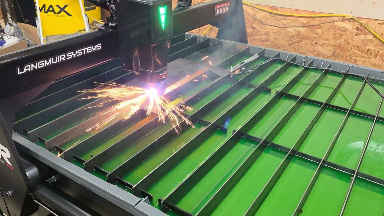

All that being said, I received the new unit from Gene yesterday and had time to install it after work. Works like a dream now! No more E04, no more machine gunning solenoid just proper operation. I did notice I’m going to have to build a new feeds/speeds database though as it seems the Hypertherm style consumables aren’t going to require as much power for the same thickness cuts. Here is a video of the table making it’s first cut after hooking up the new Cut60. As always PrimeWeld continues to be the gold standard for customer service. If anyone is on the fence about going with PrimeWeld do yourself a favor get off that fence immediately. Now I just need to build the air drying/cooling system on the wall, move the table into it’s final position and top off the table with plasma green.
Be careful cutting with the water table that low on fluid. Might cut through
Absolutely, only test cuts until I get the table setup permanently. I made sure to keep it off the seams and a fairly low power cut with 14 gauge. Anyone here know if the longitudinal braces across the bottom can support the table if I get a pallet jack under there to move it? I figure with the amount of water in there right now the table is probably sitting at maybe just over 1100 pounds. I’ve got a pallet jack that would make moving the table super easy but last thing I want too do is collapse a brand new table.
