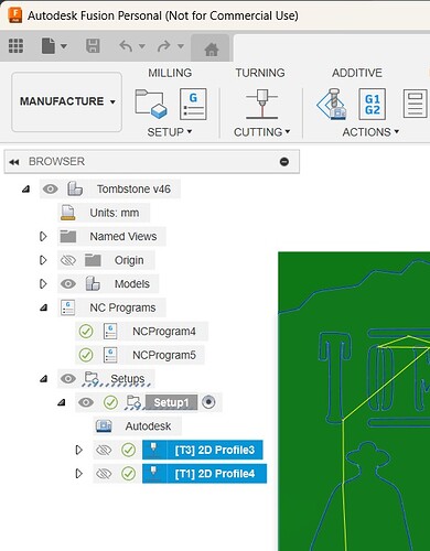

Did you create multiple 2D profiles (cut paths) in an attempt to include all the geometry? Likely you have multiple 2d profiles and you only post processed 1 of them.
As 72Pony said, if you want everything to cut in a single pass/program, make sure you highlight all the Toolpaths BEFORE you hit Post Process.
Or make sure you have the setup selected (highlighted) which has all those different profiles you want under that setup. In this case setup 1.

Looking further into your design, a couple of things appear:
1 - You have Pierce Clearance set > 0. Set it to 0. It doesn’t do anything positive when Plasma cutting.
2 - You have no lead in / lead outs set. I would strongly recommend some sort of lead in, perhaps .03" on 140 degree arc, to get your pierce marks away from the finished product.

I extruded your design, then made a new Setup (setup 3). Selected the face, enabled smoothing, and a lead-in. Simulates fine.
That works beautifully in Fusion! Am I able to see the seetings you used after you hit Okay?
Hearts and love simsworx.tap (19.0 KB)
Unfortunately it doesn’t quite work when I post and load into Mach 3. Thank you, again, for all of your help. I’m 57 years old and this is quite unusual to feel so lost.
All of the settings should be visible if you open 2D Profile3. I suspect the largest issue was that you had a Pierce Clearance set, which I changed to 0.
