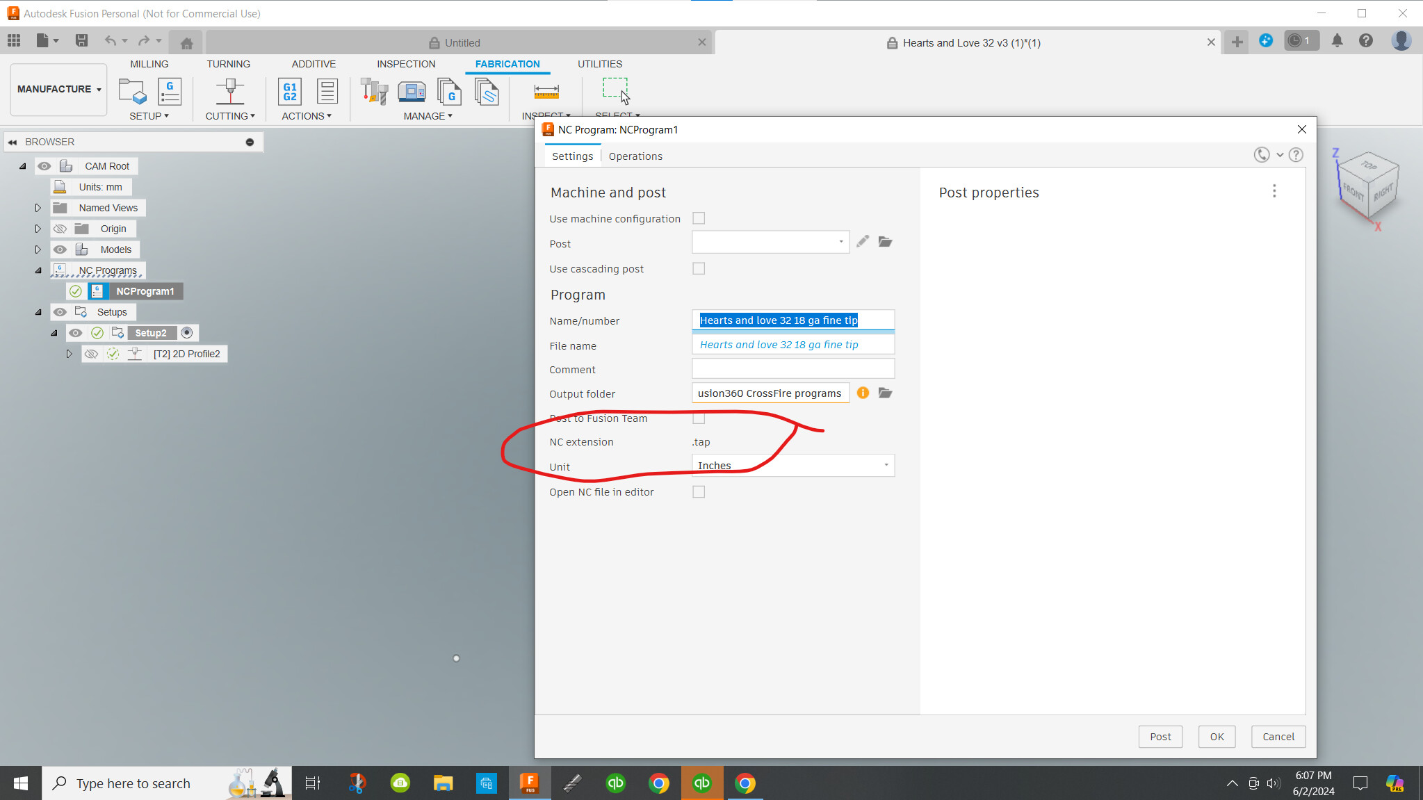

The Pierce Delay is set to 1 second in your tap file. Be sure to follow the steps to set Post Properties.
Did you see this?
No. I have to say I am not really with it enough to use the computer. Under the weather with some sort of crude shared by my loving wife: The gift giver!
But the problem I have with that screen shot is that no post processor has been selected.
That’ll happen if you edit an existing post, but do not have the post processor installed. (From an exported .f3d)

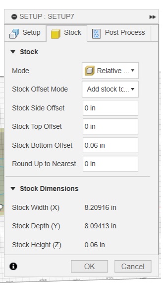

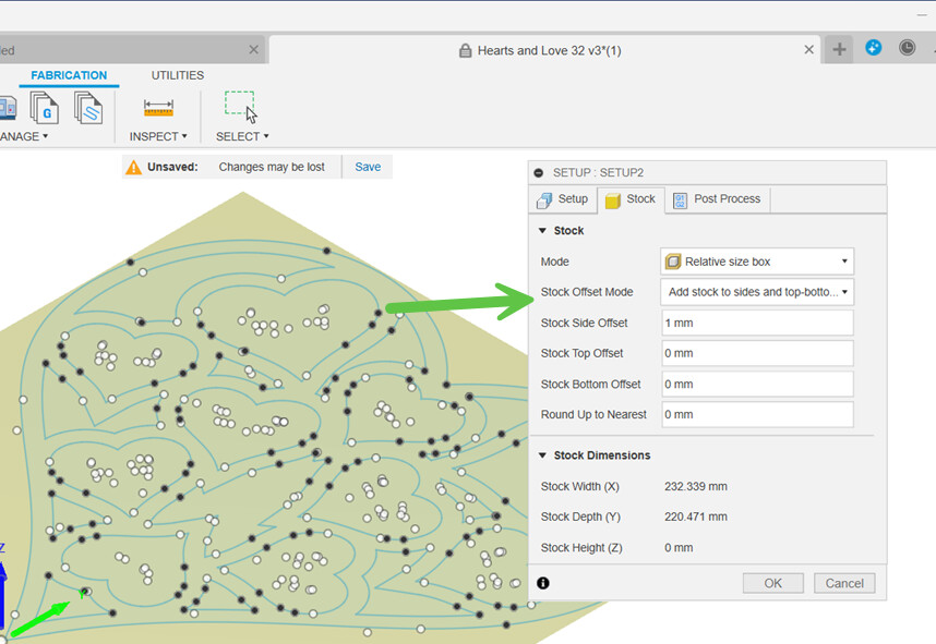

I downloaded your .f3d file. You have the settings in the Setup set incorrectly. “Stock Offset Mode” should be set to “No additional stock”. This is likely the biggest cause of the issue you’re having.
Do you have a licensed version of Mach3?
The demo version will only allow 500 lines of code.
Thank you very much! That was one of my problems. I’ll have to make 2 saves with half of the cuts on one and half on the second? Or I’ll have to buy the full version

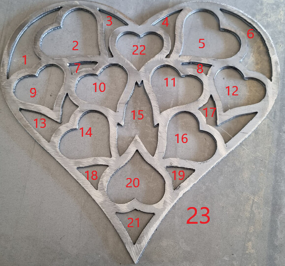

Thank you so much for all your help simsworx! I put my smoothing tolerance to .09mm to get the code down to less than 500 lines. Next time I might try one cut of the hearts and another cut with the other shapes and the outline. Under geometry you only have 1 face contour. When I did it I got 23 closed chains. How did you do it differently?
In both cases there are 23 closed chains:

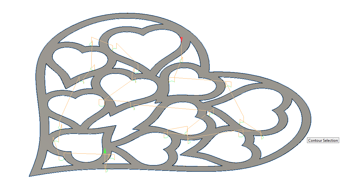

Every time the torch is directed to move and cut, that is one contour.
You got 23 individual contours because you clicked on each contour. The secret between picking the “face” and the contour is that you want to zoom up close enough that the mouse is not confused of whether you are clicking on the face or the actual contour. You don’t want to click on any contour…just the face. Fusion will then figure out all of the contours to be cut.
Ask questions if this doesn’t make sense.
Normal image without any selections in CAM:
Image change when face is selected (then entire thing turns a lighter gray):
Image when a contour has been individually selected, it will be outlined in black even before you click with the mouse:

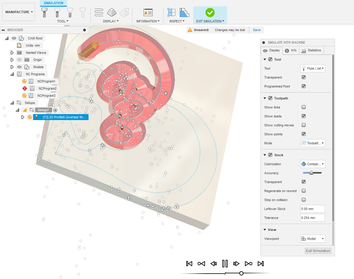

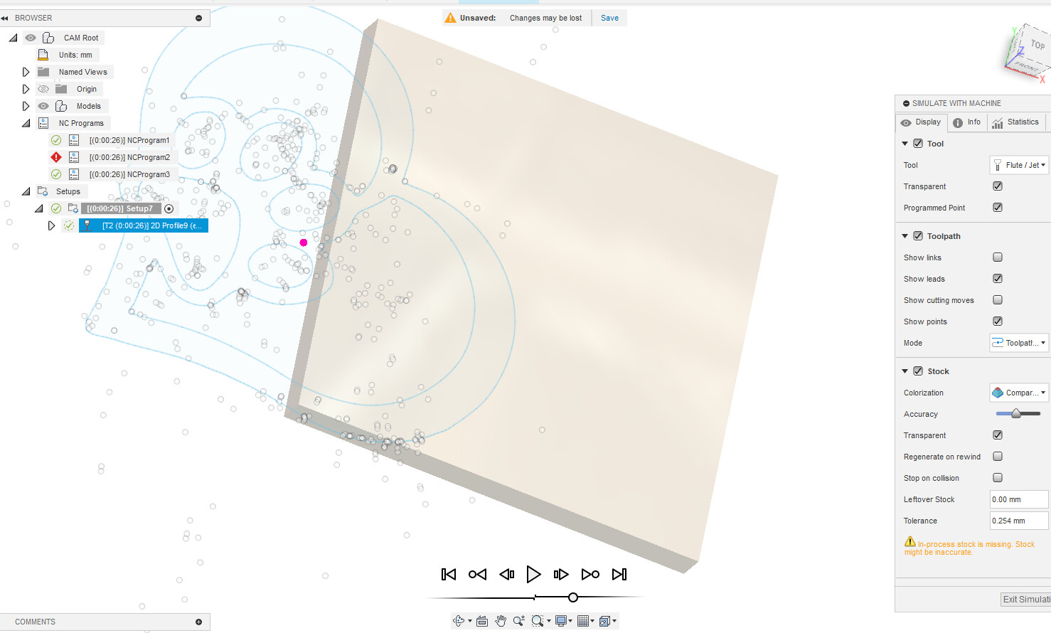

I don’t get it. I started a new piece to cut. I used the same settings as the hearts and love, as a guide, but I can’t seem to get rid of the holder+stock error. When I ignored it and sent it to post, the path in mach 3 looks nothing like the simulated cut in fusion.

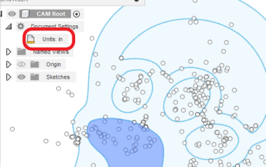

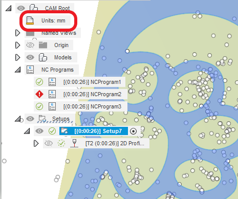

I did not do a deep dive on this but you have inches and mm spread all through this.
Here is your design page (Inches):
Here is your manufacturing space (mm):

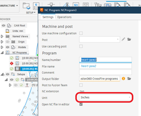

Here is the NC Program settings in manufacturing (inches):

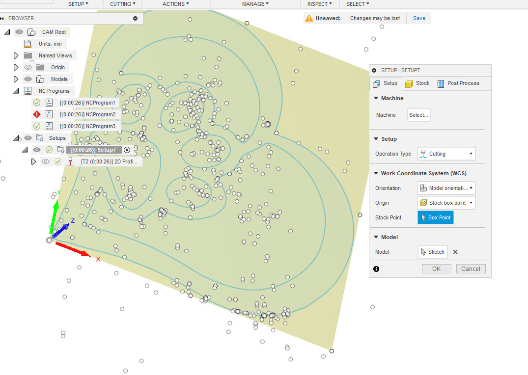

You also have the overlapping rectangle/box happening in the simulation again because your drawing and stock are not lined up at the same point:
Move the box point to the left lower corner:
Now the simulation is happy:
But I hesitate to help you further. I really recommended that you draw a simple design of your own. Perhaps a box with a heart shape. Make sure your units are consistent and take it to manufacturing. You need to get the basics down instead of trying to cram a drawing into a perceived formula. You are going to frustrate the heck out of yourself. You need to be learning the nuts and bolts of how the drawing goes from design to CAM to post processing and then to Mach 3.
One of the other things noticed, in addition to what @ChelanJim mentioned, relates directly to the stock. By not extruding your design, the sketch lies directly on the Z Axis plane. When stock is defined in Setup, stock thickness will default to +Z Axis, placing your sketch / design under the stock. Change this by setting 0 additional Top Stock and adding a Bottom Stock Value.
This cleared the Stock + Holder errors I was seeing.
