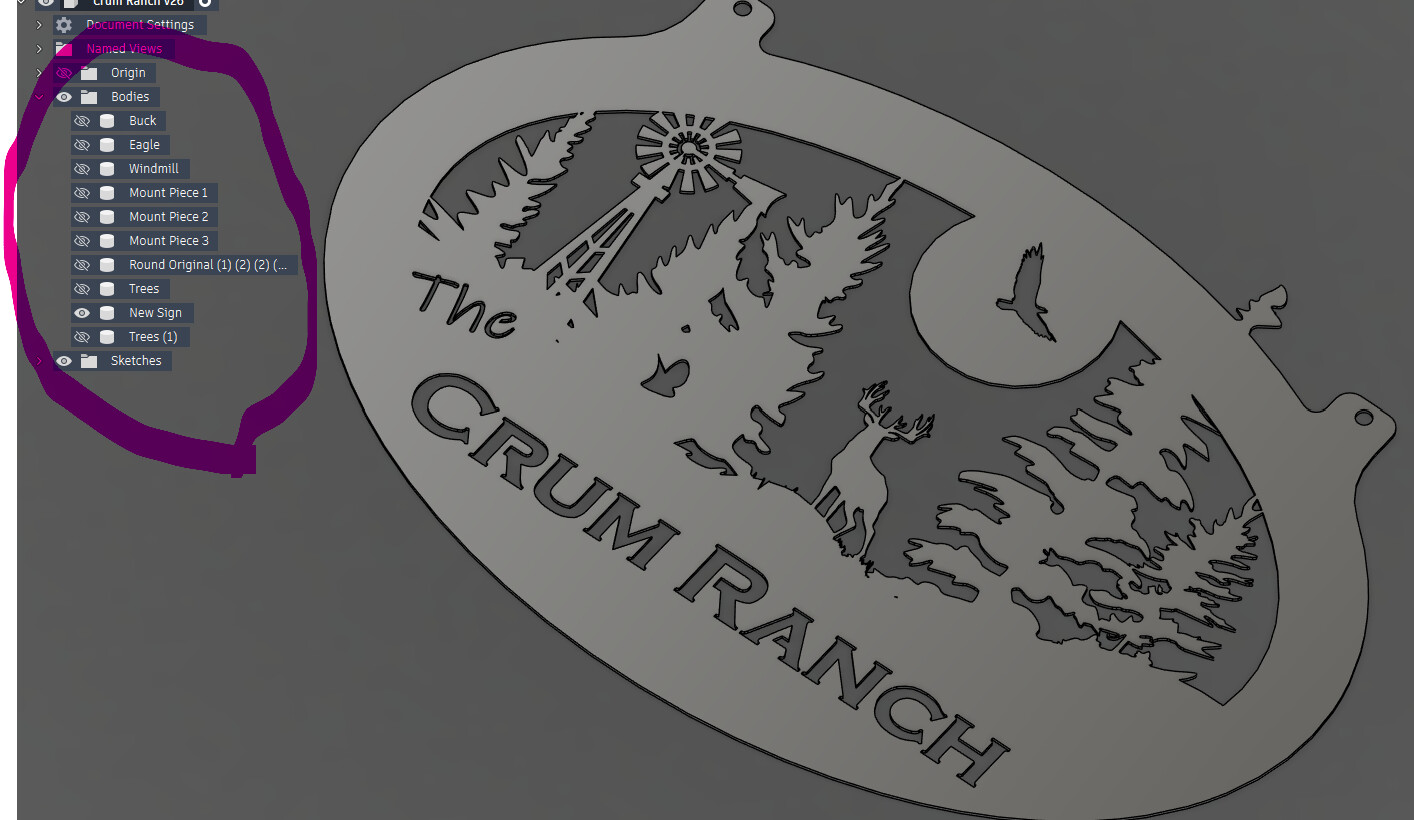

Here is one example as you can see I have many bodies that eventually created the whole.

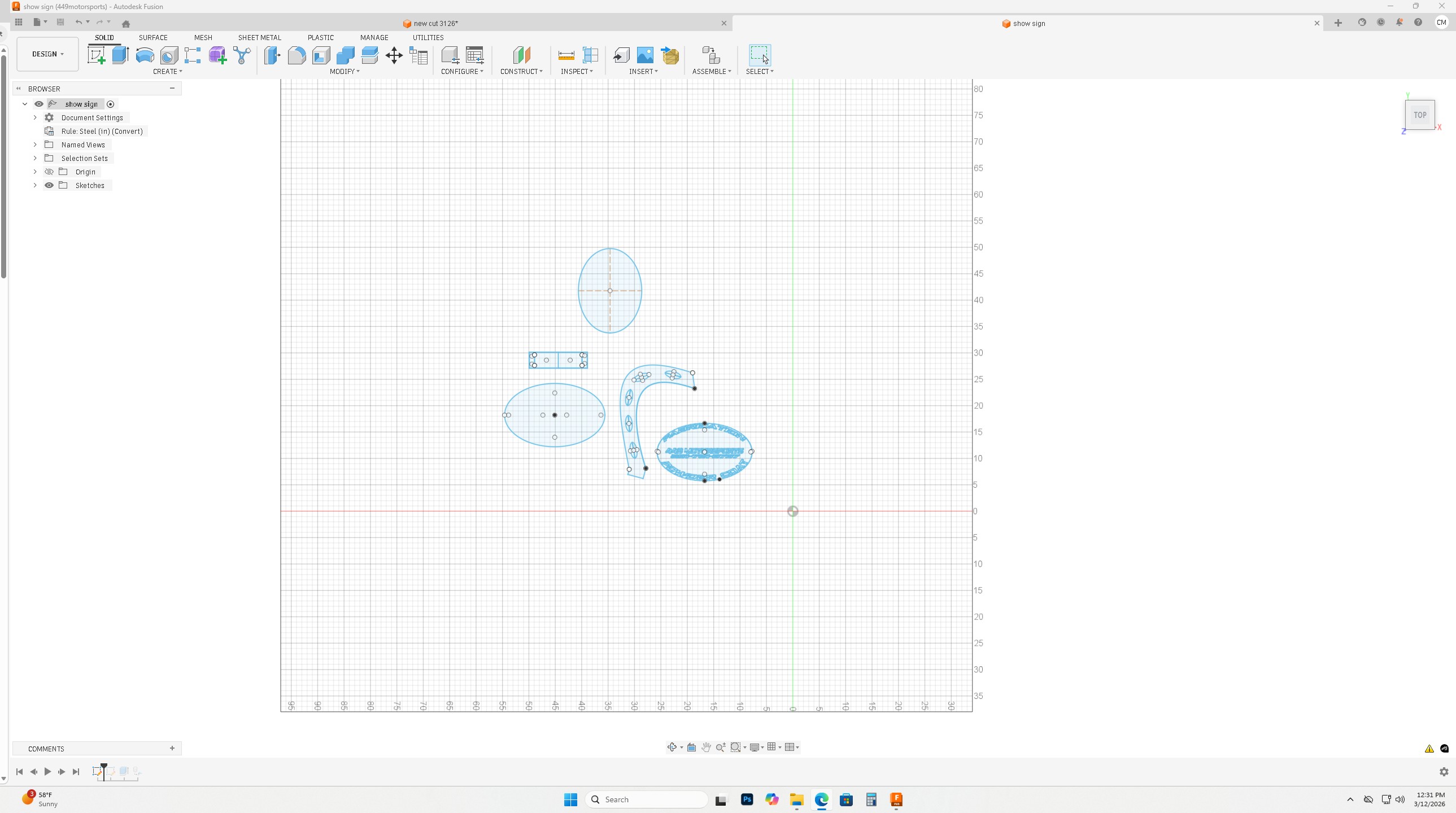

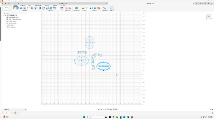

this took almost 4 hours to make because it tool fusion 4 to five mins to come back from not responding for each line made the drawing is only 146 kb leaving it as a sketch should not be an issue with a file that size
There are quite a few nodes in drawing…fusion treats each one them as parametric entity so each change requires the program to work through each one - every time a change happens..
So make your life easier. Extrude them into bodies and you will see a big speed difference as each of the many drawing nodes becomes one entity (a body) for the program to deal with.. Or in your case 4 bodies.
If you can export and upload that particular file I’m sure we can help you with some workflow walkthroughs.
