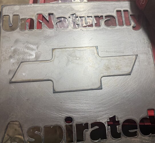

Did a quick test …… im going to go through and fix the lettering if I plan on making more signs
What? It cut the wrong font now. Lol
What are your cut settings and what cutter are you using? The heat discoloration makes me think you’re going too slow
I redid it in a different font …. I’m also using max amperage … probably unnecessary. What settings do you usually use for pierce height etc
Cut height 0.04 , ish spring back .009 P height .15
I use a hypertherm 45xp and I’m very close to their book specs, except pierce delay. What material are you cutting, what speed, and what plasma cutter do you have?
16 gauge sheet metal , titanium 45 at 45 amps …
My settings on crossfire pro table with titanium 45 cutter for 16-gauge steel is 195 IPm, .06 cut height and .15 pierce height. I cut everything with 45 amps. I have machine torch.
