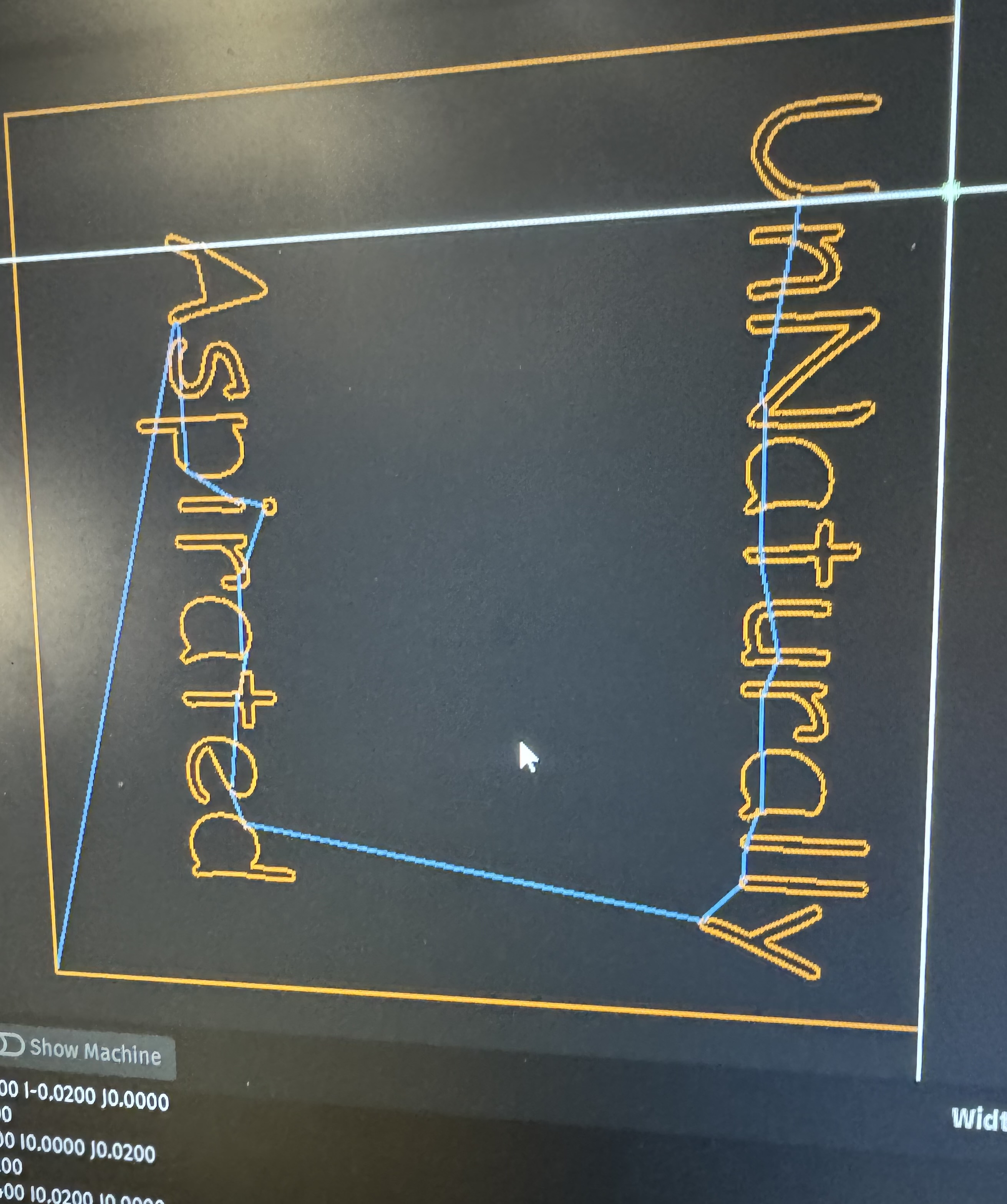

This is so weird , if I flip it 90 it will cut top and bottom but the letters are flipped

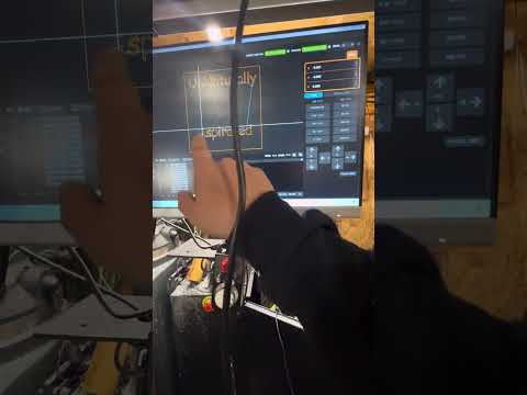

Your file … I’ve been doing a dry run . The video will be too big to upload here . I line up on the corner , it will rapid and start cutting the bottom . Then rapid underneath and start cutting what’s on top . Maybe I can make a YouTube video
Are you looking at your table upside down? Can you post a video?
There is a possibility that your visualizer is not keeping up. Are you watching the torch and see that it is skipping all those letters or are you just watching the visualizer.
If it is the visualizer giving you this information, perhaps that needs a re-install. There has been lots of folks having their visualizers shut down and most of the them get up and running again with re-installs but others are needing to resort to the stable/older version of FireControl.
I’m almost certain you’re just oriented to the table wrong. Stand on the other side of it and run the program.

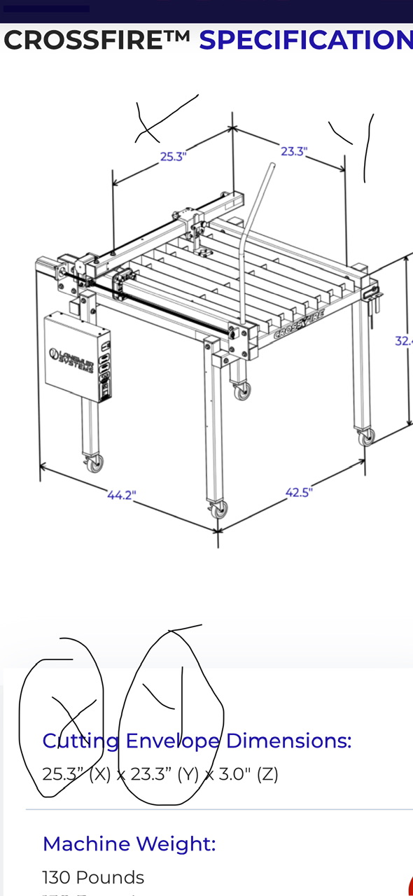

You are not looking at the table correctly, and you may have your motors plugged in wrong. You have your axis mixed up. On the crossfire, the X is what the torch is mounted to.
The “front” of your table is with the torch mounting bracket facing you. That is how firecontrol displays. So “home” if you have limit switches is the top left.
I was thinking that it might be that . So x is the gantry and Y is the other

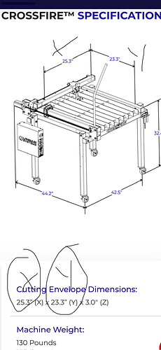

You’re killing me smalls. I gave you the picture. Although the picture looks like I drunkenly drew on my phone with my nose.
When did you start thinking you were looking at it wrong? The first, second, or third time I said it! Bah! I’m pulling my hair out over here. I want to see you cut that thing!
Go check what plug you put each motor to on the front box, turn the table 90 degrees clockwise from where you showed it in the video and everything will work.
