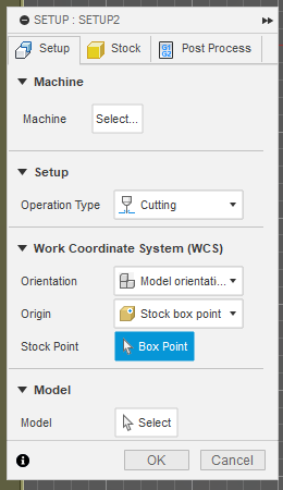

I deleted your setup. I believe your setup may have been on the wrong plane.
I moved the stock point to the left bottom corner:
Selected the face of the body in the Contour Selection:
Completed the selection:

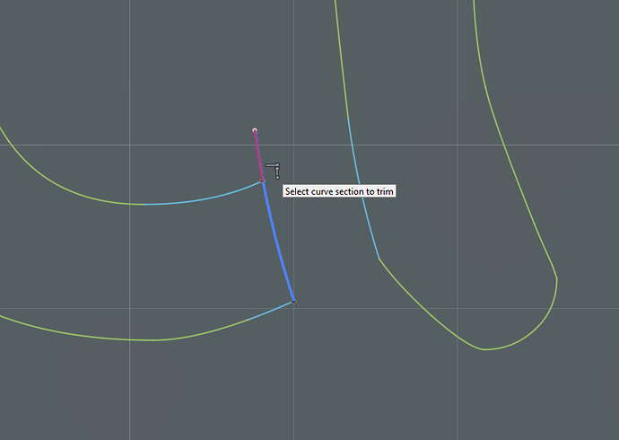

So lets talk about “bridging.” You will need to “Edit Sketch.” Then, you will need to “explode” the text to alter the lines. To do this you left click on the text, then right click and select “Explode text.”
Now you have the actual contours of the text elements:
Let’s look at the “a”. I will zoom in and complete an already established line. I then select my new line and do an “offset” of that line and move it a dimension that I feel will be adequate to support the center:
Now I extend the line if necessary:
Now trim away what is not needed:
Now you can see how the profile will register the center of the “a”
To make this work, you will really need to do all of your bridges, extrude a new body that shows these new bridges. Turn off the visibility of bodies 1 thru 8. Then go to “Manufacturing” and edit the set up because it was based on a body that we are not using. Select the new body here:
Edit the toolpath in the same way: Go to the contour selection and delete the current “face contour” and select the current body face.
Then you are golden:
