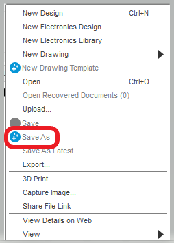

I am saddened to say that Fusion 360 has removed the ability to perform “Save As” from the primary menu bar for us Hobbyist users. I use this feature is when I really wanted to rework a current design but did not want to disturb the original design.
But all is not lost. You can still right click on the top item on the Browser tree and select “Save Copy As.”
My fear is: If AutoDesk felt the need to remove it from one menu, it will eventually be removed from all menus.

This is really weird: they have removed that little blue ball with the stars on the “Save As” menu item now and I did not update today. Same file and I have not closed/opened Fusion 360. This menu item is now available whether it is a new or old file.
So…never mind, I guess???
I must admit that I never tried to click on that menu item before, since it had the blue star ball on it. The other odd thing was the brown ball on the “Save” item.
I am now wondering if that was some artifact in the graphic card. Don’t know. :man_shrugging:

What’s the significance of the blue star ball?
It means that it is a feature only available if you pay. It is not available for hobbyist/personal license.
