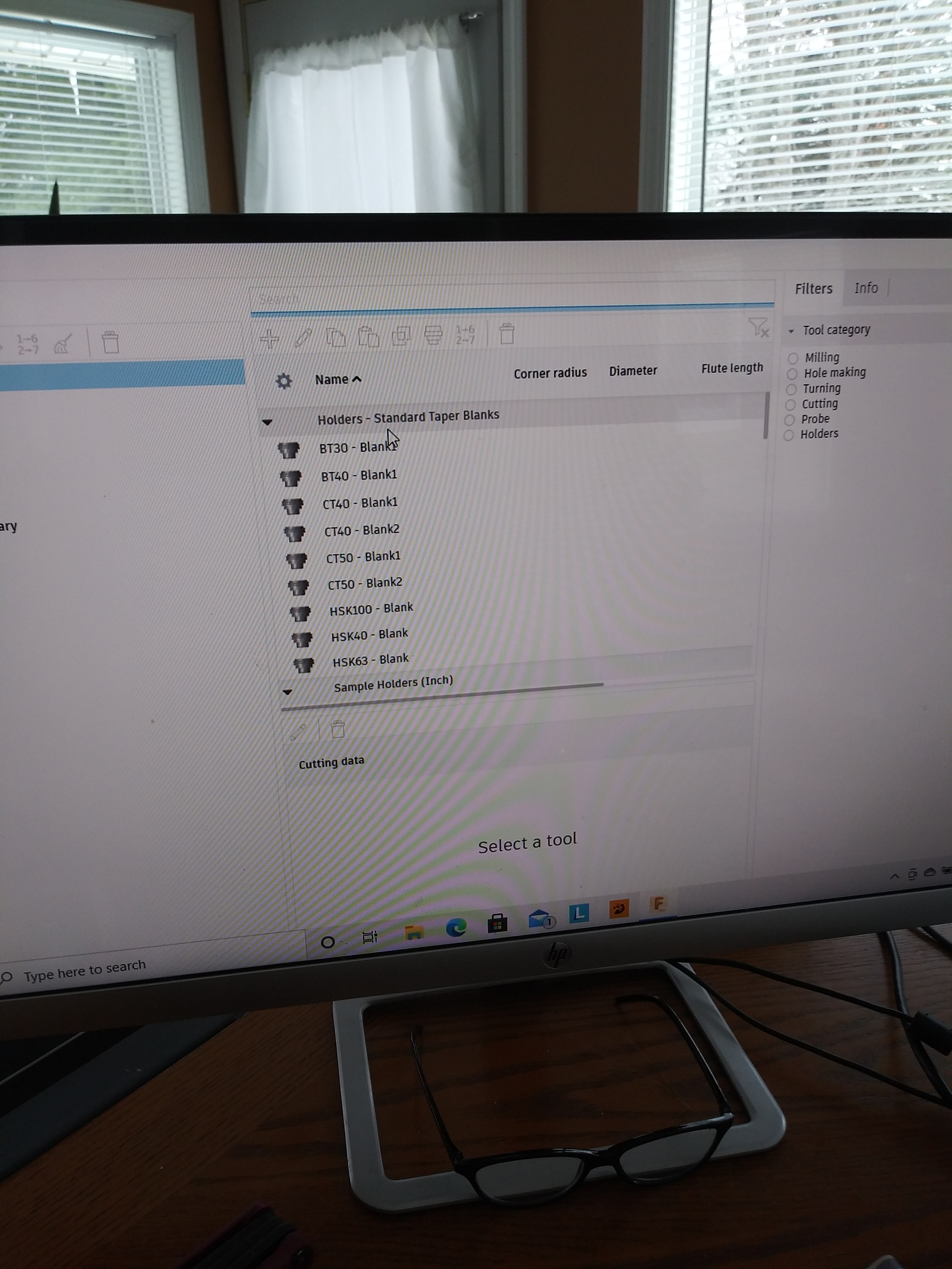

Looking for help! When I click on design and than the manufacture tab, and than click on the fabrication tab, and than I click on manage tab to bring up tool library, when I click tool library it brings me to a different page
any help please
What are you looking to do?
When I was watching the langmiur youtube video on creating a plasma cutting tool, as I went through the steps, his software came up different.
I think there a bit different now since fusion has updated but here’s a link to how to get it done.
Tool library - create a tool - Software / Fusion 360 - CAM - Langmuir Systems Forum
Once you select local library and it is highlighted blue, you will be able to click the “+” icon near the top of the window. From there, it should look similar enough to the process we show in our tutorial video.
