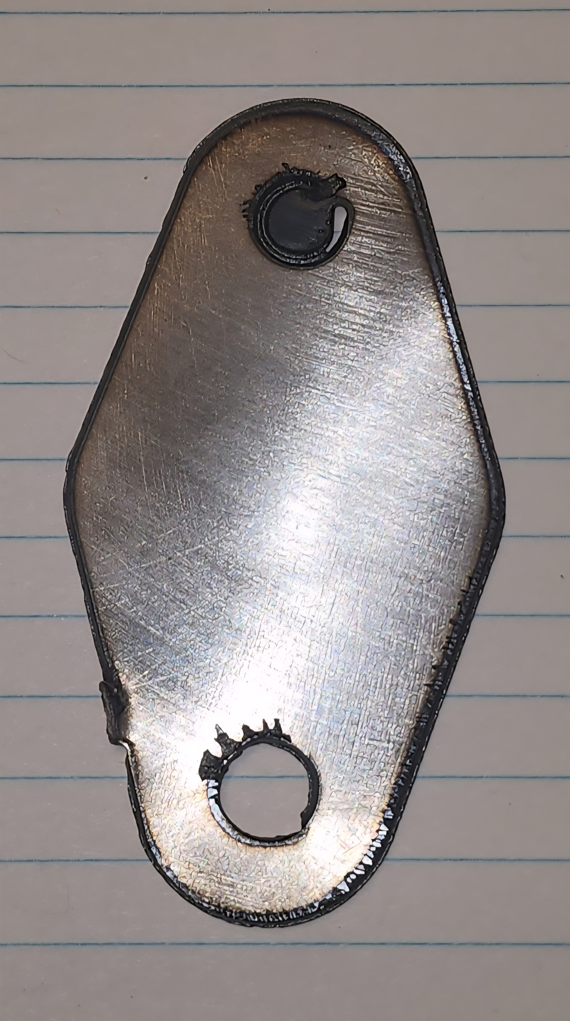

Any advice and guidance would be greatly appreciated. I am trying to cut 18 ga and for some reason some circles are not complete and there is a tab that is left even with the tab box not being checked. You can see the tab in the lower left hand corner. The competly cut circle was the first cut made. The incomplete circle was the second cut and the last cut was the outside but it was incomplete. When I run the simulation in cam and make the cutter translucent, it showes the cutter overlapping the initial cut befor continuing to the next cut and again overlapping entry point befor moving onto the final cut. It almost looks like the tab on the body is the same amount as the amount of the top circle

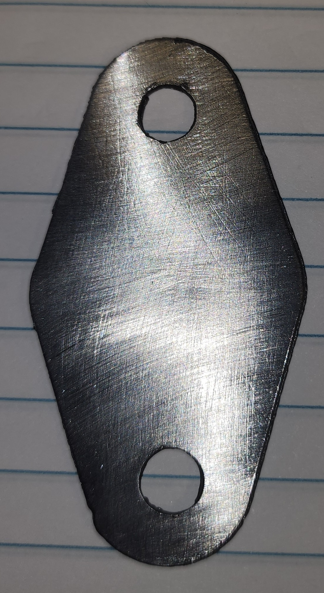

The failed cut is on the left the successful cut is on the right.

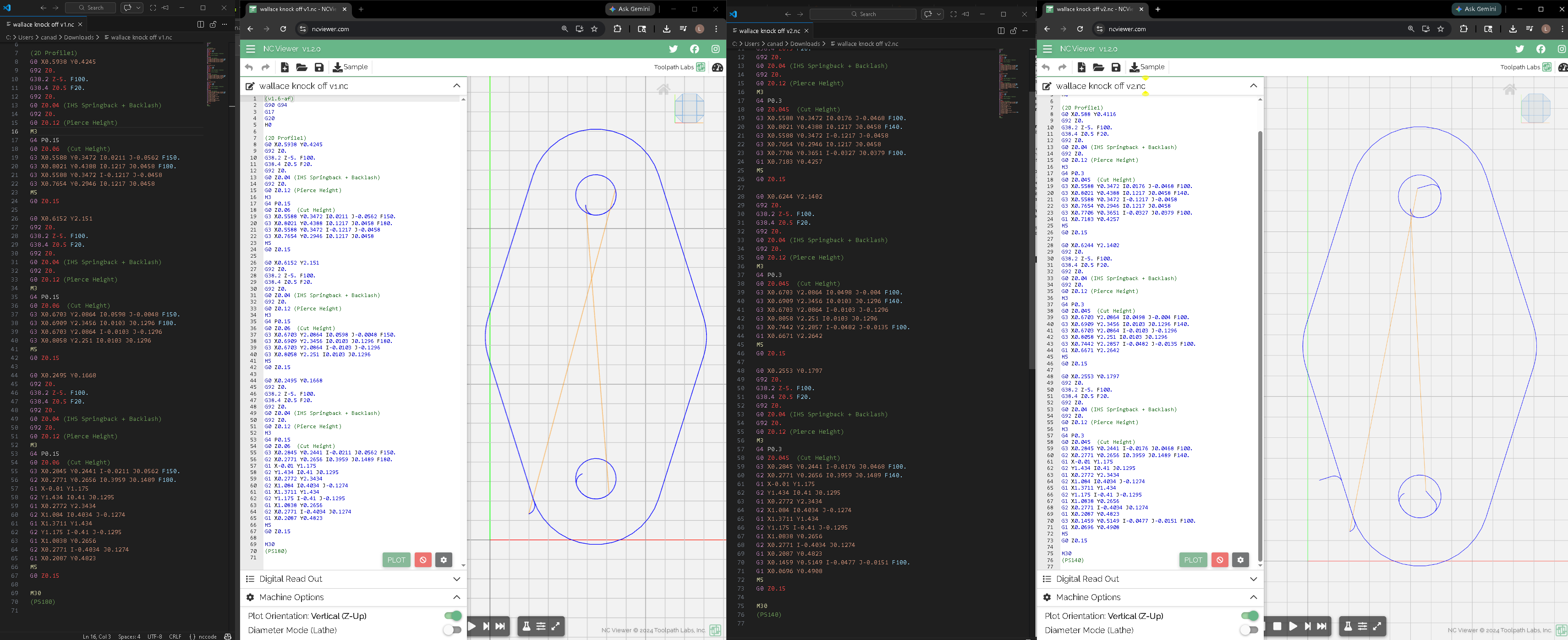

I’ll post this here so everyone can take a look at the code.

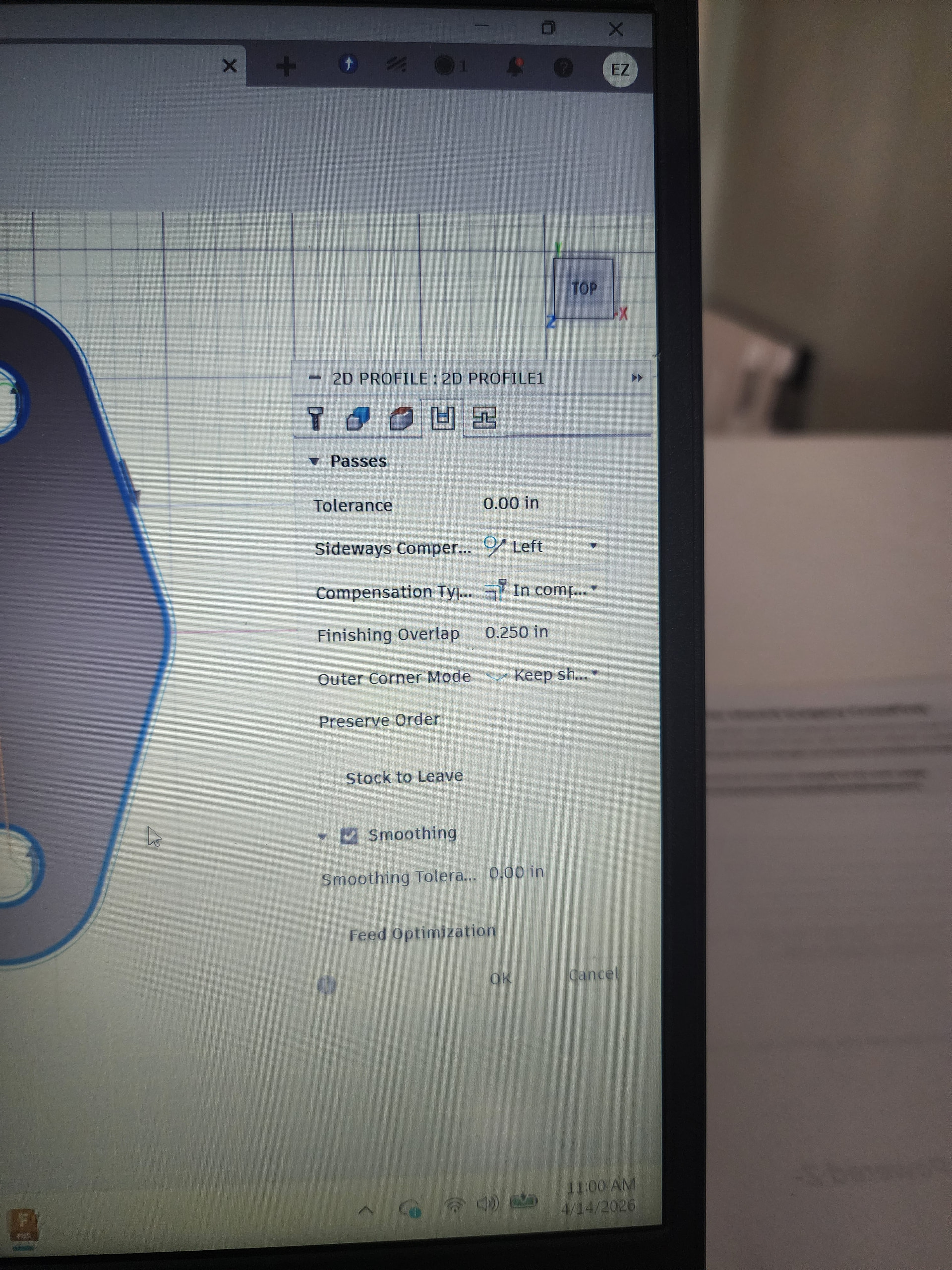

A couple notes is there is an extreme overcut setting on both of these. I normally do not use an overcut unless it’s for thicker material.
On version 1 I see you have a Pierce delay (g4) of point .15 add on version 2 you have a Pierce delay of .3 . Both of these are inadequately short Pierce delays on the Langmuir pro table. The Langmuir pro has about 0.5 second delay from the software triggering the fire relay to the torch actually firing .For 18 gauge I would start at .5. This alone would probably fix the issue.
The reason the second program was likely successful is the slightly longer Pierce delay and this will lower program speed.

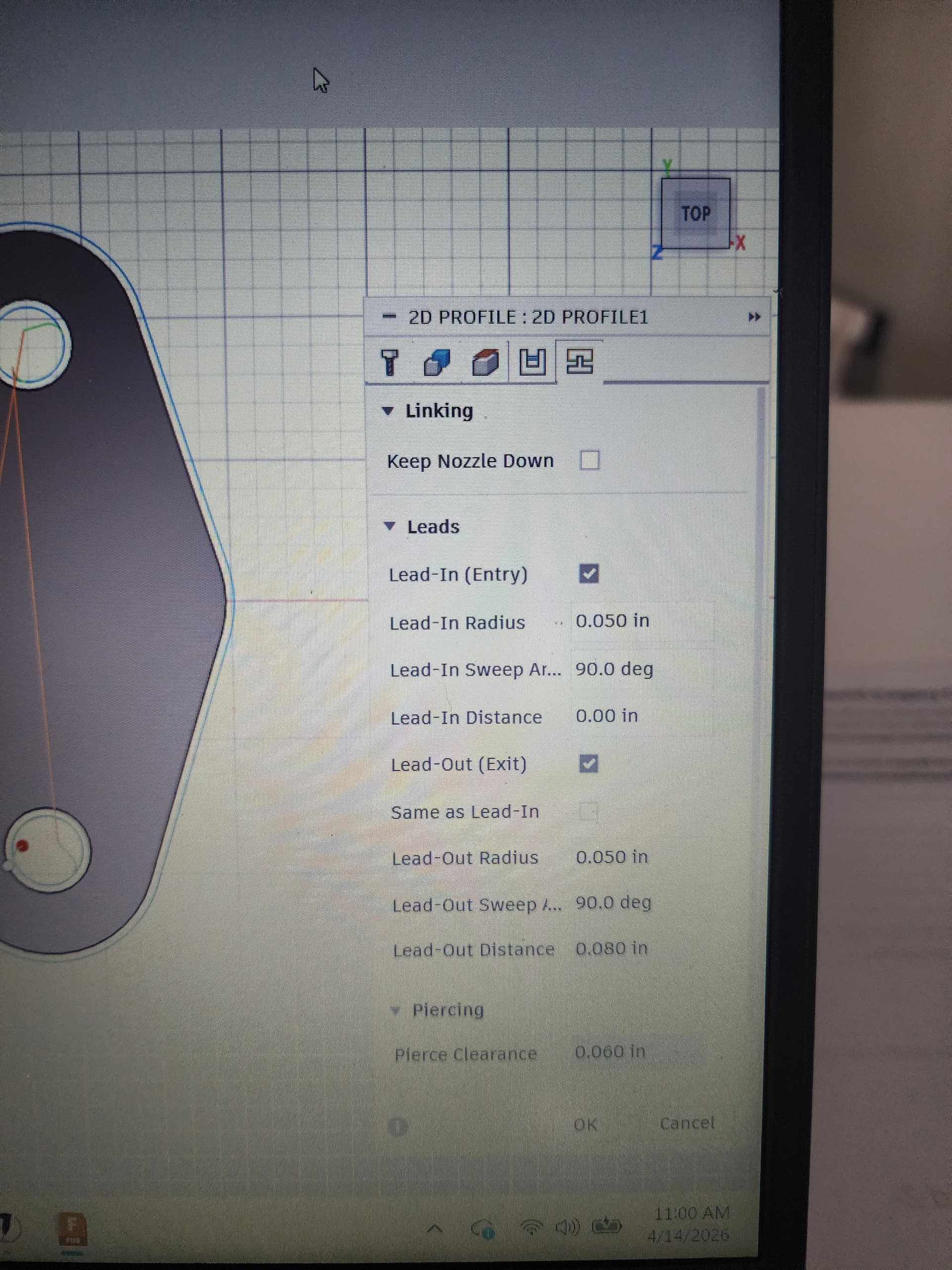

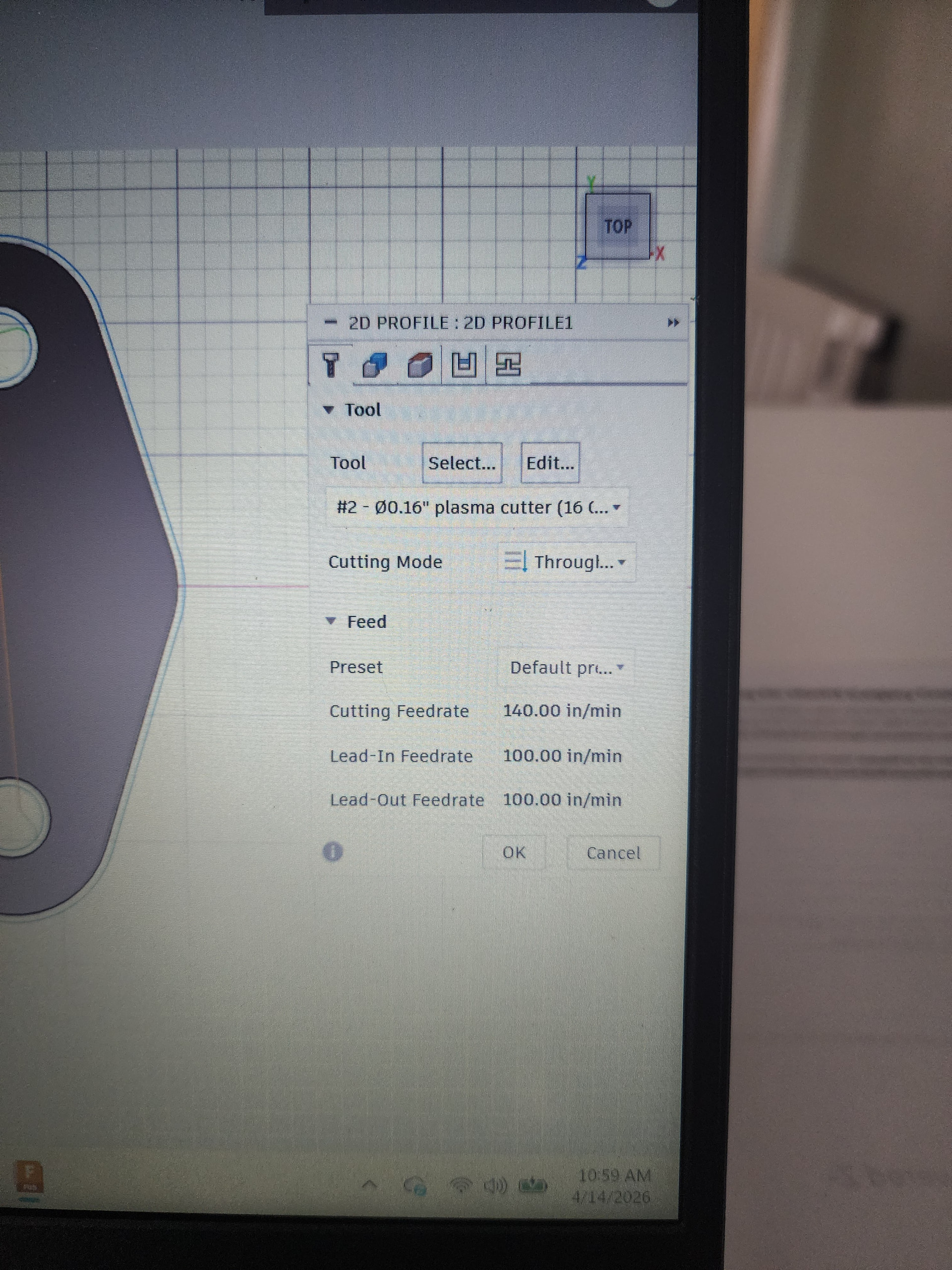

On this simple bracket in 18 ga you shouldn’t have to apply any added features in the 2D profile. menu. You could probably get away with the straight 90° lead in with no lead out, I would not be doing any feed rate optimization, and I would get rid of the overcut setting. With this thin material like don’t think you’ll even need a radius lead in.
Simplify the program and increase the Pierce delay. Check the quality of your consumables and make sure your machine is set to 45 amps to start. Make sure the work clamp is on the material being cut .Try again and you should be successful.
i got the pierce delay. i know where to find that but i had a couple questions about some of the other settings. where is the overcut setting in fusion? is it the finishing overlap on the passes dropdown in 2D Profile? next, where do i find the feed rate optimization? is this under the Feed in the tool dropdown or is it in Linking under leads? should i get rid of the lead in radius, and the lead out radius? and eliminate the lead out and lead in distance?

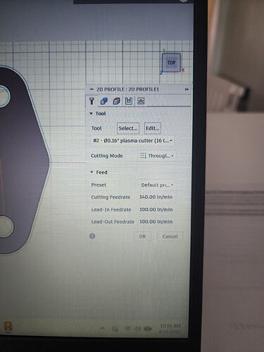

I see you didn’t use feed optimization you you slowed your lead in feed rate with the first menu of the 2D profile settings.
The overcut I was just using the wrong word for it’s the finishing overlap you can see it in your one screenshot there you have it set to a quarter inch.
Eliminate the lead out entirely.
I think I understand now. I will eliminate the finish overlap. Increase the pierce delay. Leave the feed rates the same. Increase the amps and eliminate the lead out completely. Do I need to adjust the lead in radius?
For now you could just eliminate the lead in radius. You could go to a straight 90° on the lead in.
The lead in radius is a more effective technique for thicker material.

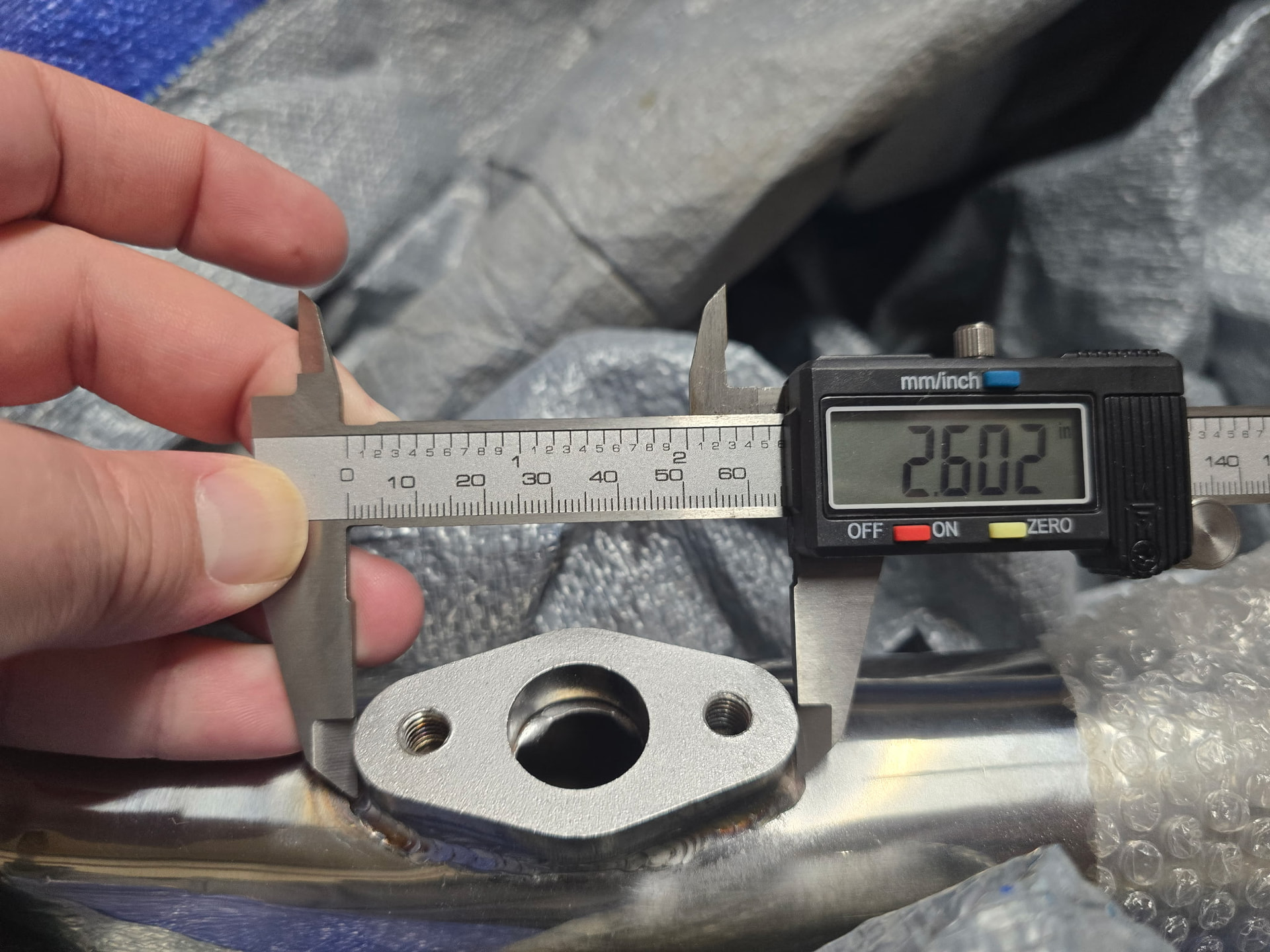

Are you making some block off plates for an engine?
Yes. I wanted to get the size right first befor I start purchasing thicker material. I have a few pieces of 18 GA so I wanted to practice on metal that didn’t cost me anything. I already spent a ton of money on everything else. Lol
