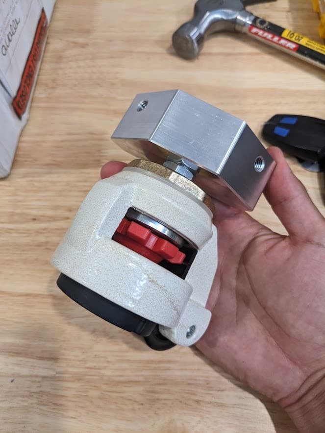

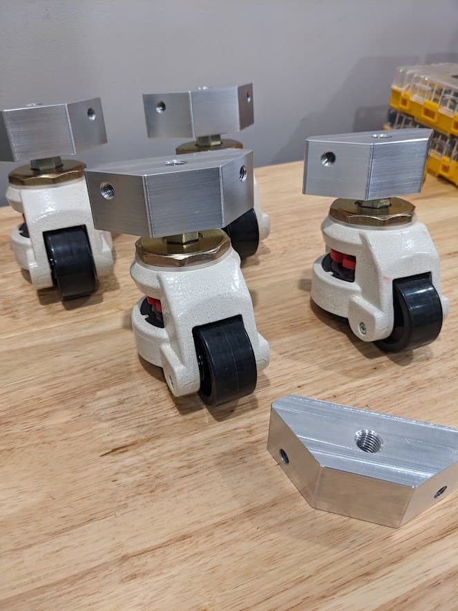

For now, just wanted to post these levelling caster assemblies that we made. These will help us wheel the machine into final position once we forklift it off the pallet.
Very nice job. Hopefully you will be able to adjust them with the 1000 lbs sitting on top. I have the same wheels on my CrossFire Pro and its a chore. They sure are pretty… :laughing:
Well, being in Canada, it’s probably about 740 lbs… :rofl:
I have the GDR-80-F-NYN casters. My machine easily weighs north of 1200 lbs, and they roll smooth. They did bog down when I tried to roll my machine around PLUS my 150 lb surface plate sitting on it for tramming, so 1200-1300 is probably the practical limit.

Get the ones that look like these but have a lever vs. the spocket wheel for adjustment like these
https://www.amazon.com/gp/product/B081GJH7TV/ref=ppx_yo_dt_b_search_asin_title?ie=UTF8&psc=1
much easier to use by far and I know I also have a set like yours.

  • The levelling caster assemblies worked but weren’t perfect, especially because there was an incline in the area of my garage where I was putting the machine, so a lot of the weight/load started off on a couple of casters. I definitely saw the sheet metal legs bouncing around a bit. That being said, they worked to get me into position and I’ve now lowered it to rest onto the rubber feet. The important part is that it allowed me to roll into the spot I wanted, as my residential garage didn’t allow me to use the forklift to put it into the exact position without crashing the forklift into the wall/ceiling

Huh, this is the first time I’ve seen someone bolt the leveling casters directly into the stock legs. Does it feel sturdy?
It was good enough to wheel around my shop a small distance, so it did the job. I wouldn’t say that it’s sturdy enough to roll overtop of things or on rougher terrain - a limitation that I think is just because of the sheet metal legs.
Overall though, for what I needed, they worked great.
If I were to do it again though, I would have bought the slightly larger version with larger wheels, load capacity, and a ratcheting levelling mechanism.

Do you find that the feet can rock at all when extended? I bought a ratchet lever set and returned them because when raised there was no locknut and the feet could move a little bit inside the slop of the threads. Maybe higher quality ones are better there?
I also planned to make similar mounting bolts to the ones that you made, and then add some steel bracing on the sides and back to stiffen up the legs. Temporary ones could be installed in front during the move and put away when done to allow access under the machine.
I’d still like to do the upgrade if I can find the right casters.
It seems pretty sturdy right now to be honest but I have yet to cut any chips and see if it’s causing problems.
If I were to do it again, and if I had the ability/skills to weld, I would actually weld a steel threaded block instead of screwing it on. It would make that connection a lot more sturdy when rolling on the floor.
