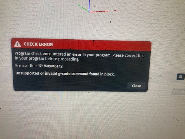

Hi, are any of you still using freecad? And do you know what it takes to edit the post processor to workon the Mr1? Or do I have another problem? I’ve had my mill for a couple years and have been using fusion but it’s too expensive for the little that I do but I do too much to use the fee version…

The free version of Fusion is capable of doing anything that the MR-1 supports. Are you just running out of available open files? You can set some of your files to “Read only”, the limit of 10 is just how many are flagged to be in edit mode at once.
The GRBL G-Code processor that CutControl is based on doesn’t support most canned cycles, and FreeCAD is probably using one of those. See if the FreeCAD post processor has a method to disable the use of canned cycles.
I’ve used the Generic GRBL post inside Autodesk Inventor (same as Fusion for the most part) to send things to the MR-1 and it worked. I had been sending files to my cnc router and forgot to switch back to the Cut control post and I posted a couple files with the Generic GRBL post processor before I realized it. haha. I’m not saying it will always work without issues but I’ve done it a couple times by mistake and didn’t see any negative effects. The parts ran just as good as they did with the LS post processor.
My understanding is fusion 360 isn’t for commercial use. I mostly just play but I’m getting a few commercial jobs that over fusion s 1000$ limit but 800$ for the paid version would eat up most of my profit. Also Fusion 360 reduces rapid speeds to cutting speed when it posts and that really adds a lot of time to some of the cycles that I am running. thanks for that input I’ll post the results.

freecad already has 2 grbl post processors and work the way they are.
you have to split output by tool andif you are drilling holes you need the–tranlate_drill argument to breakup g70 codes to g1.
