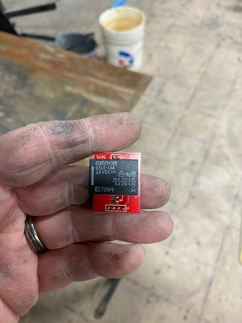

Found my issue -a relay
So after posting posting about the torch not firing, I tried upping the pierce delay etc. and still no luck. Then took the cover off the box and found that the relay had come loose again. Is there a fix for this? this is the second time it’s happened.
We haven’t used this much because of intermittent issues, (I’m sure mostly operator error) but this came loose before and we remember someone else posting about this coming loose during shipping… it has been stationary and not bumped or messed with. so I do not know how it came loose again.
Zip tie, dab of silicone sealer, maybe cut bend and bolt a little aluminum bracket to clamp it in place, something creative :rofl: :beers:
nail and hammer…make sure nothing moves again…
