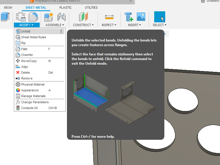

Here I am again requesting help, I am dabbling in the sheet metal tools for fusion. I have got as far as getting the flanges made and having a flat pattern and unfolding the body, now I am trying to put holes in
the flanges for fastening and add relief cuts to the bend centre line on the edges of the metal so I know where to line it up on my bender, I have tried making a new sketch within the flat pattern section but I can not snap to the bend lines, I have tried exporting the flat pattern as a dxf, but the results of that end up in broken lines on the design I have in the centre. Is there an easy way I can turn the flat pattern into a sketch and snap to the bend lines? The dimensions for it are 21.75" x 12" with 1" flanges, using 14g steel. I made the inside between the flanges 21.75" on purpose.

You cannot modify the flat pattern. That is only used to take to manufacturing.
To modify the metal, you unfold it:
Then start a sketch and use the surface of the metal as your plane/surface. Once you make the sketch, you select the contours and extrude/cut through the metal. At times this can be a little tricky to pick the contours (until you get used to it): you may need to hide the component/body to select the contour. Once the contours are selected you will need to make the component/body visible before you can do the cut.
It does not matter what side you do the sketch (front or back), but it may matter if dimensionally the contours need to line up with something. In that case you would base that on the side that you have been aligning/dimensioning your sketch and components.
A slick way to make relief cuts in the bend:
This technique was shown by @Erock89x: Put a construction line in the center of the bend. Then use a “center rectangle” clicking on that center line. For 12 gauge I found that 0.07 to 0.09 was sufficient for a relief cut so I set that as the width of the rectangle. You can make the length whatever you see fit.
Extrude: Select contour:
Cut:
Results:
You will notice that there is an alert on your previous flat pattern anytime you make a change to your component/body. All you need to do is click “Update flat pattern.”

Jim has some good advice and methods. You could also project the sketch and use that to do what Jim is showing. Along with the center point rectangle you could also use the slot tool for bend relief. There are multiple options including the center point option. I also use the polygon tool to mark the end of the bend line.
