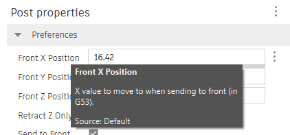

First Piece of Feedback:

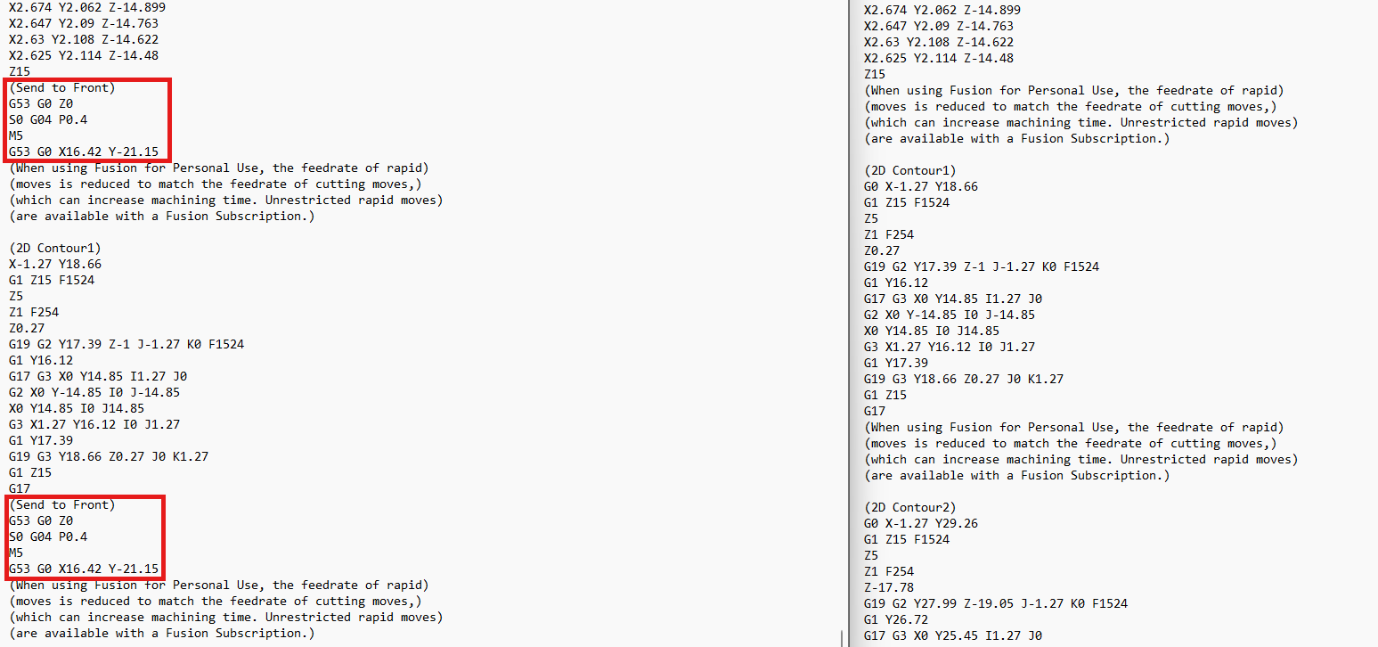

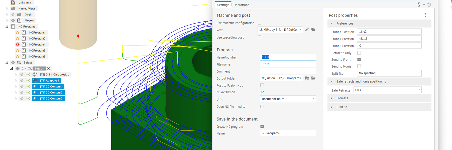

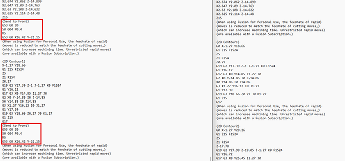

I think I am seeing the error you described in January. After my adaptive path the spindle is commanded off after the Z retract, it would then go into the contour path without the spindle on, which would obviously cause a crash. I try to bunch together multiple tool paths with one tool if I can, roughing and finishing as many features with the biggest endmill at the beginning of a part. Would be nice if the send to front section of code only went after all toolpaths are complete with a given tool and you are ready to make a tool change. Not sure if I interpreted the use instructions wrong, so I also have a screenshot of my settings before posting.
Second Piece of Feedback:

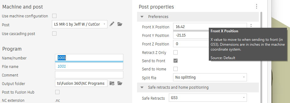

The send to front position settings, I assume these are in inches. Would be nice to either A) have a note in the dialog box that denotes the input as such or B) cooler method would be take the document units and convert this input (guess you would still have to know input units) to match the program units. I default design in inches, because America, but sometimes it does just make more sense to design and program in mm. In the particular part I tested this post with, the send to front command would send the spindle closer to home than the front because it is programmed in mm lol.
Again super nice work, just opening the post code made my head spin, can’t imagine editing it at the moment. Just curious are you doing this all your own interpretation of the code? I thought about feeding it to ChatGPT and seeing what it can do, but that might end up doing more harm than good.
ChatGPT (not the free one :wink: )has done a lot of the heavy lifting, but it is still a lot of trial and error, and a little bit of skill.
RE: your first feedback, yes that is a bug, it is supposed to run all tool paths for 1 tool then perform the end of run function as selected for tool change, etc, should NOT be doing it between each tool path.
2nd point, I can probably add a note that position is in inches, but I don’t think I will go thru the trouble of SAE vs Metric, that is actually quite a bit of code to do a (IMO) cosmetic feature.

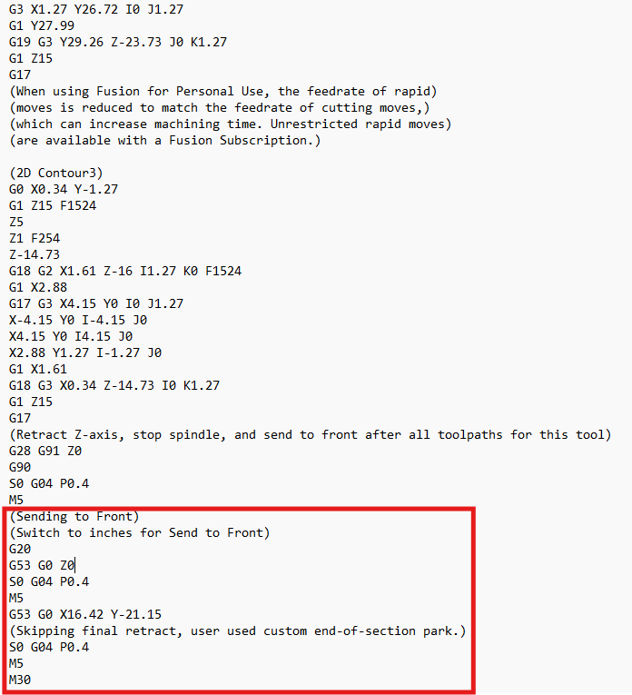

This motivated me to take a stab at this. I tried implementing the changes I mentioned above. On the test I did earlier I was able to have the tool go through all tool paths before inputting the Send to Front code. I also have a note for the send to front dimensions being in inches and the post will add a G20 line to switch the machine back to inches before sending to front. Did a test on the machine over the weekend and it worked. Looking at the code in-depth it seems like the post is back to using a G28 for the Z retract, which I don’t think is the end of the world, but I must have inadvertently changed something that got rid of the always using G53, even for the Z retract.
These simple edits make the work flow so much easier. Would be nice to find a way to command the machine to do a tool touch off and then go right into the program after a tool change, but I think that has a lot more to do with the cut control side than the g code side unfortunately. One button click per tool change would be a nice setup, but this post eliminated several at least. No more send to front after the program is finished, no having to Z up after tool touch off to start the program and tool stick out information is right there in the main program for you.
