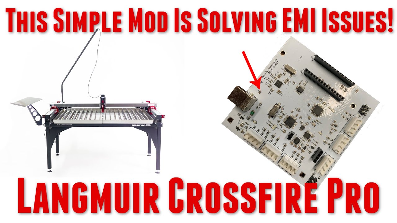

After testing a lot of different theories, we found that a single SMT inductor was the source of the problem. For those not aware, the D+ and D- USB data lines are usually pulled to ground with weak pull down resistors. This is to ensure that the data lines aren’t ‘floating’ which is good for EMI resistance. An inductor is placed in series between those resistors and the ground plane which follows standard USB guidelines. That inductor is great for ‘trapping’ noise that emits from the board, but it turns out that the inductor acts like a receiving antenna to funnel noise emitted from the plasma cutter straight to the data lines via the pull down resistors. Noise on data lines is BAD.
Through testing, we found that removing the inductor and soldering a short between the solder pads dramatically improved the resistance to EMI. We have an AHP plasma cutter that is a particularly noisy emitter that requires the use of multiple chokes (3-6 depending on the computer that is used). By shorting the inductor, we are able to run the AHP using a cable that not only doesn’t have clip on ferrites, but also does not have molded ferrites either.
We will be performing this modification to all of our motion control board inventory so that future customers do not experience this issue. A 0 ohm resistor will replace the inductor on subsequent manufacturing runs.
If you currently have a batch 1 or batch 2 machine and wish to make the system more robust to noise, we strongly recommend performing the mod as follows:
Step 1: Using needle nose pliers, remove the inductor labeled L1
Step 2: Solder a short (aka a solder bridge) across the two pads
Step 3: Reinstall board.
Chad from @ManCrafting graciously created an excellent how-to video which is provided here:
