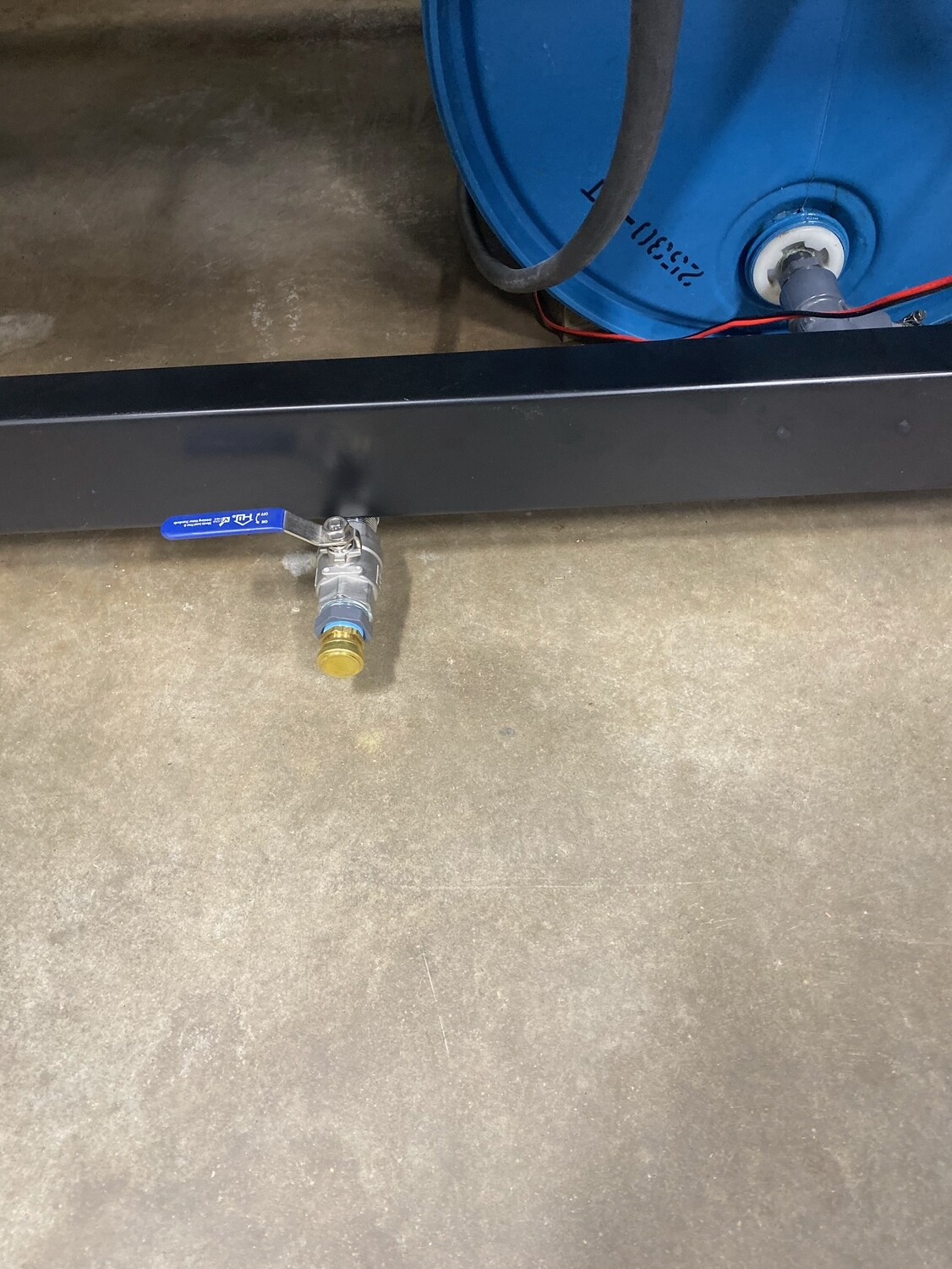

Here are some the first mods to the XR table.
Cut sumps into each section of pans so that filter material can be added to the bottom to filter the fluid back to the storage tanks. Sumps were made from stainless steel so magnetic pickup tool could be used to clean pans.
Two 55 gallon barrels hooked up with valves and a air hookup to pressurized barrel to fill the table.
