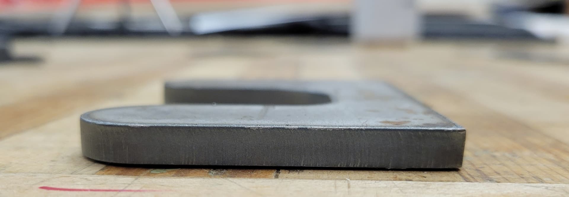

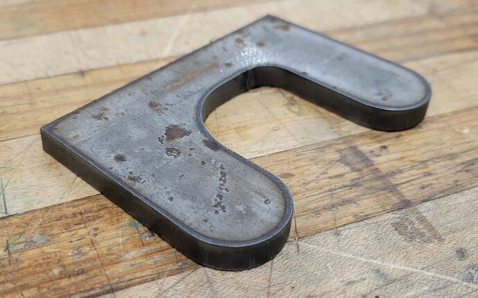

Upgraded to Hypertherm 45XP + machine torch today, and making first test cuts and getting tools created in F360, etc. The Langmuir CPC cable made it a simple, instant upgrade.
First cuts on 1/4" mild steel are beautiful quality. What dross there was fell off @ 40ipm.
I am working on my bevel angles to see if I can reduce them any.
I haven’t calculated the angle yet - but the average I measured is about 18 thou (max - min)
What has your experience been ? I am guessing I cannot hope for much better than that ?
Let me know if you think I should chase any settings or let well enough alone
Is that bottom picture oriented in the way it was cut? If so having a bevel like that “/“ (on the right side of object) I believe means your cut height is too low. Are you entering the nominal voltage that’s in the HT cut chart? I haven’t cut 1/4” with my HT yet so can’t say if it’s normal amount of bevel, the cut quality looks great though
Hypertherm says 1-3 degrees on the good side of the cut and 3-8 degrees on the bad side which is why cut direction is so important. I think .018 over .25 inches ends up being like 4 degrees. Cuts sure look good to me.
I have yet to test/verify the “actual” cut height. It is set to 0.06 per HT chart.
I should run through that test/setup… I know someone posted g-code for doing that here somewhere that I did last year for my previous machine…
What do you post process with we just posted 2 in another thread a couple days ago. The program I posted was done in sheetcam with a cut height of .060 with .020 backlash.
Regarding @Phillipw’s recommendation, if you did your post in Fusion you are cutting at 0.080”, because they automatically add .020” backlash AFTER the z axis backlash has been taken up. Further, if you had programmed in any IHS spring-back in, then your cut height is most likely raised by that amount additionally on 1/4”.
LSS-Make sure you’re compensating for the 0.020” backlash added automatically in Fusion’s post.
You don’t test anything if you run nominal voltage, your THC will automatically adjust the height to achieve the intended voltage. Running nominal voltage right from the HT cut chart takes lots of guess work out of getting setup properly, as long as your THC reads the voltage properly.
@Teknic@Phillipw I’ll work with Nominal Voltage and see how it goes!
