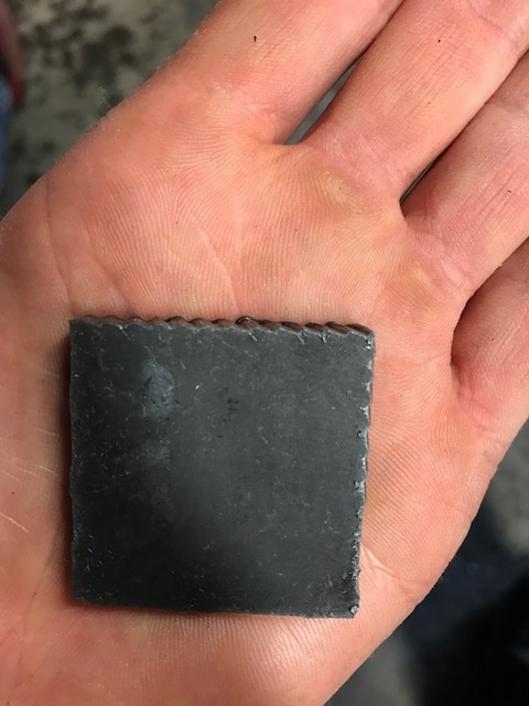

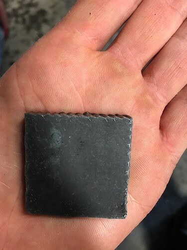

I picked up some Harbor Freight 0.9mm tips and electrodes but they give quite the serrated edge.
I’ve had good luck with 32 amps and 29 ipm with a 1 second pierce delay. Gap from material is .060.
I know it can be better than what I’m getting, but I have not had a chance to experiment further.
i NOTICED YOUR CUTTING ALUMINUM ARE YOU USING A GAS MIXTURE I BELIEVE YOU MAY NEED IT
No sir, no gas mixture is needed. These were cut on the table, no prep. Just cut and pulled right off the table. 1/8” aluminum using the razorweld 45
