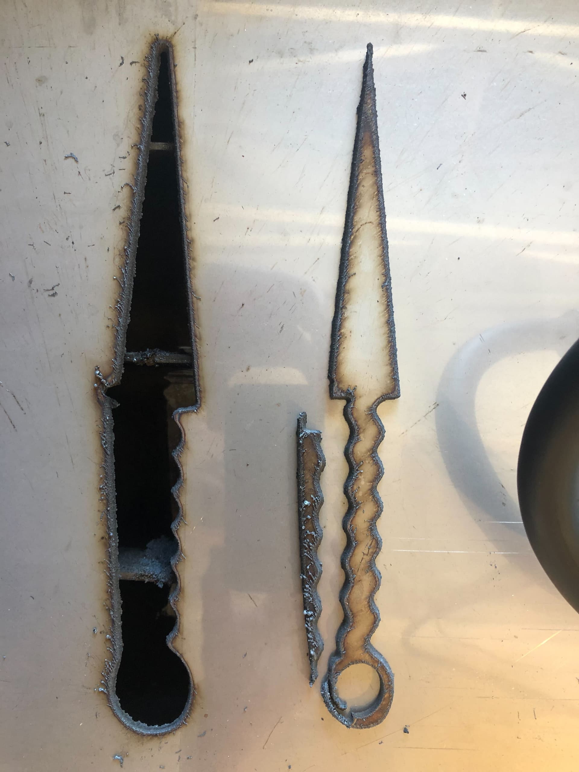

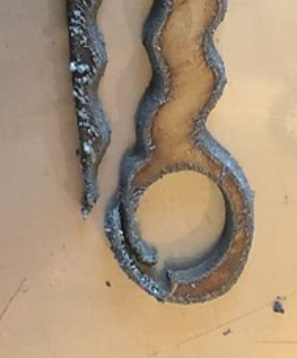

I’m thrilled to have my 1st cut on the table. The cuts are not clean. Is there a troubleshooting guide?
Are you cutting stainless steel?
What thickness is that material.

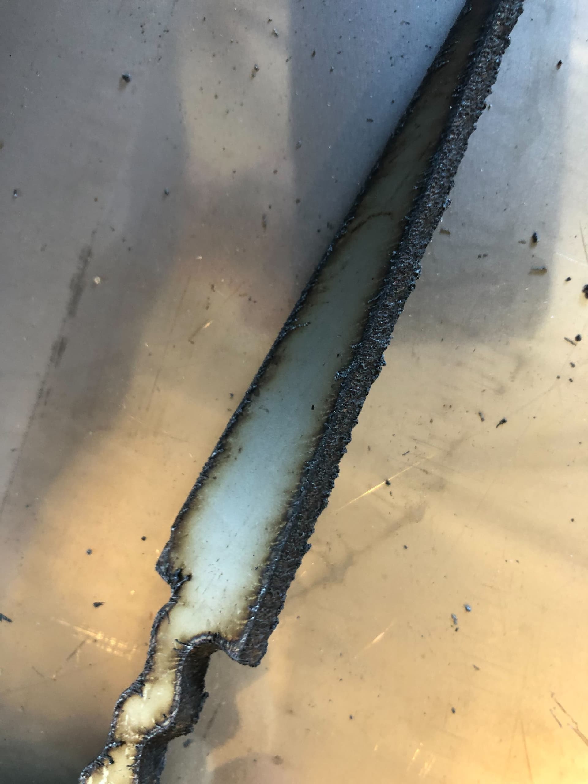

It also appears that you might have had a bearing slip where it cut into the handle slightly.
Yes. It is stainless steel.
1/8 thick

The picture doesn’t really show it…but the cut is more of a V vs straight.
What are the rest of your parameters you’re using?
Cut height
Pierce height
amperage
feet per minute
What plasma cutter do you have?
Is your work clamp secured to material?
And you are running this with the torch height control ON?
I’m guessing you’re going to have a cut height that’s too high or part of that bevel you’re seeing but I would like to see some of your parameters first.

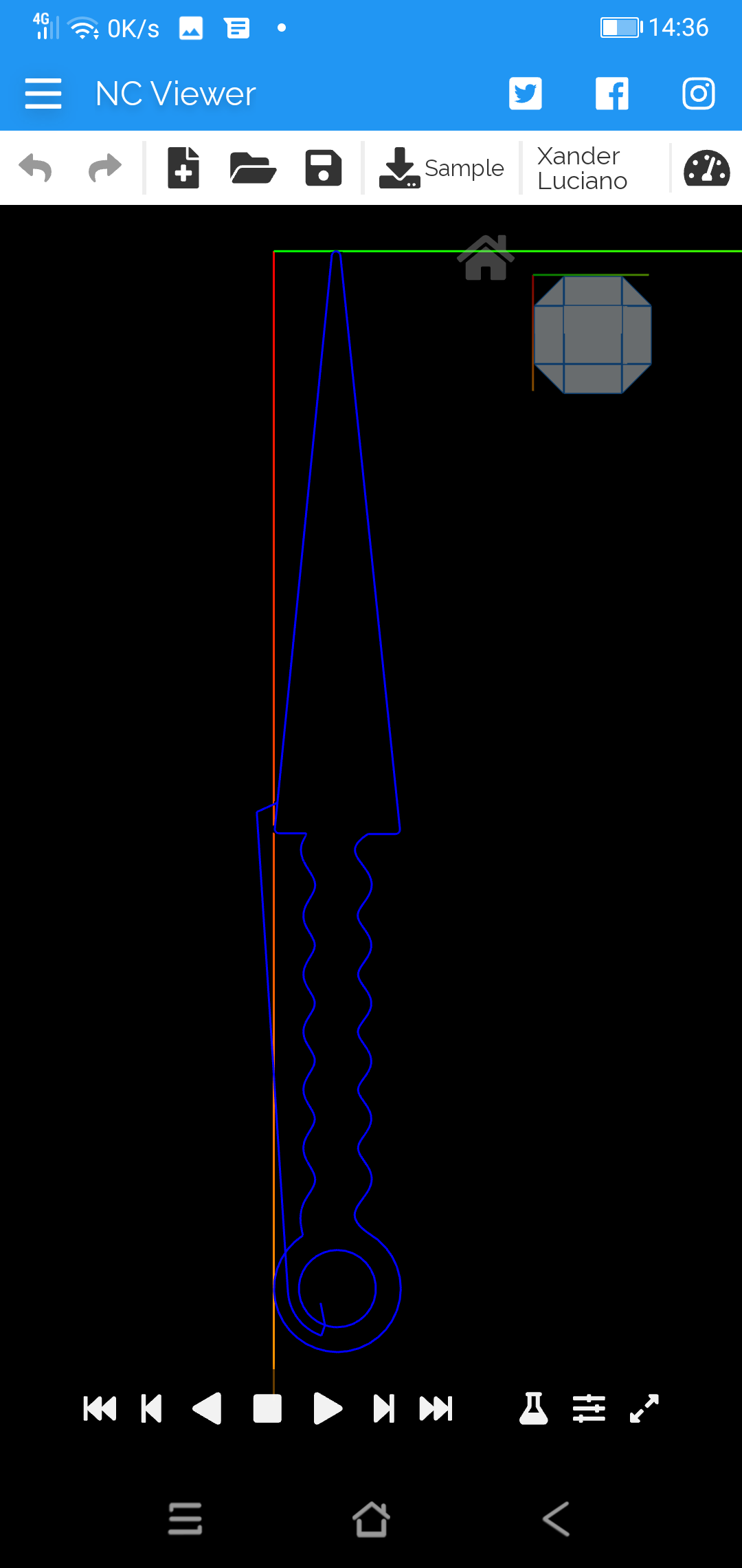

Did they also be something going on with your programming here?

I am using a ready-made script from the forums. The torch was set to 1/4 inch above the metal.
I did not run it with the HC on. However, I will do that next time.
thrower.nc (17.2 KB)
I’m not sure what your machine is yet but .25 inch cut height is too high.
Stainless over all other materials wants an especially close cut height typically.
For example I run stainless steel 14 gauge as .02 cut height on my hypertherm running 45 amp .
I’m sure you’ll be able to make a good cut when to get some parameters dial in.

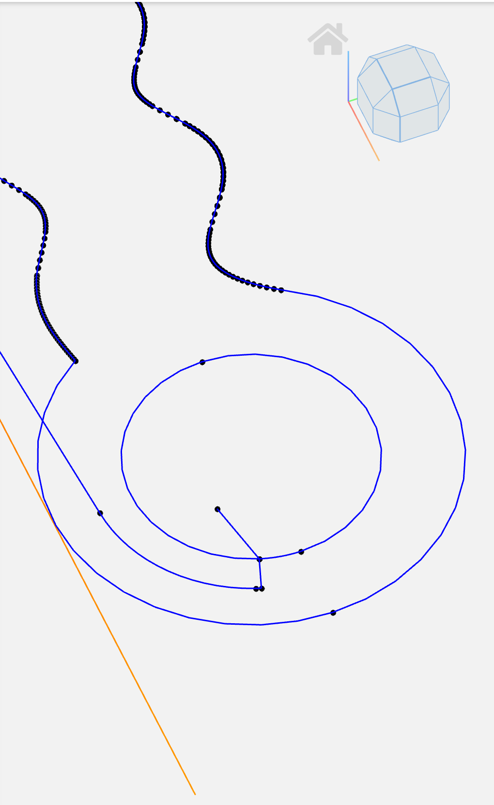

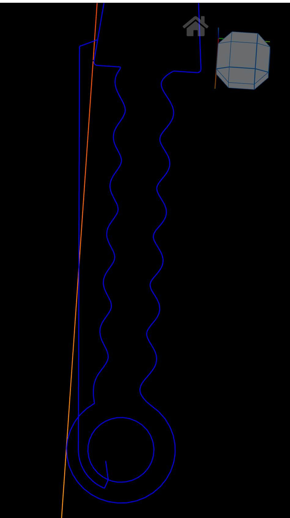

This program only has two z axis operations in it that’s why the notch, it’s not a coupling problem.

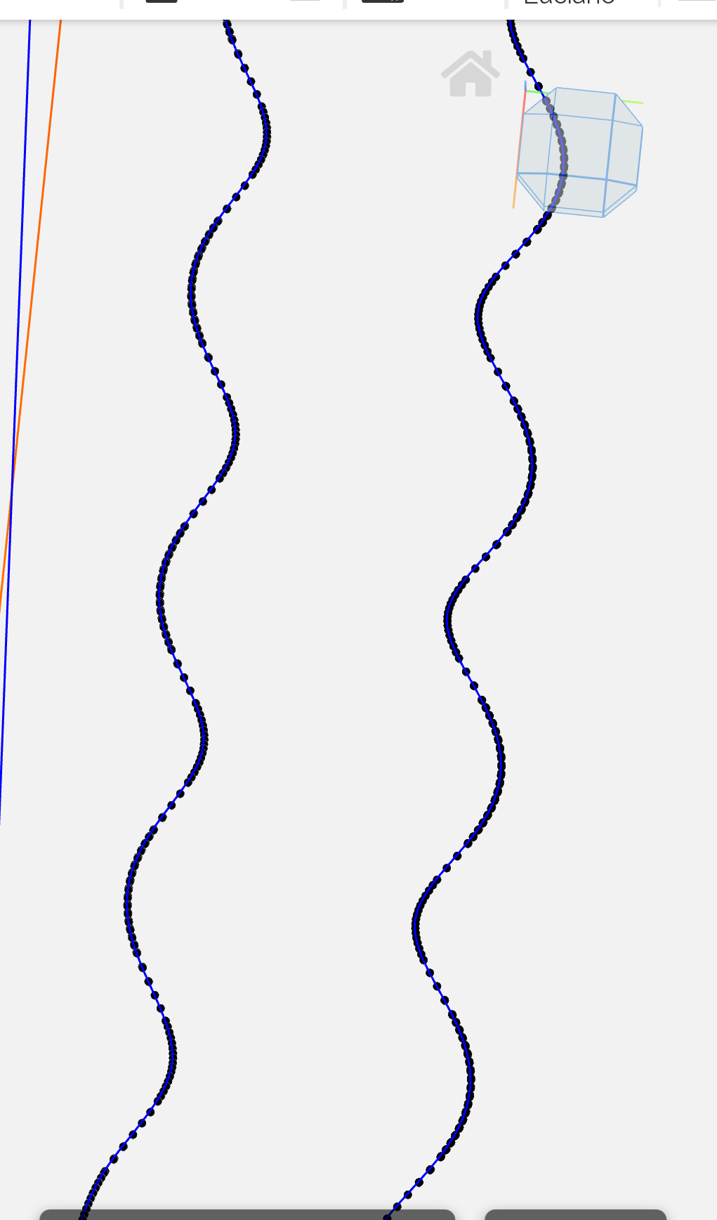

This program could also use some smoothing out there’s a lot of points in it for such a simple piece.
Fast and smooth for cutting stainless steel is best

Using the THC and Razerweld 45 with hand torch.
