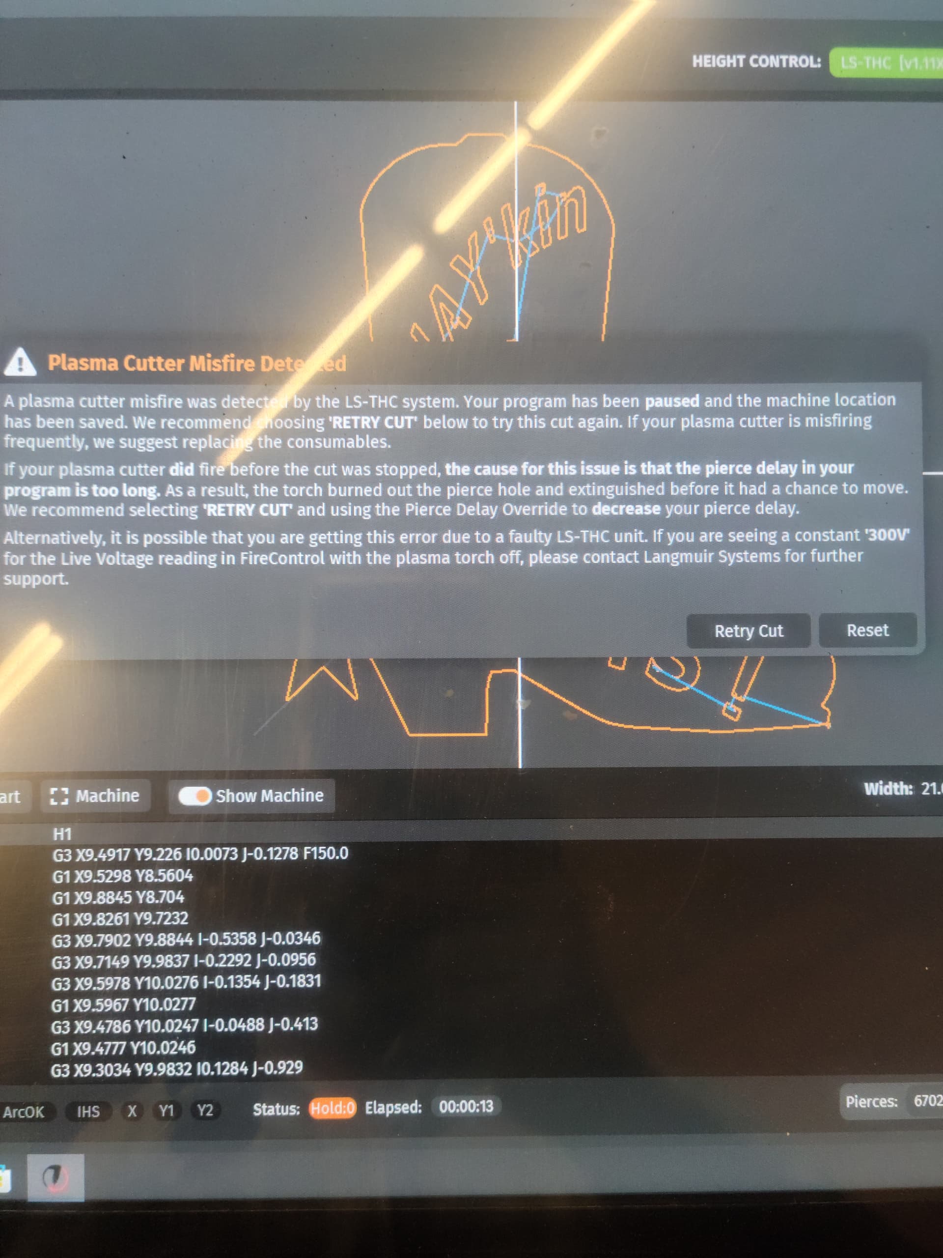

But now I have a problem. The last two programs I have tried to run it would start okay and run through the first cut but as soon as it moves to the second cut there is a click and the torch won’t fire and the light on the torchmount turns red. If I retry the cut it does the same thing UNLESS I allow the post flow to complete and then shut off and then retry the cut it will make that cut but then repeat the fault on the next…and so on .
I’m hoping y’all might have some insight as to the possible problems and guide me as to where to begin troubleshooting this

Both of these programs I got the same problem. Starts the program and makes the first cut fine. Then I get this fault. If I try to retry the cut it will not fire. EXCEPT I did discover that if I wait for post flow to complete, then hit the retry, it will make the next cut.
Air pressure is staying right where it should be. Torch is cutting great when it fires. So what else should I look at that would cause this fault to come up?
Why would it work fine on thick 1/4" but fail on thinner material?
No, I am not getting that constant 300 live voltage reading in the last paragraph
Have messed with pierce delay but don’t know how that could be a problem since it isn’t even attempting to fire on the second cut. I just hear a click from the everlast and the red light comes on.
The fact that it works after the post flow stops, indicates an issue with the air solenoid. In order for it to fire during the post flow, the solenoid has to quickly shut off the flow of air and then open again to send a strong enough burst of air to blow back the electrode.
I have also experienced this issue when the electrode is not perfectly aligned inside the torch. Cracking the cap loose to allow the parts to self center and then just lightly snugging it back up usually works to correct the issue.
Drop your air pressure to about 60 psi when cutting thinner metal and see if that works. I have seen that on the 82i and 102i it need less air pressure because of the larger air line in the torch having more volume then the smaller air line in the 52i and 62i torch.
As the error description is stating, one possible issue is that the material is being blown away too quickly and the plasma stream loses the connection for lack of material for conduction of the current. The thicker material takes longer to burn away and this gives you the chance to complete the cut with the higher pressure without losing the current. George’s (@mechanic416) suggestion to decrease the air pressure with thin material would be a quick way to test that theory.
However, David’s suggestion is also valid: If you have some stickiness with the air solenoid or electrode that is requiring the higher pressure to blow back the electrode, that is also a concern.
So in other words: your efforts to adjust one, may intensify the other. The solenoid issue is a good guess.
As the 82i is a new plasma cutter I would say the solenoid should not be a issue, but you never know.
