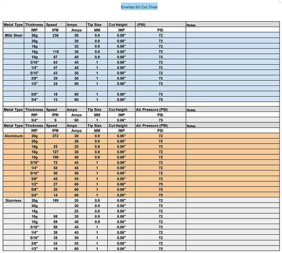

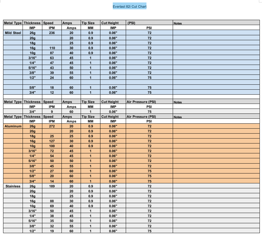

Set the air pressure at 75 psi on the front of the machine.
The psi chart floating around is incorrect about the air pressure. Here is a good chart to use.
I have been using an 82i for years.
So you are saying just leave it at 75 even for 1/4" and under?
Yes, set the machine for 75 psi and go on with life. 75 while it is cutting. If it drops more than 5 or 6 psi, you must look inside at your internal
air solenoid.
The chart you are using is wrong. I have never seen a real Everlast 82i cut chart. The 82i also needs a post flow of 45 seconds for best torch and consumable life. As @Bigdaddy2166 said 70 to 75 psi flow works best.
Here is an updated Everlast 82i cut chart.pdf
Thank you Jimmy for his Adobe technical support.
Everlast 82i cut chart3.pdf (173.1 KB)
https://acrobat.adobe.com/id/urn:aaid:sc:US:b50daa42-9195-4d9e-ac06-5e3275e51b3b
Thank you, Everlast sent me one for the 62, and said it was good for the 82, obviously they were wrong
