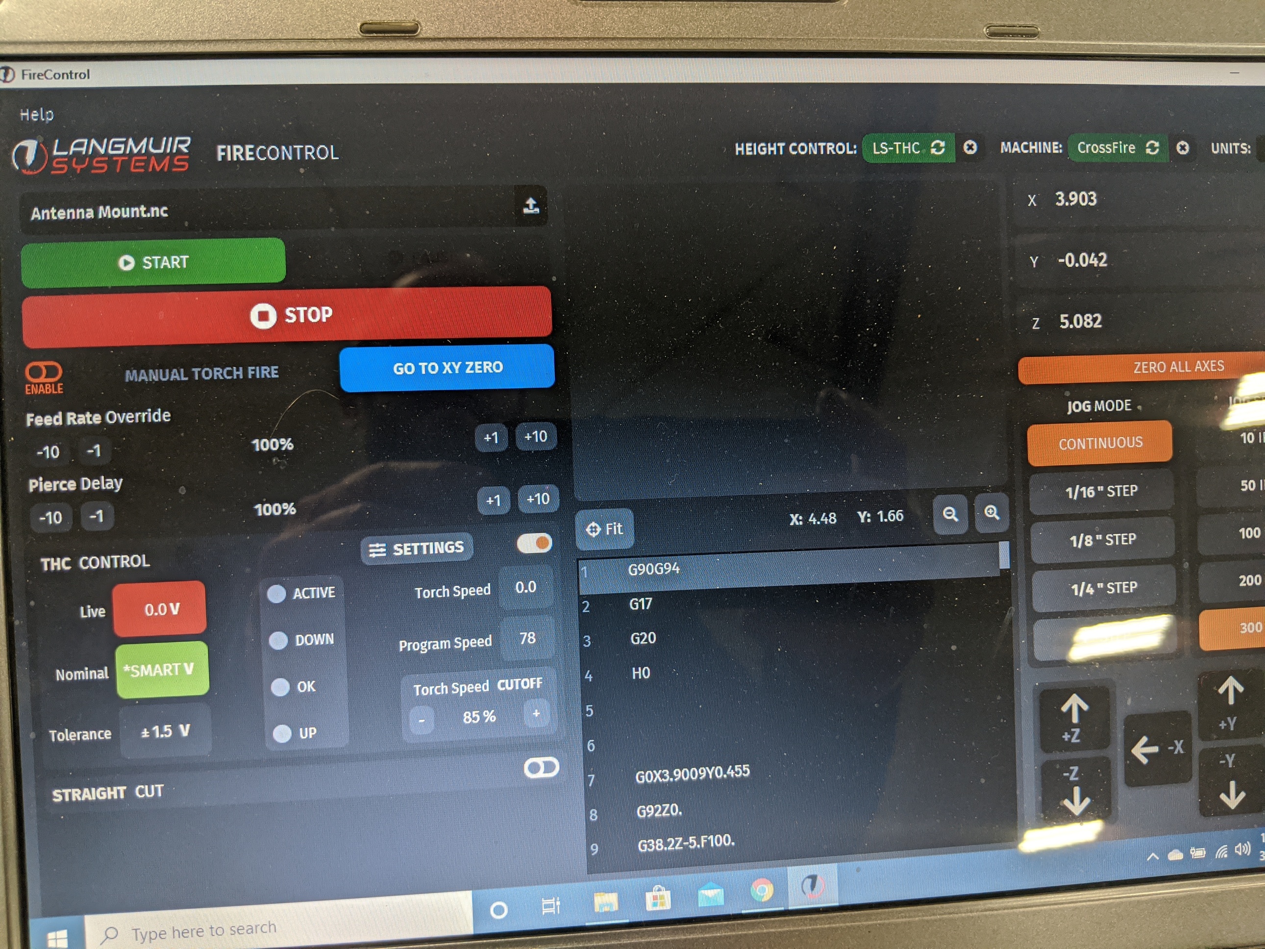

FireControl toolpath not visible
For some reason the toolpath doesn’t show up in FireControl. We’ve been able to make a few test cuts (still working out those issues), but no toolpath. We’re running an old 64-bit Windows 10 laptop, but the specs meet the minimums. Zooming in and out doesn’t change help and neither does the fit button. Any ideas?
Hi @janzenbros we’re sorry to hear about your issue. Can you please attach your program here and also send a screenshot of what you are seeing?

That was quick! Here you go.
Antenna Mount.nc (1.4 KB)
We can’t reproduce this issue as your program is showing up in the visualizer of all of our test machines.
Is it only this program or all programs on this machine?
Have you uninstalled/reinstalled FireControl?
Are you able to try this out on another computer?
Can you post the specs of your computer, specifically your graphics.

After looking around I believe its a graphics driver issue. This laptop is old enough they don’t make proper Windows 10 graphics drivers for it.
Did you find a solution for this? I’m trying to get an older laptop running to keep with the table. It seems everything works, just no toolpath display.
It probably has to do with the graphics card in the laptop. I have an old PC that I’m using and the toolpath did not display on it. I had to put a newer graphics card in it and everything works perfectly now.

The FireControl visualizer uses OpenGL so older systems that are experiencing this issue may just need to update openGL drivers. Please post if this works for any of you.

Some customers have had success with visualizer issues by updating their OpenGL drivers. Follow the directions here and see if it works for you.
