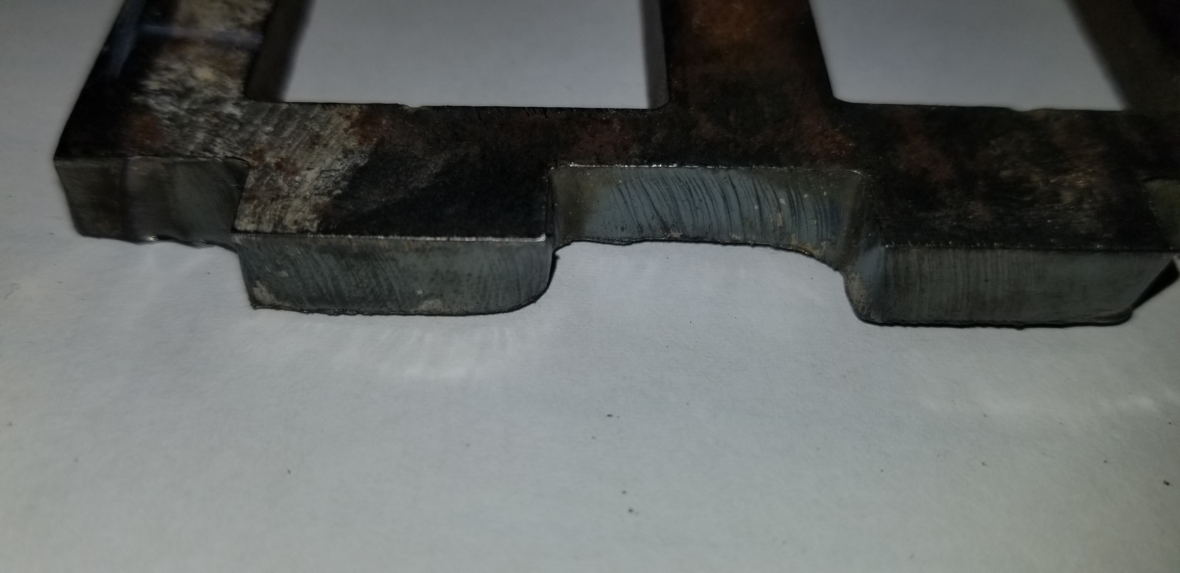

I was skimming this post hoping to verify the G code that turns the THC on/off so I could set-up path rules, but based on your comment above sounds like that should not be done.
I wanted to try some path rules because I am getting severe bevels on sides with multiple corners and in circles, no matter how I orientate the part the bevel and poor cut quality are always in the same portion of the part so it isn’t an alignment issue with my table or torch.
I have tried changing out my consumables and adjusting my cut height, neither made a difference. If there is a turn on one side then I get a terrible bevel on that side and the finish looks like the torch is trailing. This tells me something needs adjusting in my software/post processing etc.
So, any idea what my problem is?
I was having similar issues on the original crossfire. We started using sheetcam and created rules to slow down for tight corners etc. and that solved our issues. I can’t absolutely say that’s your problem here but it’s a possibility. Once we upgraded to the Pro, we have continued to use the rules we created but like what was said earlier didn’t add any THC on/off options. They have continued to work to this point.

I am using a primeweld cut 60 machine. The cut shown is 1/4" mild steel cut at 45 amps and 37 ipm, using a 60 amp nozzle, thought I do have a 40 and 50 amp I can try.

I know my speeds for 1/4 with a regular nozzle is around 40 ipm. It just looks like the plasma arc isn’t cutting completely straight down at those angles so slowing it down allows it to ‘keep up’ from trailing behind. There are definitely others who may chime in who have tons more experience here but I’d add path rules to slow down or slow down the overall speed and see what happens.
Part of Langmuir’s THC control is they turn it off when going through corners. If you go back to the THC Manual you’ll see there’s actually a setting in FireControl to set the tolerance it will use in determining when to shut the THC off.
The rules are simply slowing the speed down during curves and tight corners. Independent of what the THC is doing.
A fix for beveled curves/corners or rounded edges that should be sharper is to slow the machine down as it is turning. Nothing to do with THC, as I’m assuming the torch height is either fixed or the THC is working as it should.
The way I understand it anyway, is with other machines if you don’t turn the TCH off during tight curves and corners it will lose voltage and dive. Most machines thus have the TCH on/off commands needed with these types of rules. Langmuir prevents this by programming in Firecontrol instead of having to program the G-code.
