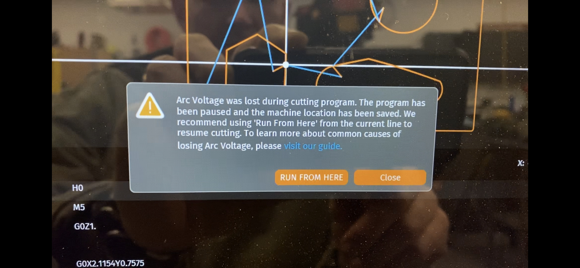

1st. The cutting stops at the end of each loop and gives me “the Arc Voltage was lost during cutting program” error message. I can resume but it stops and the error repeats after every loop.

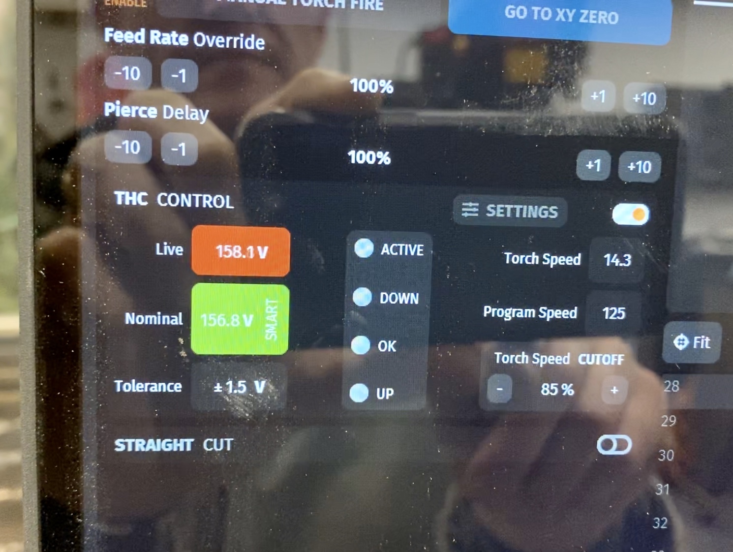

3rd. The first inside cut of the two files I’ve tried, are super slow, like 13 ipm when the cut speed is set to 125 ipm. The second, third, etc. cut at the programmed speed.

1st Issue: Hypertherm plasma cutters have a tendency to lose the arc at the end of the cut when using a lead out. We recommend either removing your lead-outs from your program entirely, making your lead-out speed faster (keep lead-in the same as cut speed), or just using smaller lead-out sizes.

3rd Issue: The first loop being slower than the rest is actually a bug in Fusion 360. Another user brought this to our attention over the weekend and we’ve re-written our Post Processor file for Fusion. We are going to test it more tomorrow and then issue this V1.4 release onto our website once approve. You are welcome to try this new Post Processor yourself by downloading here and it should fix your issue: http://assets.langmuirsystems.com/firecontrol/posts/FireControl-v1.4.cps

I did see that long lead-outs can cause problems and if you look in the background of the pic I posted of the error message you can see that I had eliminated the lead-out entirely. (although with the first test (F-bomb) I used a super short lead out of .06 with the same result)

I installed V1.4 and cut a new test piece. The first loop was even slower than v1.3-about 5 ipm. So I changed back to v1.3 and the first loop was still slow but back at 13 ipm. The remaining loops cut at the programmed speed.

We released a new version 1.4 (previous was unreleased) of the Fusion post that should resolve this issue. Please download it from our Downloads page.
It looks like toolpaths generated in later versions of Fusion contain a linear move at the start of a cut that moves to the location the previous rapid move (hope this makes sense) and as these are modal values (don’t print if they don’t change) it doesn’t display the line but did set the feedrate output modal such that the next time it was printed (the actual start of the lead-in or loop) it assumes that value was already printed and left it off.
The solution in V1.4 is to reset the modal after the first cutting g-code line is printed. As such, in the event Fusion doesn’t send the extra linear move, you may see an extra F### value on the second line of the first cut loop. These feedrate values should be identical and nothing will change because of it.
TL;DR: The new V1.4 post for Fusion should solve this issue.
We also reduced the secondary IHS sequence to 5 IPM (which should no longer be affecting the first cut as there will now be a feedrate) and will increase the accuracy of the IHS system.

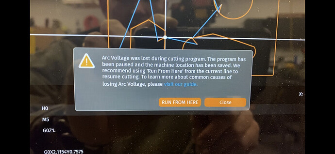

I’m having the same problems with ‘Arc Voltage was lost during cutting program’ after each loop and with THC turned off, the torch is moving before piercing after the first cut. I have the Powermax 45 and CPC as above, but I’m using SheetCam. I’ve reduced, speed up, and eliminated my Lead-outs to no avail. Is there an updated Post or a fix for SheetCam? Has anyone found a work around?
Sounds like you have two issues? First, if your torch is moving before piercing, then you need to increase the pierce delay by a suitable amount to ensure that the torch does not move before the pierce happens.
The second issue sounds like you’re getting an arc lost error at the end of the cut?
Also I see that you have the THC turned off? If that’s true then FireControl would not be monitoring at voltage and thus you would not get that error. You can certainly run with the THC off, but be sure to toggle it off on the FireControl screen.
Really just one issue. With the THC on, I can cut normally w/ the exception of the Arc lost error after each loop/cut. I can finish the cut but have to go through the restart at position for every cut. The pierce delay is accurate and normal for what I’ve used in the past. The arc lost error is at the end of each cut and the problem I’m looking to solve here. It’s almost the identical issues earlier in this thread.

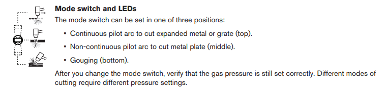

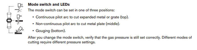

@wvredbeard You might want to try cutting in ‘Continious Pilot Arc’ mode on your Powermax 45. This can be changed by flipping the mode switch on the front of the machine to the top position (see below).

I’ll change the mode and see what happens. Thanks.
I did not edit anything.
Is it possible that’s the 300% leadout modification I made in sheetcam?
Old English D.dxf (21.9 KB)
I changed the mode on my plasma to continuous and ran the tap you sent back. I’m still having the exact same problem.

As for the arc voltage lost issue, we have fixed this by updating the THC firmware. We are going to sticky a post to the forum today that will provide a guide for how to flash your THC with the latest version of firmware which will fix the Arc Voltage Lost issue.
