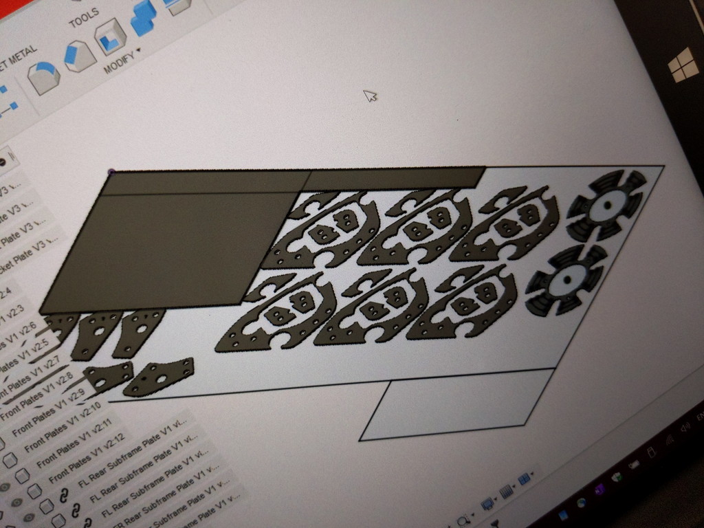

I loaded up a 4x3 sheet with more than a dozen parts to cut and nested as tightly as possible, and since my air compressor is only a 20 gallon running 4.1SCFM at 90 psi, I knew there was a chance I could begin to run low on air.
when the time came to pause the cut, I hit the pause button and the machine stopped instead. and by stop, I mean the machine immediately stopped cutting and just sat there. a pause feature should allow the machine to finish its current cut and then pause after lifting. that way when you resume it will just go to the next touch-off point and begin the next cut.

I almost lost a $30 piece of steel because of the confusing and inconsistent naming of the pause button. no other machine I’ve ever used (I work as a Quality Engineer in the Auto industry), has ever stopped in the middle of a cut, just because you hit the pause button. luckily, I was able to use Fusion to draw a new cut path and have the machine go back and recut that one specific failure.
if anybody has a workaround for this pause feature, essentially letting me press pause and then the machine will finish the cut and then pause, I would love to know the workaround, because I can’t cut a full sheet without running out of air. what I ended up doing to make it through the rest of the day, was to smack the pause button when the machine was in between cuts, to stop it before it starts the next cut. although this is very hectic and requires a lot of attention, so I can’t keep doing this everyday.
