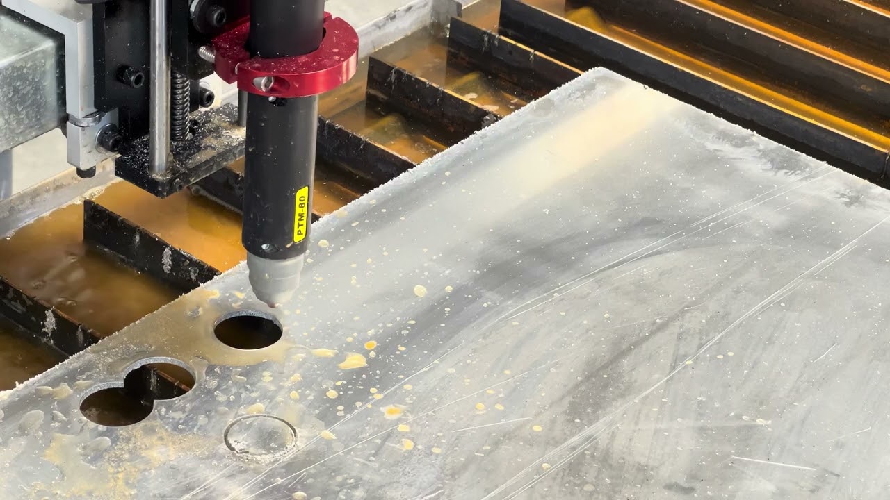

Hi all,

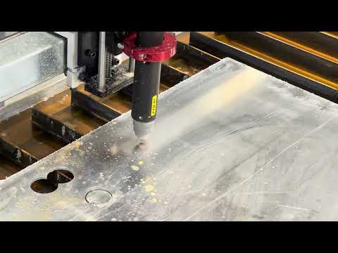

I’m getting a strange issue where the torch will follow the program perfectly while the Dry Run feature is toggled on, when I toggle it off to actually cut the part it no longer follows the program correctly. While it is cutting it will overlap the two circles instead of having them spaced like in the picture below. In Fusion 360 when I click simulate, it follows the cut path perfectly as well. Even the X,Y coordinates in the G-Code seem to be correct for the two circles, yet the Crossfire will overlap them when cut. Any ideas how to fix this issue?
Here is a video of the dry run.
Here is the video of the incorrect cut.
Very interesting…one difference between Dry run and regular run is IHS. I’m wondering if you remove IHS & THC from gcode and just manually set the height it works. This is always great troubleshooting step to understand if one of these might be the issue.
I was confused by a few settings but guessing your showing on thin aluminum but plan on cutting thicker pieces once it works.
Another thing to consider is 60deg lead in/outs and to slow down just a little less than your straight line cut speed. Using 90deg is OK if needed for something small or really tight area but ideally you want less angle to keep torch moving and not such a hard turn.

If the dry run works flawlessly, it is not likely a FireControl issue. FireControl is interpretting the gcode accurately during the dry run. Adding the torch/z-axis movement would not make FireControl lose track of where it was on the table.
Think back on any changes you may have made recently. I am assuming it was working correctly.
Unfortunately, I think you have some electrical interference issues again.
I tried DonP’s suggestion and did a test with both IHS and THC turned off, manually set the height and to my surprise I got the correct cut.
I moved the torch in the holder to get more Z axis travel because it does almost sound like it is binding in the video and now have over 2"s of available travel. Tried cutting the part again with THC and IHS enabled and it went back to an incorrect cut. It still makes a slightly weird noise when transitioning between circles even though it now has plenty of Z axis travel. I know I’m not having binding issues because I can jog the table around at any speed in any direction without issue as well as the dry run with no binding issues.
Next I tried leaving IHS on but THC off and it also made the incorrect cut. Now I’m not sure if I have a setting incorrect in CAM or if there is something wrong with my hardware. I’m pretty novice still to all this.

Hopefully the problem is solved. I was able to cut my test piece twice with both IHS and THC enabled and got the correct cut. I cleaned the Z axis screw, rails and then took a Q-tip and cleaned the lifter switch contact and brass screw contact for the IHS and they were both dirty.
I’m going to move the plasma cutter as far from the enclosure as I can get it tomorrow as well. Hopefully all these issues are behind me.
