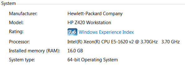

What computer are you running?

  • I am running an HP z420 workstation tower with Windows 7 on it. image It was a drafting setup at my work (we run Creo) that was ready for its 2-year replacement so it was set up with pretty decent hardware.
