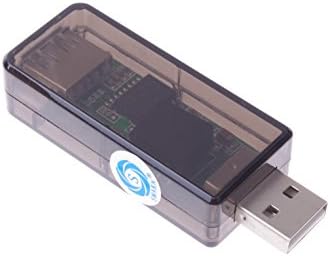

I could see rubber wheels insulating the table from grounding through the concrete. Not a great ground, but a ground nonetheless. I ground everything - table, plasma cutter frame, air lines… I sometimes forget that not everyone thinks about proper earth grounds for equipment. That should probably be the first troubleshooting question for… just about anything from cut quality to control gremlins to arc voltage loss during a cut. Table, plasma cutter frame, and air lines should all be grounded to a solid earth ground. Air lines generate a lot of static electricity during high volume use.
Put one of these on your usb cable
I have also noticed that coiling the leads for the cutter (either of them) can be a bad thing too. Giant inductor…
