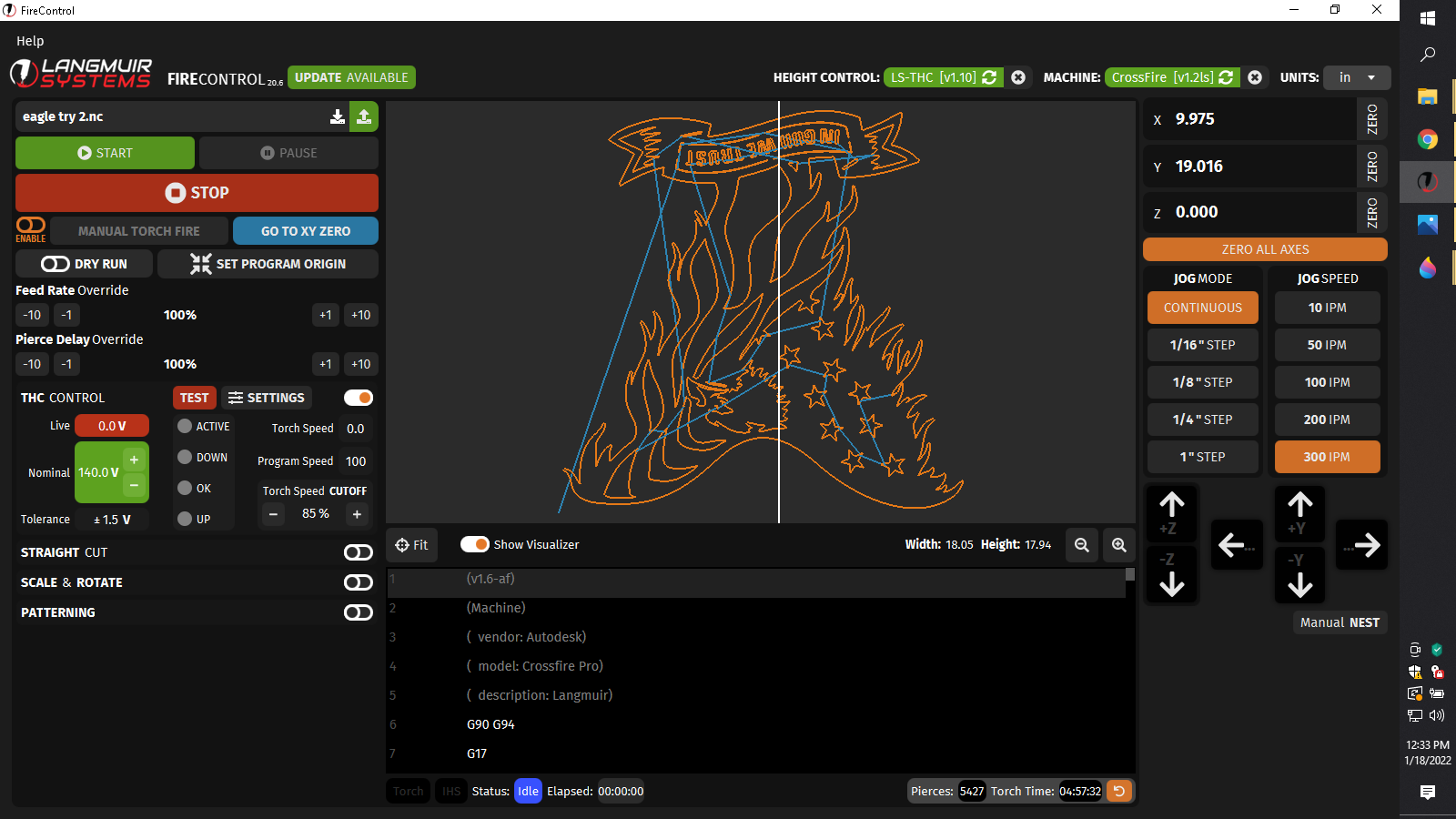

Figured out the IHS issue, but now I get this:
Is wire at the back of a motor plugged in good

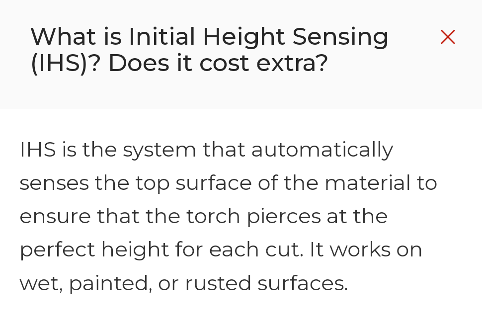

when its green the means the ihs switch is in the closed position
Greyed out means the switch is in the open position
When the torch moves down and the hits the metal it closes this switch
I H S Inital Height Sense
Pierce delay needs to be longer?
I dont know
Increase on left side by 20 to 30 and try again
This error could also occur if your plasma cutter is turned off or in a fault state as well
If you try to manually fire it in fire control does your torch fire?
sorry not sure about what your asking
sorry damn thing was off I could have sworn it was on.
If your torch will fire manually. You can override Pierce delay it is right above the thc section
That was a easy fix

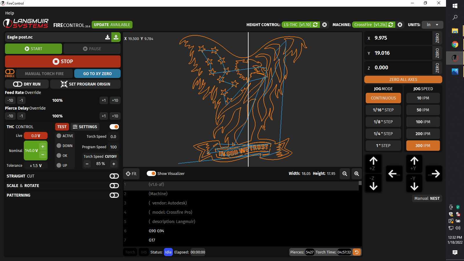

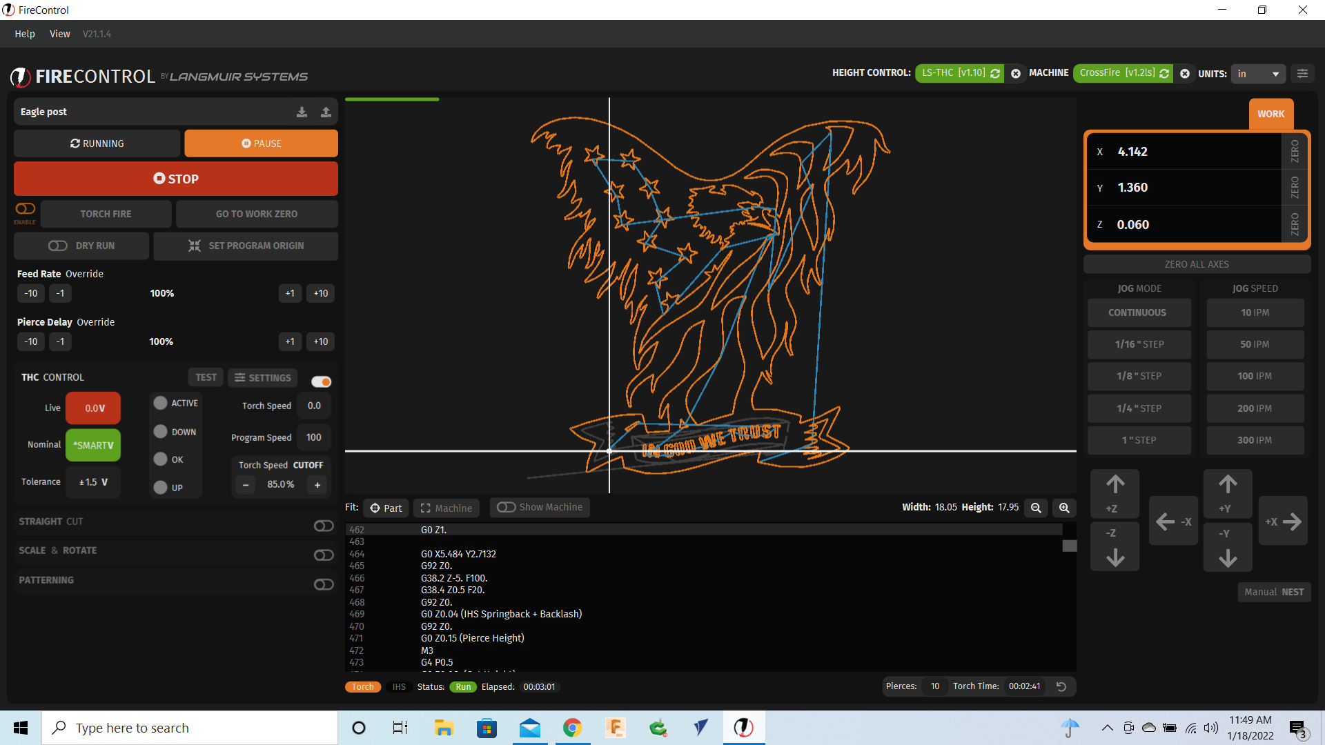

started cutting and after about 3 minutes, it just stoped.
No errors?
What kind of plasma cutter are you using?
Air was keeping up fine?
Looks like it failed on a pierce.
air is good and dry, no errors im using the Razorcut 45A
Did it bring up the option to start from that line of code . “start from loop?”
no, restarted it and it did it again, but in a different spot. Maybe my air.
